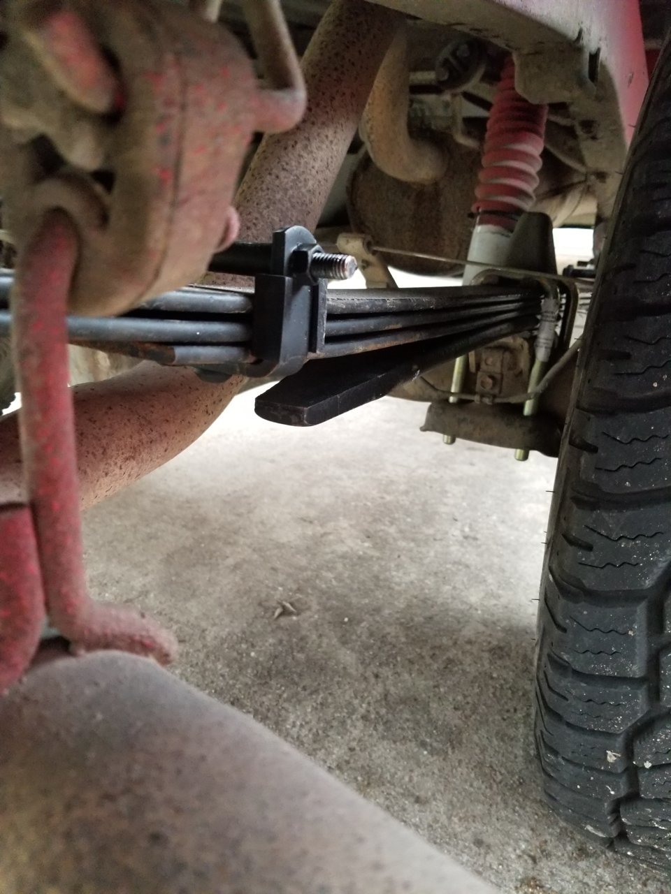

    I just replaced my leaf springs last weekend. I used the RockAuto's Husky springs part# 90173. I'll get a picture tonight and post the finished installation.

    No more sag.

    Nice, it looks like new hardware, come with or were they ordered separately?

    The springs did include the bushings is all. The rest I had to purchase separately.

    That leaf still looks really flat.
    OP, I have oem style leafs with a wheelers AAL. It’s a bit stiffer but holds weight well.
