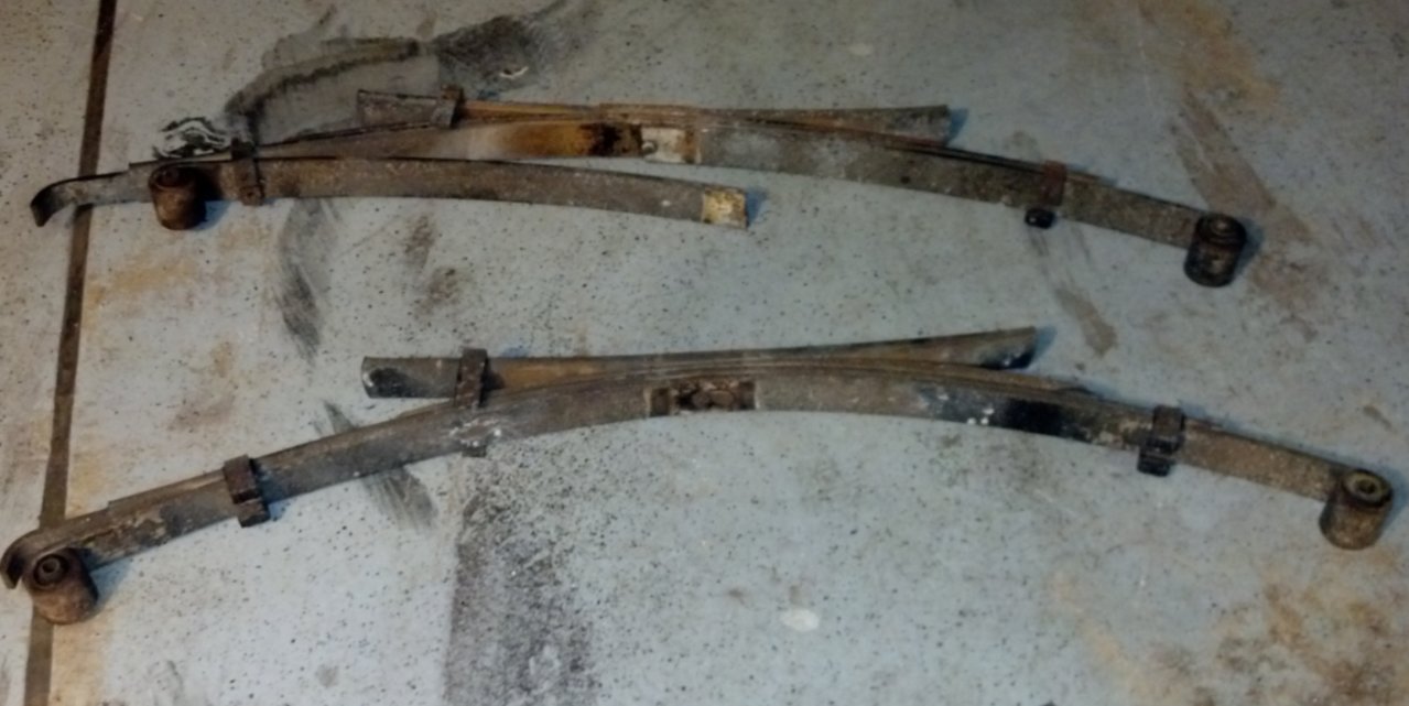

    I did the dance with AAL and would never do it again.... I only occasionally hauled a dirt bike or towed a boat before I broke an AAL and then this eventually happened (broken main leaf). Went with Dakar CS047 and never looked back....
