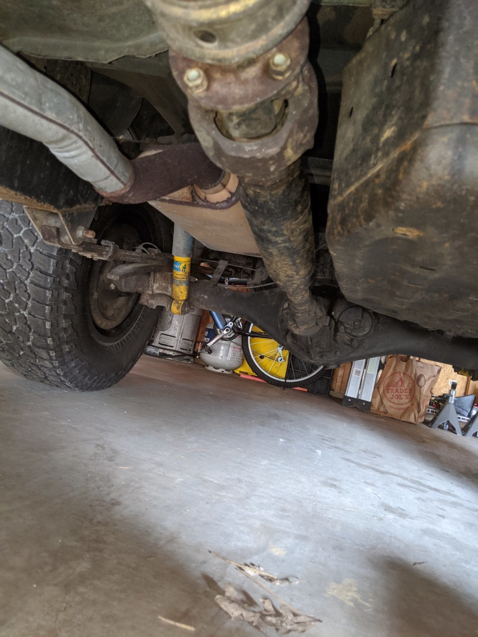

    So my experience with General Springs is limited to having installed them and that's it.
    The member that's got them on though is really happy with them as he didn't want a lift either but needed to replace his sagging suspension.
    Here's his truck -
    Easy job; don't pay someone to do it.
    jbrandt likes this.
