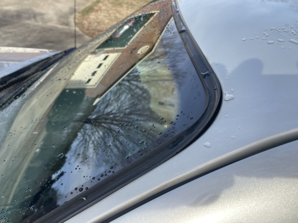

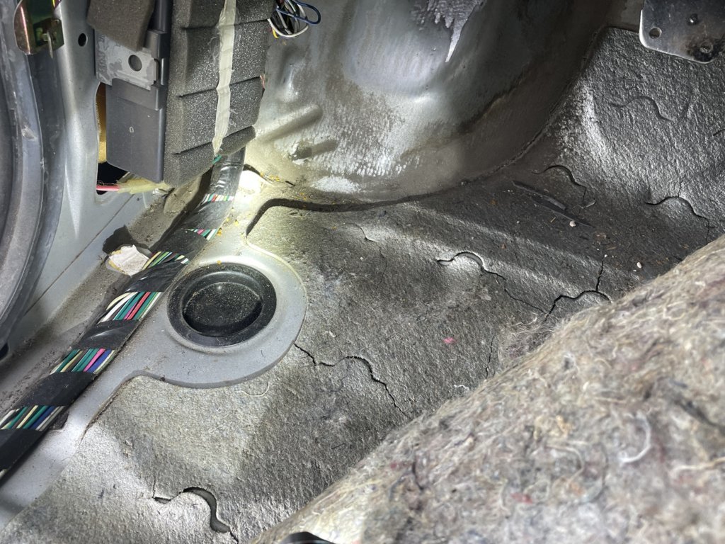

    Today I removed the kick panel and pulled back the carpet. I flooded the windshield and cowl with water and spotted no leaking down the firewall. Then I ran water on the windshield seal where it's lifting up some, at the top corner where it transitions from horizontal to vertical. Now I have some water running down the black wrapped wires on the LH side, where the flashlight is spotting.
    It seems I need to have the windshield removed and replaced with a new seal. I may temporarily pack it with strip calk to control the leak until I can complete the repair.

  16. Feb 24, 2025 at 7:39 AM
    #16
    noodles93
    noodles93 Well-Known Member
    Dec 9, 2021
    #384203
    627
    Charleston, SC
    1999 Tacoma Prerunner 2.7
    Good find! Of all possible leaks the windshield is probably the best one. Took the glass guys like 30min to replace mine… $150
  17. Feb 24, 2025 at 9:11 AM
    #17
    slater
    slater Well-Known Member
    Apr 16, 2024
    #448066
    2,799
    San Diego
    24 white Tacoma TRD Sport 2wd
    the outer weather strip is pretty much just a dust seal....
    The entire backside of glass is siliconed down to the A pillar frame perimeter of the truck...

  18. Feb 24, 2025 at 1:38 PM
    #18
    TACO in SC
    TACO in SC TuRD
    Sep 18, 2012
    #87221
    273
    Andrew
    Greenwood, SC
    '03 Tacoma Ex Cab 4x4 V6 5-Speed
    Pretty well stock
    Wednesday morning I'm taking the truck to a local glass replacement company to get a quote to seal this up. I suspect the windshield will have to come out and they won't guarantee they won't break the glass. So, I might end up with a new windshield glass.
    If it's just a dust shield, then the windshield install is compromised elsewhere. I'll let you all know how it pans out.
  19. Feb 24, 2025 at 2:40 PM
    #19
    slater
    Apr 16, 2024
    #448066
    2,799
    San Diego
    youre not understanding what im saying...
    The outer lip is just a dust shield...
    Yes, you adding silicone may have kept some water out, but thats not the waterproof seal...
    The glass is glued / sealed / siliconed to the actual metal frame that it sits on, thats what keeps the water out...
    It rare that the glass will break, but they cover their asses by disclosing so theres no surprises & they're not on the hook for buying you new glass.
  20. Feb 24, 2025 at 4:09 PM
    #20
    TACO in SC
    TACO in SC TuRD
    Sep 18, 2012
    #87221
    273
    Andrew
    Greenwood, SC
    Pretty well stock
    I understand what you are saying, thank you. It does seem the glass needs to come out to be resealed.
