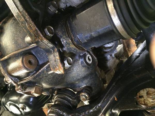

    So when I was changing my oil, I noticed one of the CV boots on the passenger side was torn. Then I saw on the driver side gear oil has been leaking out, where the CV axle goes into the differential on the drivers side.

    here's a pic of the oil leak

    If you've got the money to do it all the. Go ahead can't hurt anything, as for the leak I don't know about 2nd gens but on 1st gens there's a seal inside that's supposed to get replaced every time you remove the cv axle also it doesn't look seated all the way against the diff
