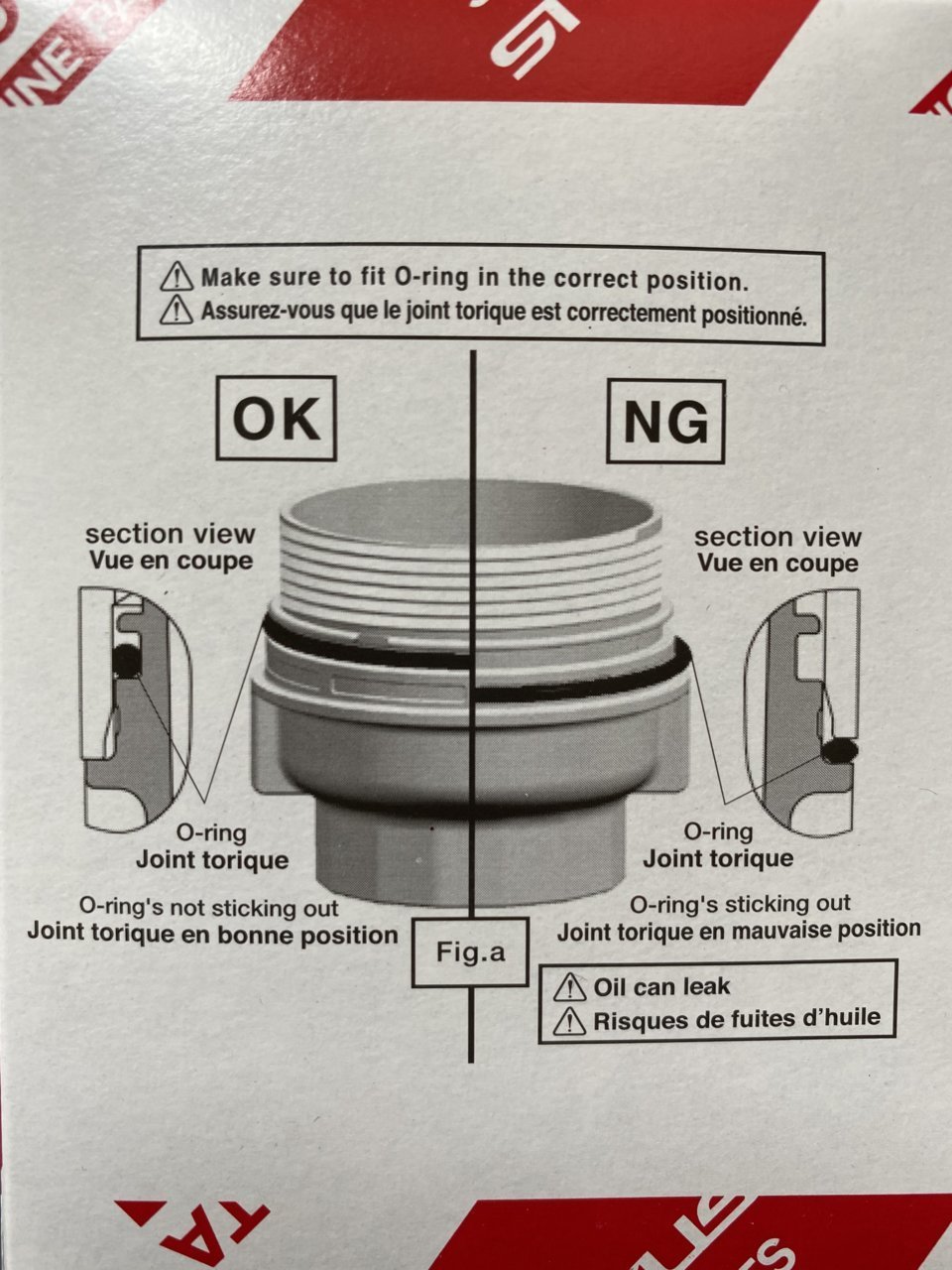

    Wow this is a first. I had a catastrophic failure of the oil filter cover. Went out to go out. Backed out of my drive and headed up road. Got to top of hill and heard knocking from the engine of my new 2023 Tacoma with 15,000 miles. Looked in rear view to see a trail of a liquid behind me. Turned back around. Knocking stopped for a minute. Headed back towards my house and low oil pressure came on. Horrible knocking. Shut engine off and coasted down the hill to home. Looked in the garage and trail of oil on floor out of garage and down drive from where I backed up. Got the truck up on stands and removed front skid plate. Poured some oil in the engine. It appears to be leaking around the oil filter housing. Possible from under the end cap. I was actually headed to dealer tomorrow for 15,000 service and an oil change. Now it will be going on a flatbed to the dealer. Looks like maybe it’s been leaking slowly and then failed today. Be interesting to see what they say. I’m very worried about engine damage. This is a brand new truck and my only vehicle. This should not have happened. I’m just glad I was close to home.

    I’m assuming the dealer does all your oil changes? Unfortunately, a common theme here is dealer screwery on oil changes and the owners having to deal with it as a result. One guy they forgot to tighten either the oil filter housing or the drain plug and he pissed out a bunch of oil and had knocking. The dealer “fixed” that by tightening whatever it was and they sent it on down the road full of oil, not owning up to their mistake at all and replacing the engine which is what they should have done. That guy fought them for a long time and eventually they gave him a “deal” on a trade in, still not fixing the problem and thus transferring the problem to some poor unsuspecting other person who now has a questionable engine.
    If they did the oil change, I’d press them hard for a new engine. Knocking from lack of oil has already caused irreparable damage. Also if they did the oil change, this is a great reason to do the future oil changes yourself.

    $10,000 says the "entry level technician" the dealer hired to do oil changes, wash cars and empty trash for $12/hr didn't install the O-ring in the correct groove on the housing.
    If you do not insist on witnessing the housing removal to inspect this...they are going to lie to you about the causation.
    Guaranfuckingteed.

    Definitely watch the Tech remove the filter housing and make sure the O-ring is in the correct groove.
