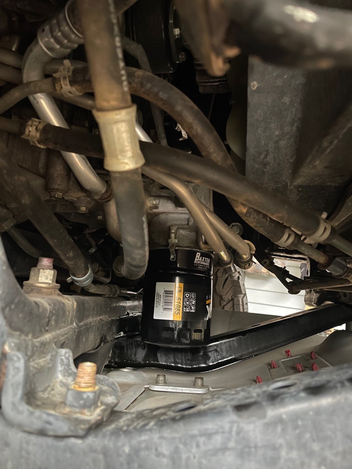

    This is why I'm considering a baxter setup.

    Adding further complexity to the oil system, and having it hang even lower on the vehicle? The solution for mishandling the filter housing is to install it correctly.

    Baxter's basic kit just replaces the cartridge housing with a spin on filter housing. It hangs down a little further than OEM but is still above the crossmember and well above the skid plate. You'd have to absolutely destroy the skid to affect the spin on filter.

    That's pretty slick. Know how much further it hangs down? Also which oil filter(s) work with it? Curious to measure this out to see if it would fit under my RCI Skid.

    I believe it's about an inch further down than OEM + filter length. I don't recall where I got the info but that Wix 51085 has been working fine for me. There could possibly be a shorter filter that would also work but I haven't really looked around for one since this setup seems fine to me.

    Don't want to make this a "Baxter" topic - there are enough of those, but you are definitely incorrect on it adding complexity to the system. On the contrary - it really couldn't be simpler. No O-ring (oh wait 2 of them) no sticking the "pre-drainer" thingy in, no weird wrench, no fucking up which groove the O-ring goes in, no deciding do I need the aluminum housing or not. Just kidding - the OEM system is fine and anyone with even the slightest bit of mechanical aptitude should have no problem with it with a little attention to detail BUT I do love my Baxter!
