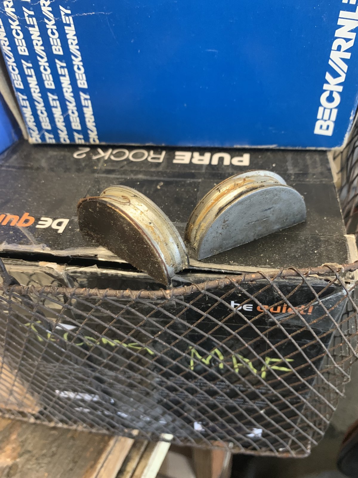

    1996 Taco 2.4L 2wd Automatic
    Clock Volt meter/LSPV Delete/Hyundai 16’s/FP gauge/after 9months of wrenching ZERO oil leaks
    Hey OS
    Since I got u
    What is your opinion as far as half moons
    I replaced mine while back….but the were aluminum….I installed the rubber ones bc they came with kit/and I was a newbie
    rubber or metal half moons?
    Prefrence?
    Downfalls?

    Yeah saved them
