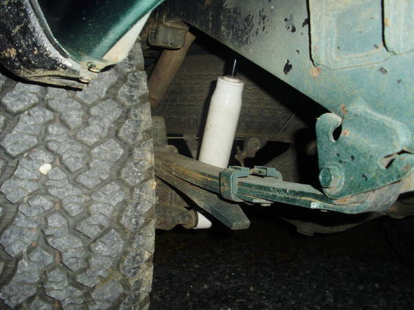

    So my leaf springs are starting to take on a negative arch, right now, they are pretty much flat. I assume this is from installing my longer shackles in the rear, and probably from being on my truck for 150,000 miles. I am just wandering if I throw a aal in the will it correct the negative leafs, or do I have to replace the whole pack with some new ones. And if i replace the pack will it just negative arch again because of my longer shackles. Here is a pic of my leaves:

    With 150,000 miles, you may be better off getting new leaf packs.

    I stuck a set of AAL's(Skyjacker) in mine, replaced my bottom leafs(not the overloads, the ones right above it with the clips attached) and my leafs have a nice curve to them, even after 4 months of settling, they are still great. they just squeak a bit....

    mine were flat when i installed my AAL and it pretty effectively rearched them...at least for the time being

    Same here, re-arched them 100% with the Skyjackers. And after 4-5 months, they are still arched after settling. Still 2" higher than before with my flat leafs.

    Mine were past flat...than i broke a leaf on the driver side by repeatedly hauling mulch and compost. The whole bed started sagging compared to the lift in the front,
    So I upgraded to OME. I would recommend you get new packs (Skyjacker, OME, stock, whatever) if you plan on hauling anything with any mass at all.
