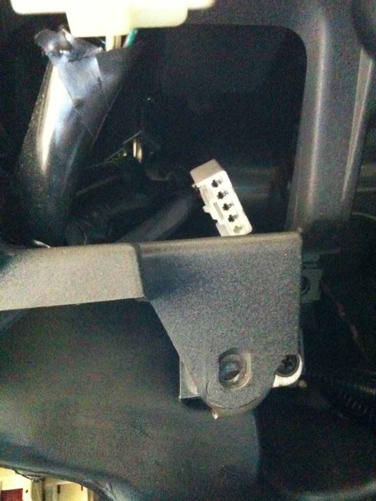

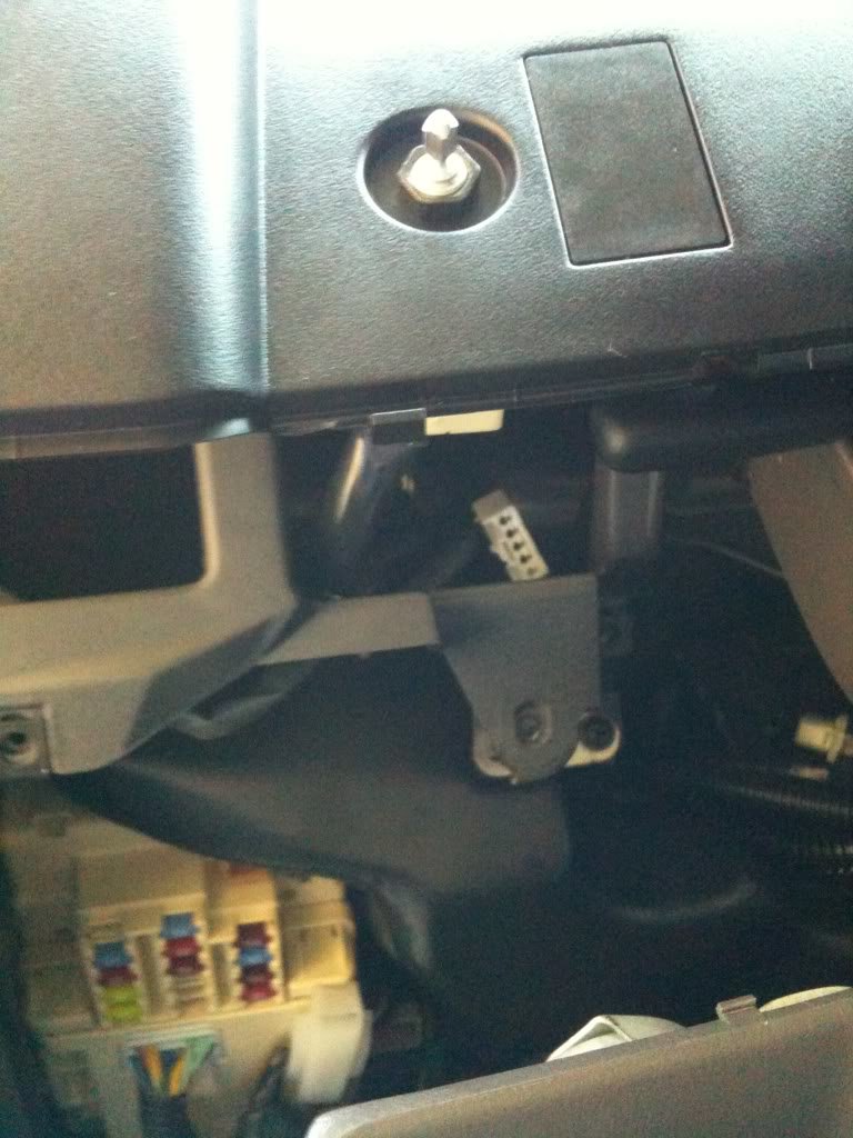

    Doing my Mod at the moment can someone answer a couple of questions?
    First off: does any one recognize this plug in? I dont remember un pluging it. And it doesnt seem to reach any thing.

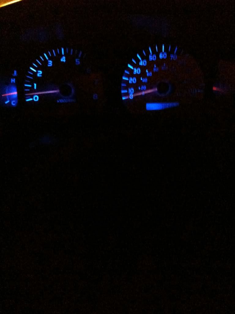

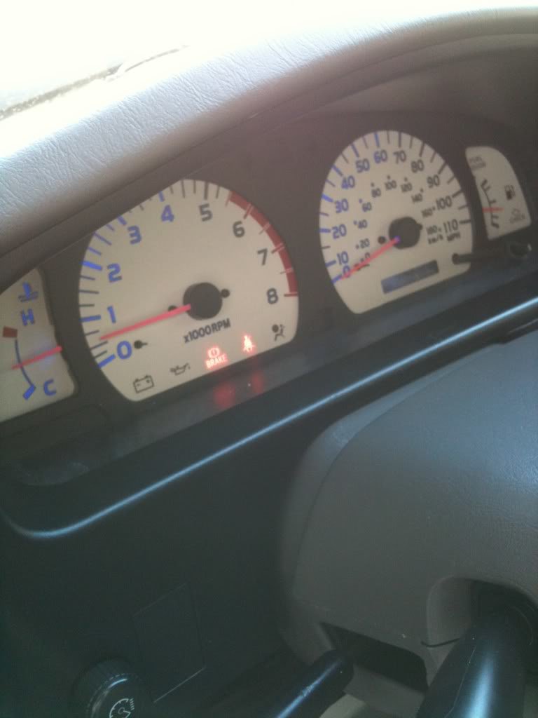

    Second: Before i put everything back together.... I notice that only parts of the dash are lit (see Picture) is this how it's suppose to look?
    It's day time so i am wondering if it will brighten up at night..
    Does any one have pics of there dash at day?

    Hey the reason why only half the dash is lighting up is because the bulbs are polarity specific. Take the ones that appear to be out and just flip them around and they should come on. And I have no clue on that plug?? I do not remember any plug like that.
