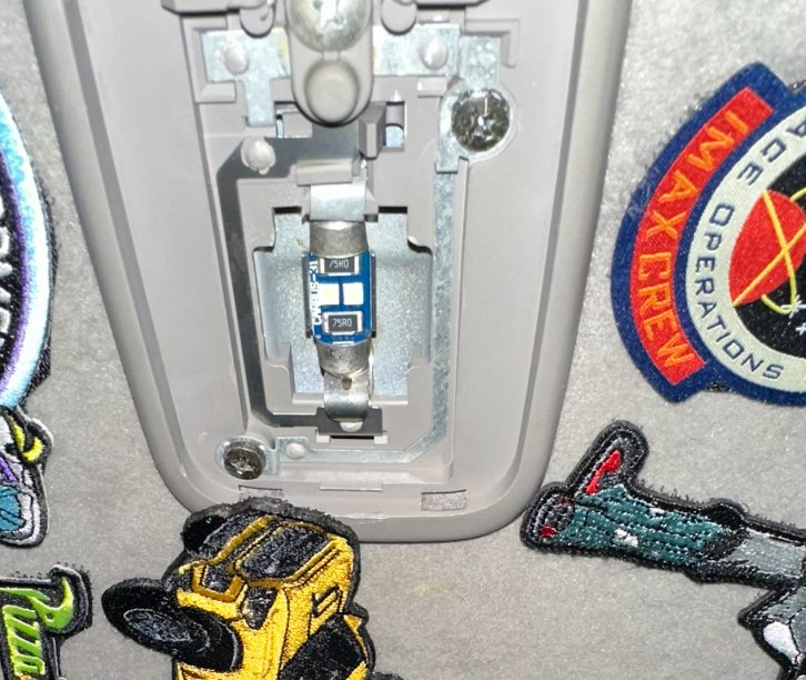

    I'm about to get another much higher resistance resistor to put in parallel to bring the overall resistance down just a tad bit and see if it makes it more consistent. It might be the heat itself as well.
    If its the resistance then its probably that resistors can have a +/- deviation, maybe this one is 5% or something and its just far enough more resistive as to be an issue. I can probably put some tiny 1+ megaohm resistor in parallel to eat up that +5-10% and it can be a 1/4 watt or so because it will have very little current through it.
    Edit, little online parallel circuit calculator has me thinking maybe 1-5K ohm to get into the deep 10% too much resistance with the provided 100ohm.

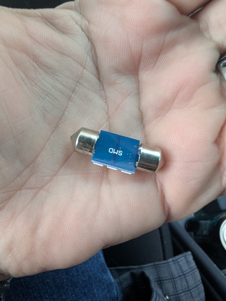

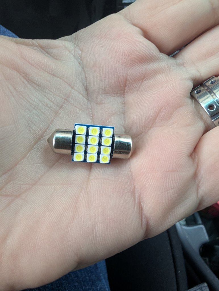

    They exist, it's what I use, I can pull one out a bit later to confirm what it is exactly. But got it from Superbrightled.
    GTGallop[QUOTED] likes this.
  16. Mar 11, 2025 at 4:11 PM
    #56
    MadNachos
    MadNachos Well-Known Member
    Oct 4, 2021
    #378832
    1,097
    2000 Tacoma 4WD Base - no low gas warning light but it has AC!
  17. Mar 11, 2025 at 4:12 PM
    #57
    MadNachos
    Oct 4, 2021
    #378832
    1,097
    These are the ones I have
  18. Mar 11, 2025 at 4:13 PM
    #58
    MadNachos
    Oct 4, 2021
    #378832
    1,097
    Back side:
  19. Mar 11, 2025 at 8:40 PM
    #59
    glwood6
    glwood6 Well-Known Member
    Jul 25, 2008
    #8125
    2,476
    Gary
    Albuquerque, NM
    03 XCab Prerunner
    Bilstein 4600 shocks.
    I believe I have a set of those in my 2019 4Runner, and they have worked flawlessly for years. I have the one from superbrightled arriving Friday, so we'll see.
