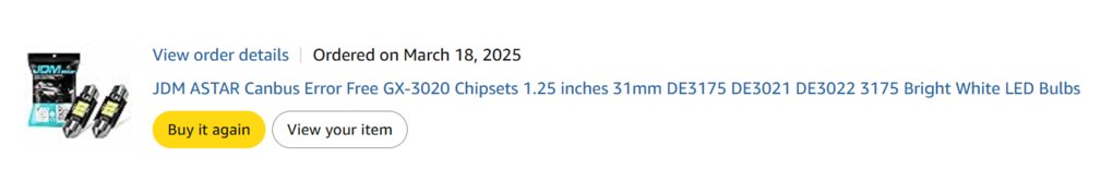

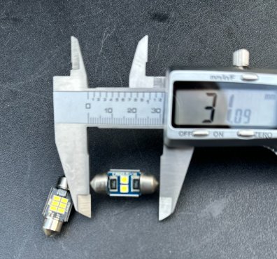

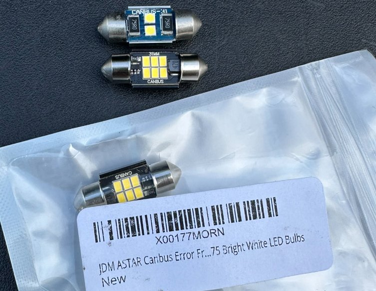

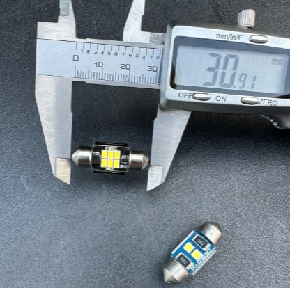

    I ordered these the other day and finally got around to trying them out. They have indeed changed the design a bit from my original post but they did work for me. It must be a 2002 thing. Really sorry they didn't work for you and I wish I knew exactly why. No issues in either the dome light or the map lights.
    EDIT: one final add, yes they definitely are a PITA to install. I ended up tweaking/bending the contacts inside of the dome light housing just slightly to make it easier to fit into place.
