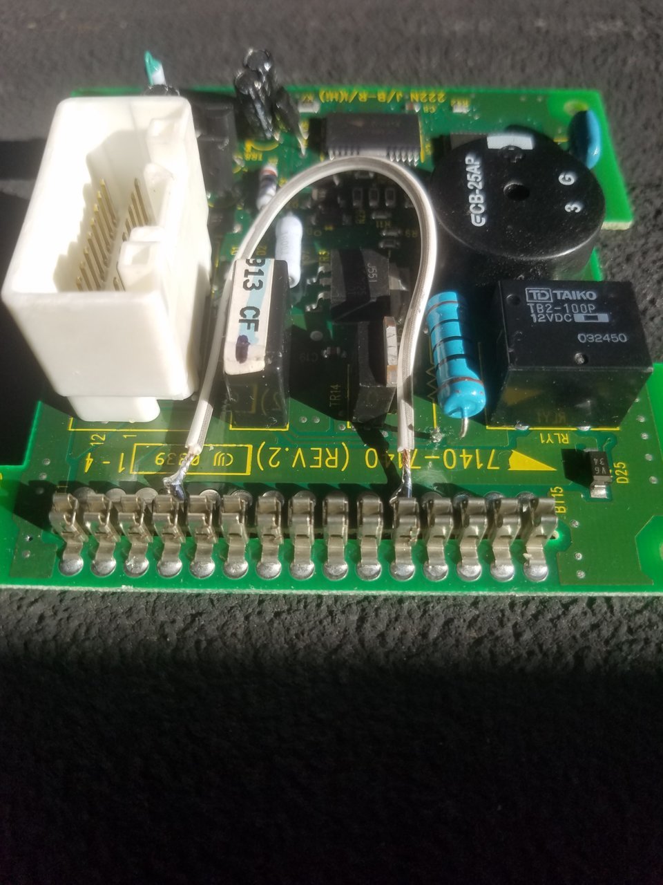

    I just bypassed that stupid ECU/intergration relay.

    Did you just jumper the door switch negative to the dome light to bypass the BCM? Or how did you achieve this?

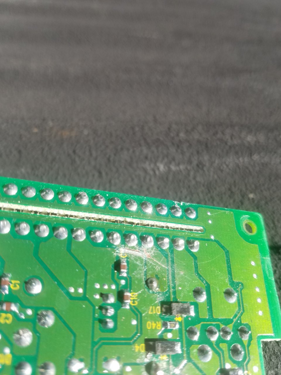

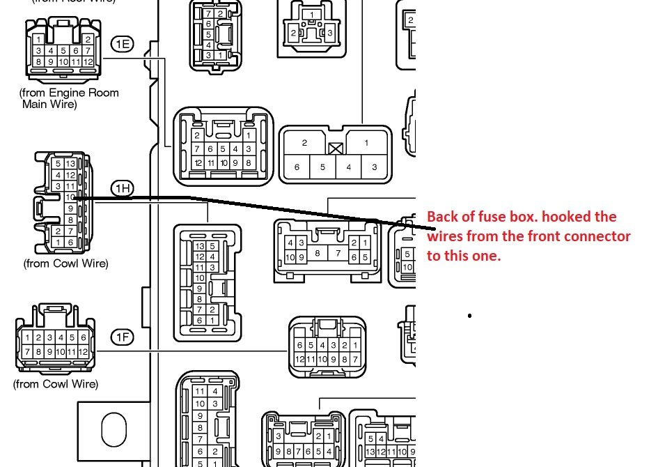

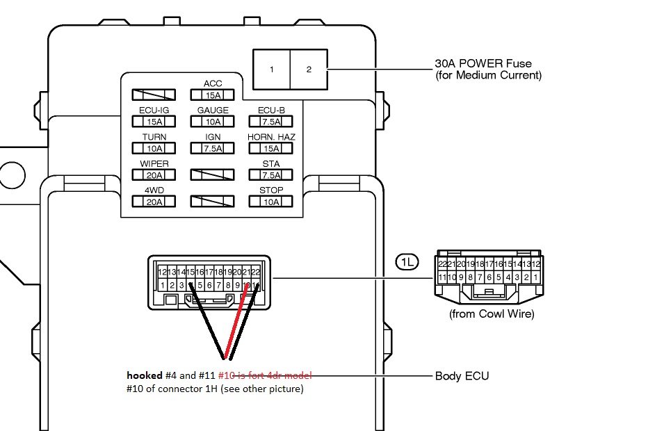

    Opened up the integration relay and solder a jumper wire across #4 and #12 see pic then cut trace underneath and resistor leg. Dome light bypass1.jpg Dome light bypass.jpg

    I didn't cut the wires from the front connector. Just tied into them. I still wanted my door buzzer to work.

    Thanks for the picture. I was always wondering what is inside that white box.

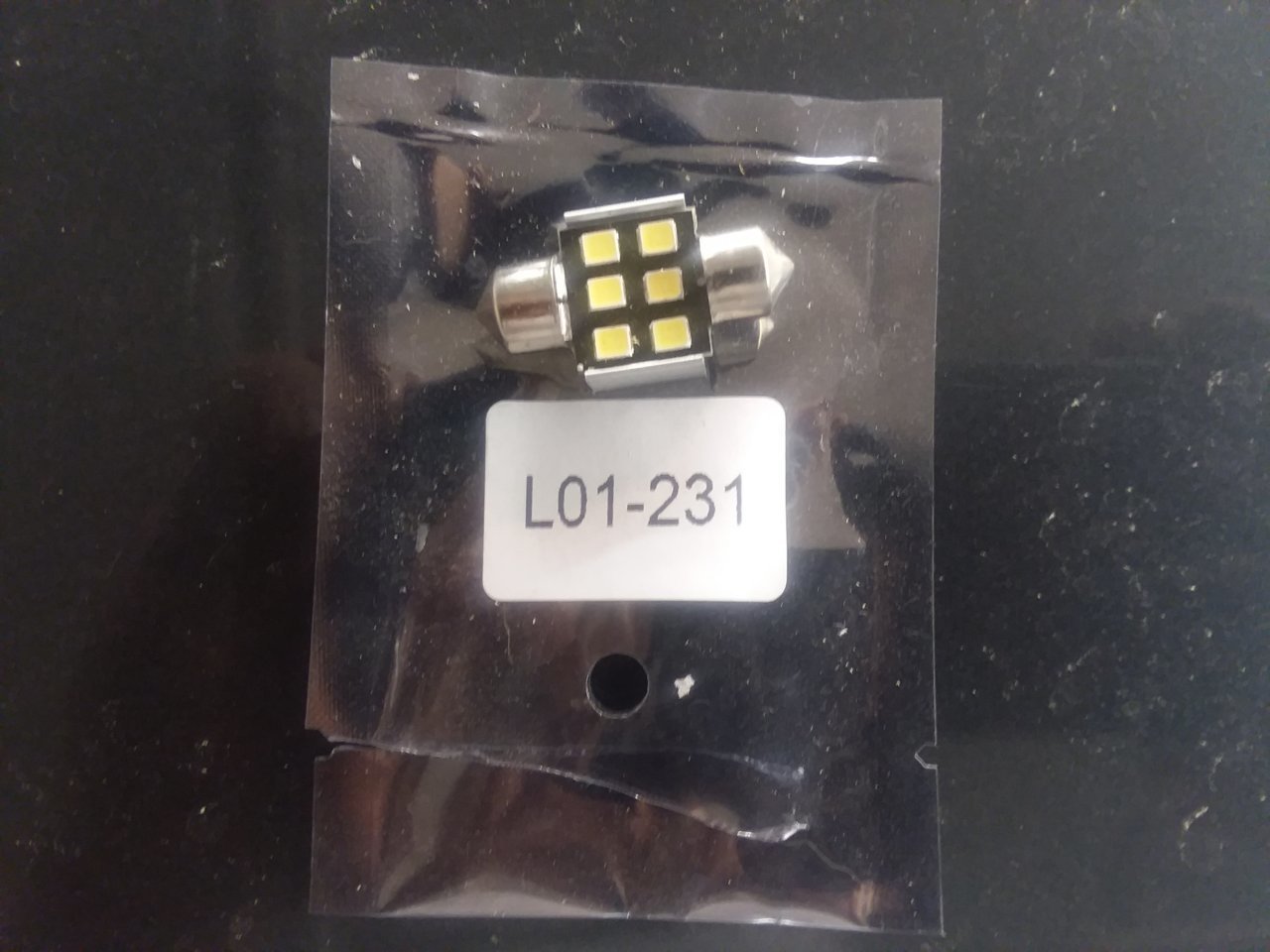

    I went the bulb replacement route on my 99 over the whole light replacement.
    Tried the Sylvania bulb from AZ and was unimpressed with little to no added light over factory mini bulb performance.
    Found superbtightleds.com purchased 6 led bulb as well as other bulbs.
    Super easy installation and the brightness is amazing over factory !20180622_082539.jpg 20180622_082607.jpg

    That part number on the bulb packet didn't come up. I did see this website before and was skeptical of the price/value, good to hear they're working.
    Think ours is the #3175, so what about these two:
    https://www.superbrightleds.com/mor...175-led-bulb-4-led-festoon-30mm-car/231/1083/
    https://www.superbrightleds.com/moreinfo/festoon/de3175-led-bulb-4-smd-led-festoon-30mm-car/2107/
    Didn't see the 6 bulb LED. I'll probably just order both and see which works better since they're so cheap.
