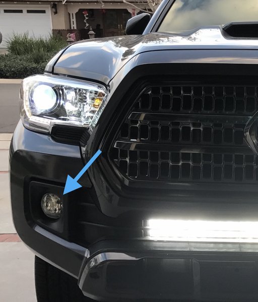

    2017 DCSB TRD Sport. TRD Pro Grille. Morimoto Elite 35W HID Headlights. Morimoto XB LED Fog Lights. Clazzio All Black Leather Seat Covers. 32" LED Light Bar Bumper Stealth Mount. BHLM. Raptor Light Kit. Leer 100R. Bilstein 6112/5100 set at 3rd notch. LT275/70-17 C-Load Hercules Terra Trac AT2. Bora .750" Wheel Spacers.
    Were you able to take the black plastic cover that goes on the outside of the fogs off in order to install them that way? I attached a pic to show what part I mean, it's the blue arrow on the pic. Is there a way to take those black plastic covers off and swap out the fogs that way? Or is the only way from changing them is behind? I will be installing mine this weekend

    I did option B with a step stool. Easy peasy

    Much easier from behind. Pop the hood and reach down from behind the grill and headlights. plenty of room and an easy install.

    I have short arms and after trying A & B , But found that by far, the easiest was option C. Removing the grill and rad feflectors only takes a minute, it is so simple.

    Thanks everyone. I did option C mentioned above and it was SUPER easy. Had the fogs switched out in 15 min. Took another 5min to adjust them and line them up. Really easy to swap them out and they look great. The color of the Morimoto fogs match the DRLs perfectly.
