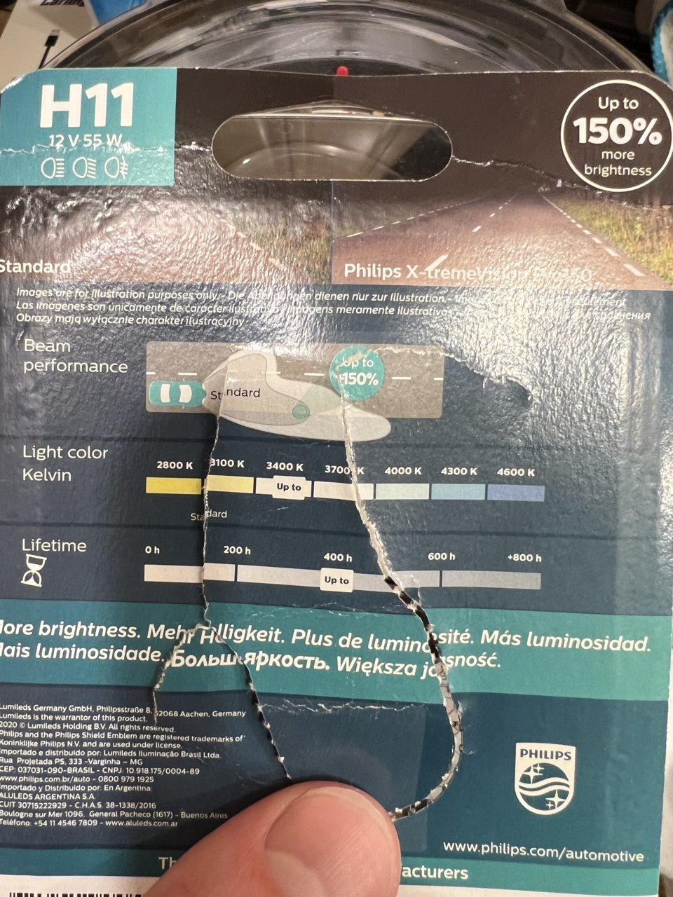

    The Philips GT Racingvision +200 H11 is rated for 400hrs, compared to the 250 of most of the other performance H11's. Crash'a testing showed it performed similar to the older Philips +150 H11. Both Philips and Osram made some adjustments to how they measure their performance bulbs a while back.
    IIRC the H9 beats it handily. And at $10/bulb, a set of those is cheap enough to replace once a year before they burn out, compared to $35+ a pair for performance H11's.

    Note the Philips Pro +200s are H4, the highest the Pros go in H11 is +150. I’d have to double check the life on those bulbs.

    Philips H11 Pro +150 are 400 hours as well, or about 2 years.

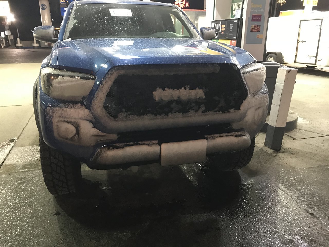

    I was going to experiment with LEDs but then I saw a new Tacoma at a local gas station trying to scrape snow and ice from around his headlights. LEDs won’t heat up and melt slushy headlights. Not worth trouble to me living in the North. I ended up buying some better and brighter replacements from NAPA for low beams.

    Correct, LEDs will not clear snow.
    Edit: See comparison temps in post #2195 here.
