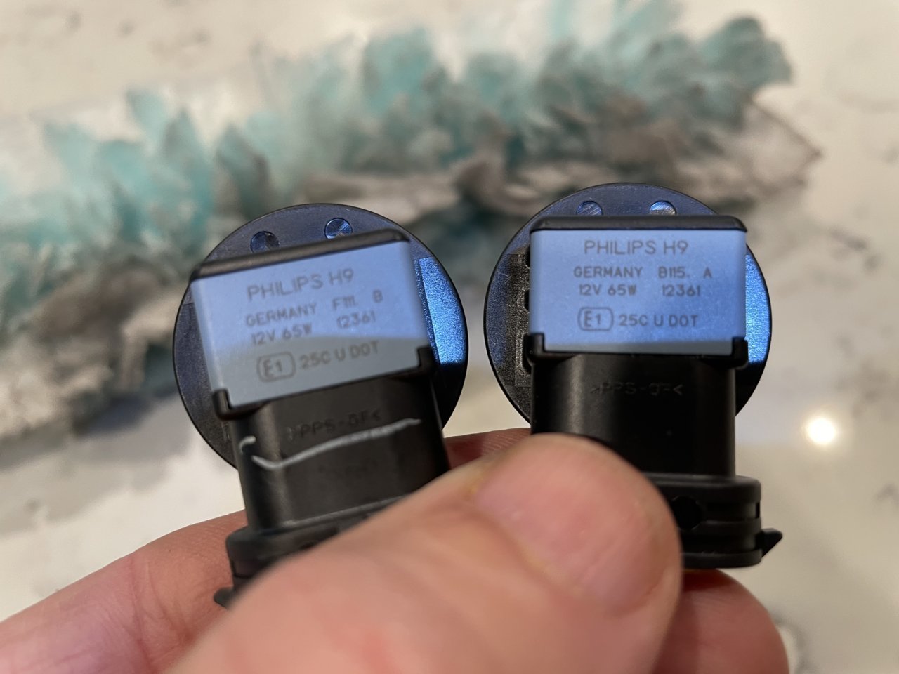

    30
    I ended up buying the stock LED from eBay instead of screwing around with new housings/bulbs.
    but I went to change out my high beams and to my surprise, it already has Phillips H9’s in there! Maybe I missed it on this thread somewhere but do the newer trucks now come with the good H9’s? Says they were made in Germany, just like the H9’s I bought on Amazon.

    2017 White SR5 DCSB V6 4x4
    High beams are H9 on all models.

    ghoticov
    ghoticov Active Member
    Mar 14, 2014
    #125308
    30
    I am so confused. I read many post on how the Philips H9 was great for thr high beam, I didn’t realize that was actually what came stock in the trucks. Lol

    Issy, WA
    H9 are popular and cheap mod for low beam projectors. This maybe caused some confusion.
