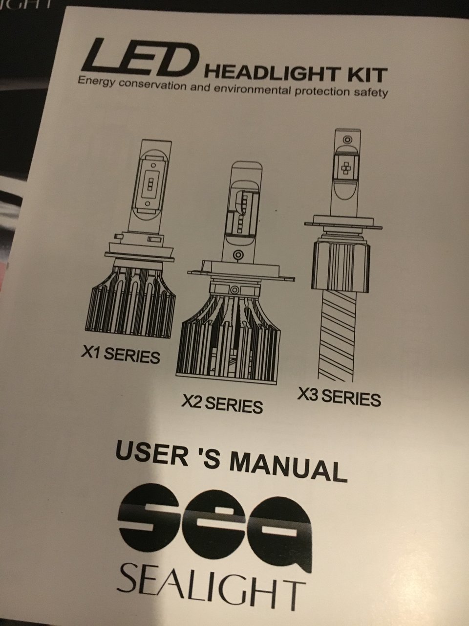

    Installed these but cant re-use the rubber moisture barrier cap because of the size. Anyone convert to LED and not re-use them? The lights are brighter
    I’m concerned about moisture but the new bulbs are waterproof
    H4, X1 series

    You can run LED's...I did for 2 years. No issues. I loved them, adjusted the beams for my truck. Super bright, and gave me a wide field of view. NEVER had anyone flashing me... Don't get wrapped up in the TW "You can't be in the club if you don't do what I say"

    Crashnburn, Headlight revolution did a led headlight video with a Tundra and it had stock halogen reflectors and it worked really well. But they did show how crap the leds would look if installed in the wrong orientation.
    Is it possible that the newer Led kits are designed better to work with the stock reflector housings?

    There are extreme varying levels of quality in LED kits. The style the OP has selected is about the worst and results will nearly exactly match the thread I linked above.
    Those more expensive kits that try to do a better job by adding low beam glare guards which will do better in reducing glare. However you are still attempting to use a reflector that is designed for an omnidirectional orb of light, and on low beam designed for the light to illuminate the top of the reflector directly above the bulb (opposite of the glare guard) and the LEDs put out directional light to the sides of the reflector, poorly illuminating the most important part of the reflector housing, just above the bulb. You can visually see this as a darker spot in the housing with LEDs installed. This results in poor beam saturation and poor performance which results in being a downgrade over stock. So there is more to the picture than just the glare issue.
    LEDs need a housing designed for their characteristics, not for the characteristics of a halogen bulb.

    One other note I forgot to touch on. Headlights bulbs are not “adjustable”. You should not be able to install a headlight in the “wrong orientation”. Manufactures that sell “adjustable” headlight LEDs are giving you a hack solution and hoping the customer doesn’t know any better. Reflectore headlights are prescision tuned insterments, very small changes in bulb position have a big impact on beam pattern. This is not something you “free hand” and attempting to spin your LED bulbs to control glare is comical at best.
