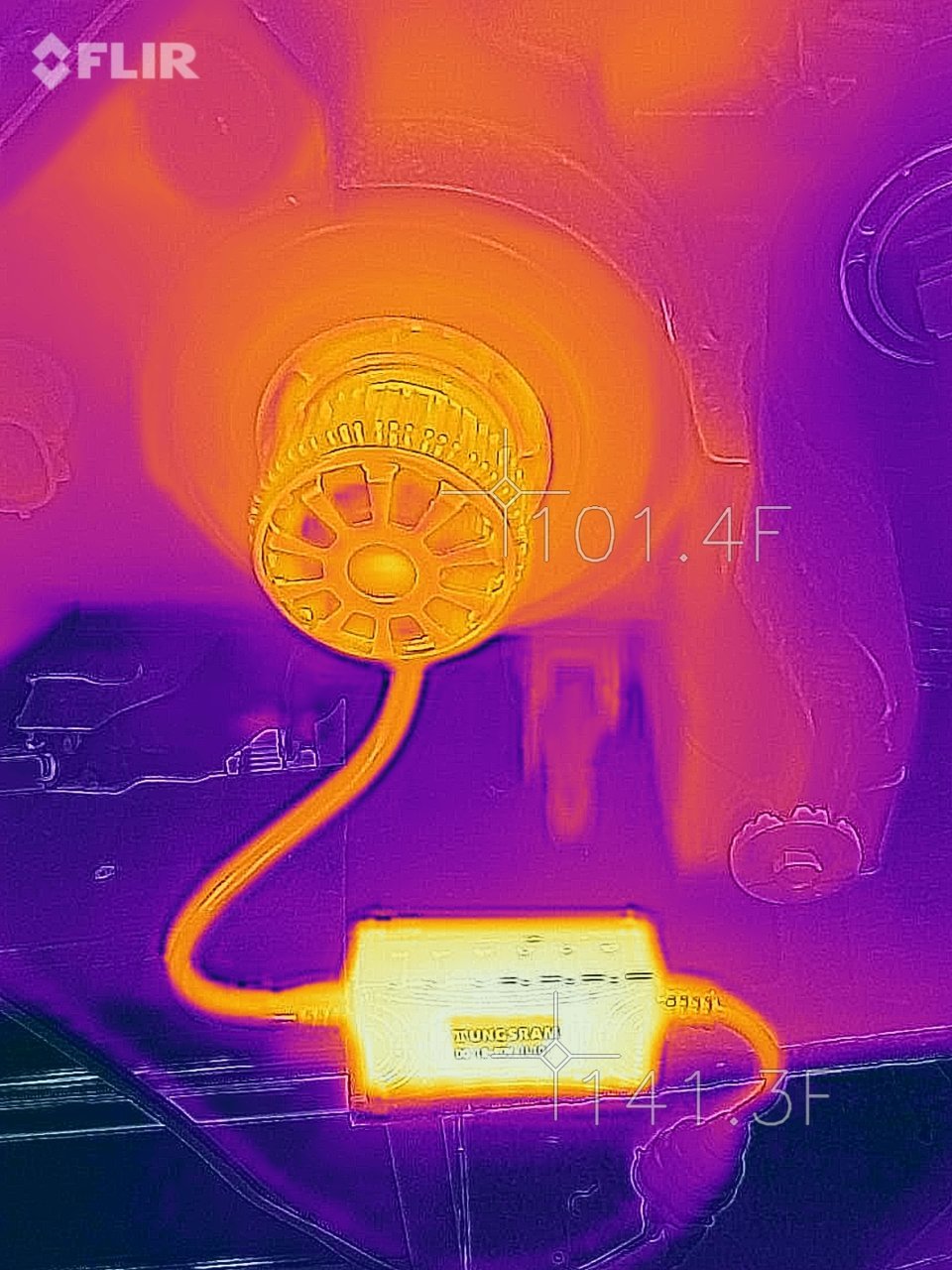

    Those will be terrible as you quoted me earlier.
    However what is also worse and not listed in that response, is they have incorporated the driver into the LED assembly. One of the things that limits LED output is heat, which is why many LEDs have fans and separate drivers. A standard way to help remove heat from the LED is make the driver separate, since the driver runs extremely hot as shown in this LED thermal image of the Tungsram LEDs below. The last thing you’d want to do is put the hottest component on the component you need to cool to maintain output. What that will do is cause the LEDs to be unable to cool adequately reducing their output.
    musicisevil and tattooedsnake like this.

    Foreground light is extremely deceiving, many have this same belief that they are better but humans favor foreground light, not distance light. So your eyes perception of rating light quality is directly backward to how a headlight is supposed to work, limiting foreground light and extending distance light. I’ve had other members swear their LEDs were an upgrade, I bought them and tested them to prove a point they weren’t and even after seeing the data they were still were sure the LEDs were an upgrade due to the foreground light bias. It is extremely common.
