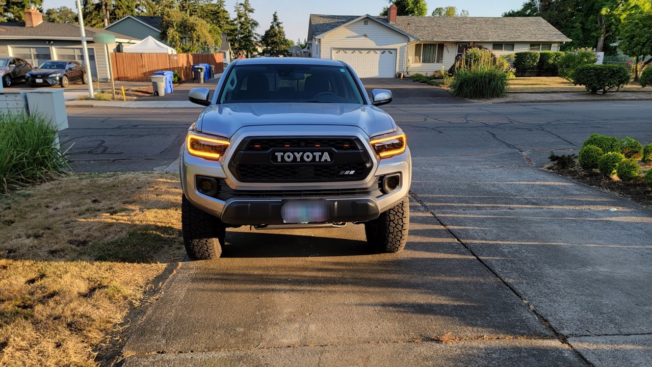

    Or, hear me out... 3rd option:
    Get Morimoto Xbs with Amber DRLs and smoked lenses :anonymous:
