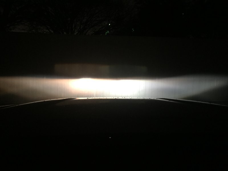

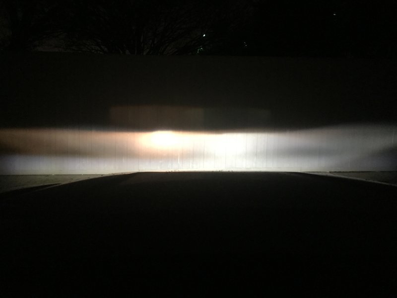

    like i do on every led headlight thread i find, im going to debunk leds being a better light. they are a more even and more visually appealing light but do not put more light where you want it(down the road). everyone needs to understand this before being disappointed by a purchase. in the pic taken against a white wall you can see the "hotspot" the halogen creates. this is there for a reason. it allows the light to shine further down the road. the led is a far more even spread, but would you rather see everything off to the sides and down road evenly for 50 feet? or maybe a less even spread that covers 100 feet down road but only 25 feet to the sides?
    ran opt7's for almost a week before they went into some ricers accord because they were unsafely dim. now have piaa leds which are only barely acceptable until i do proper hid retrofit. until they make a led bulb that throws light in a similar pattern as a halogen, leds will not perform properly in a headlight designed for a halogen

    I'd disagree purely based on my experience with these headlight bulbs. Driving down alley's, poorly lit residential streets and really anywhere else I've been, I can easily see the throw is further than the stock halogens. And the light doesn't reach much more out to the side than the halogens did. It just feels that way because the light that comes out is all connected in a smooth pattern. I can't speak for how your lights worked, but the 2strokes are much better than the halogens in my truck. And thanks to the good ol' Texas weather, I've already driven through clear, foggy, rainy conditions in the week I've had them and I couldn't be happier with the results. In distance and smooth light pattern. I noticed you said that you had the Opt7 bulbs. I read more negative than positive on those bulbs and very little negative on the 2strokes. Which is why I made the selection I did. So this isn't exactly an apples to apples comparison.
    Also, if you notice in the picture up against the wall I took, the hotspot on the halogens is as bright as the entire pattern from the LED. It throws that light further than that halogen hotspot did. And it's a larger pattern.
