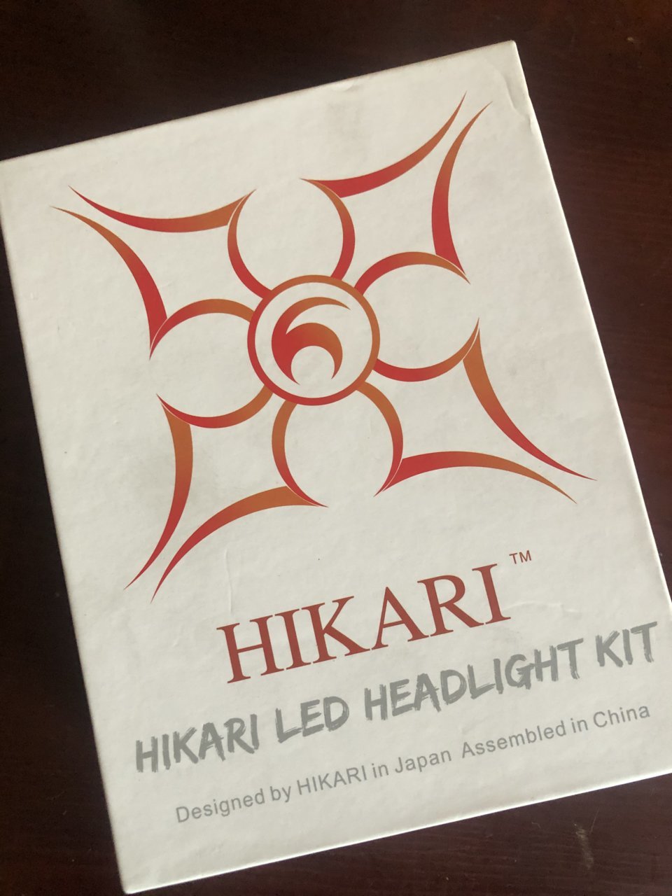

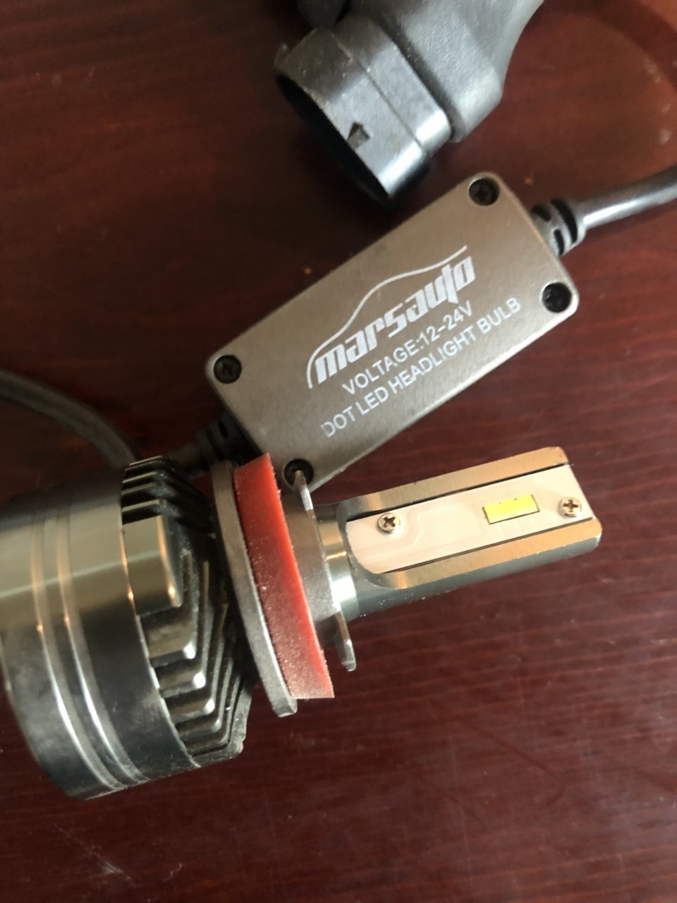

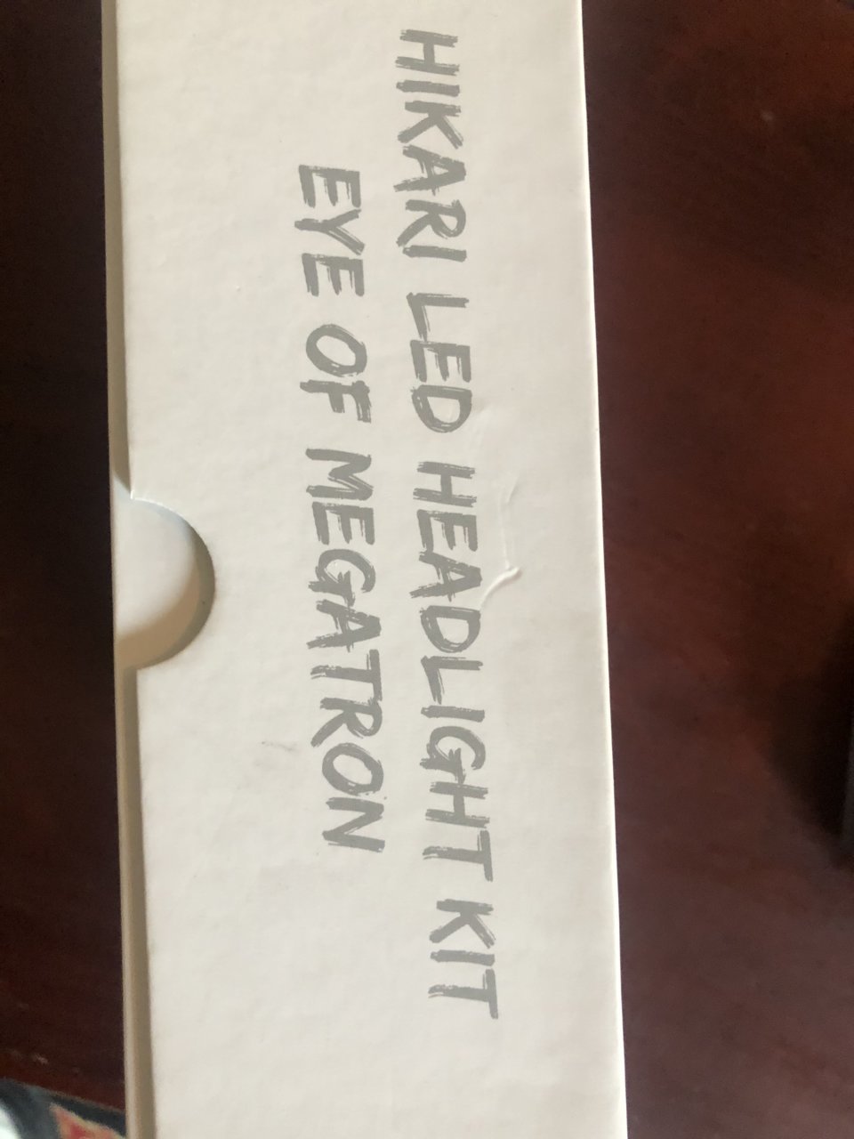

    I just recently threw on the Hikari’s, they were a significant upgrade over the cheap Amazon LED lights I had before.
    B75FC8CA-D66A-49F9-9D01-41AAFC65345A.jpg FBF9EE26-64F7-4DC4-A968-6541F5F8955E.jpg 58E54935-BABD-4E75-AD24-79CDAAF5140F.jpg
    (These are the old LEDs, very poor light at distance compared to OEM)
    I believe that @crashnburn80 is 100% correct. They are probably the best LED upgrade you can do short of upgrading to the LED housing. It’s $90 well spent, while I save up $1500 for the OEM LED set.

    Another Amazon LED fail. "DOT LED Headlight" :rofl:, very clearly another falsified China product. DOT doesn't approve or test anything, the proper term is 'SAE Compliant', meaning it meets SAE pattern testing requirements and is compliant with the regulations. Except ALL replacement LED headlight bulb products are non-compliant, and not "DOT" as they are strictly forbidden by regulation. Another fast one by a cheap China BS seller.
