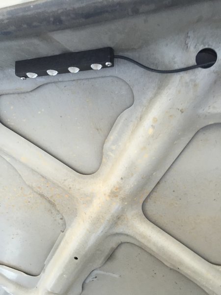

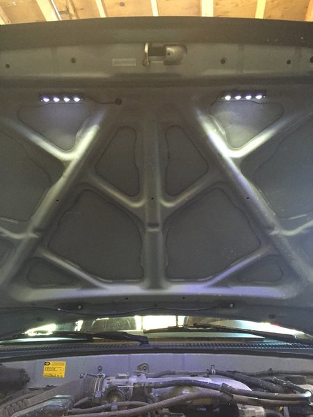

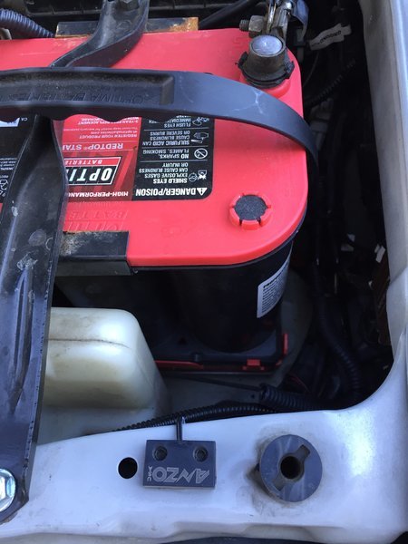

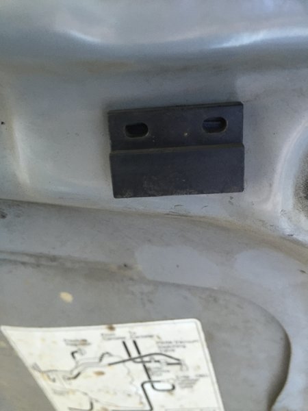

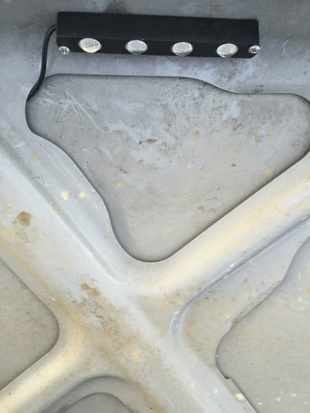

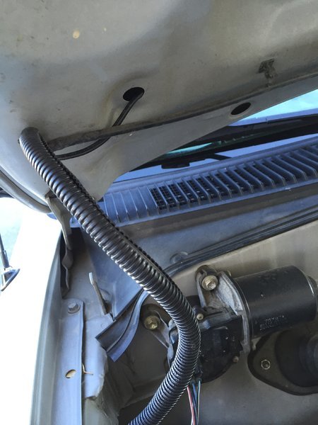

    Here is how I installed my lights under the hood. I ran the wires through the metal under the hood and installed rock lights with a magnetic Anzo brand switch that shuts the lights off when the hood goes down. I also installed an auxiliary switch where I can leave them turned off completely if I'm going to be working under the hood for a long period of time during the day.

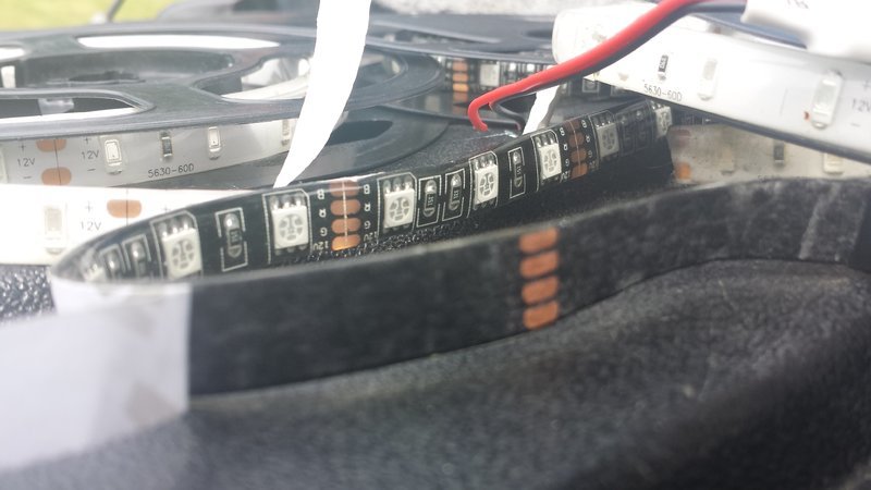

    Yours don't have:
    ? I thought all strips had these at the cutting points.? I have used these strips alot (can't return) and really like them. Just have trouble attaching to metal

    No I do not recall being able to see the embedded metal, not sure if this would work but nail polish or maybe super glue over the exposed metal do they can't ground. ?I thought all strips had these at the cutting points.? I have used these strips alot (can't return) and really like them. Just have trouble attaching to metal[/QUOTE]
