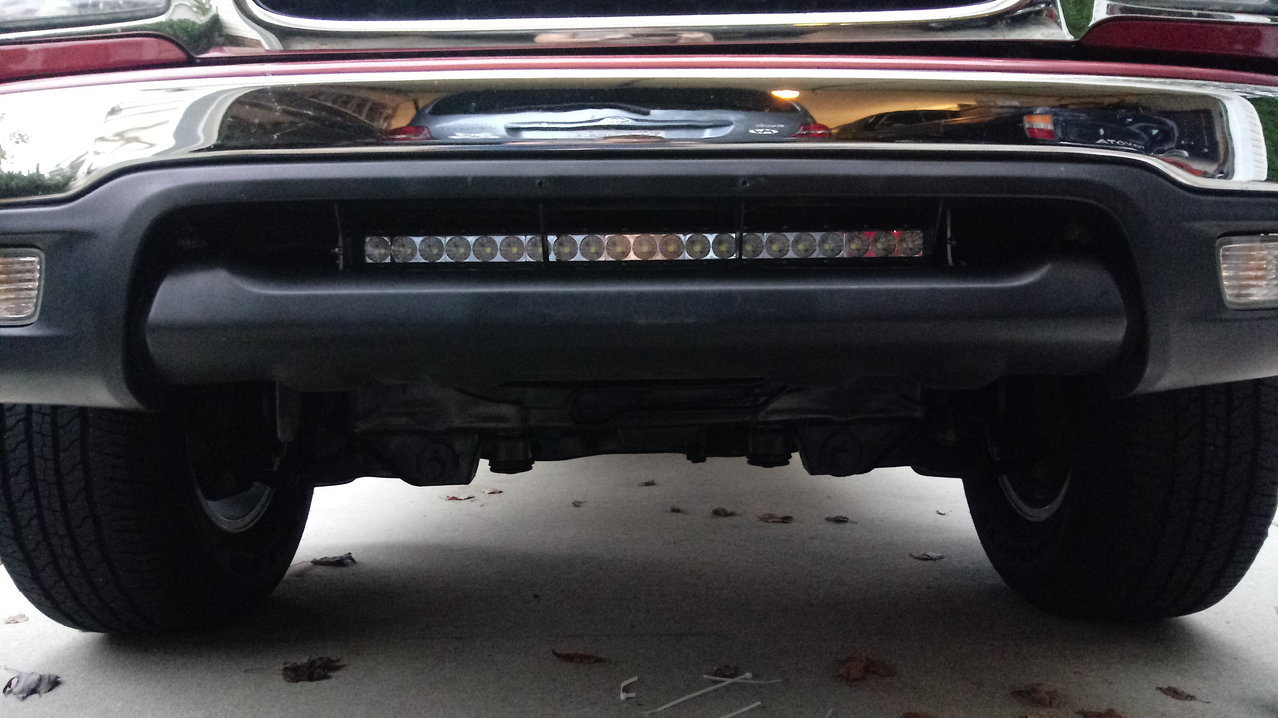

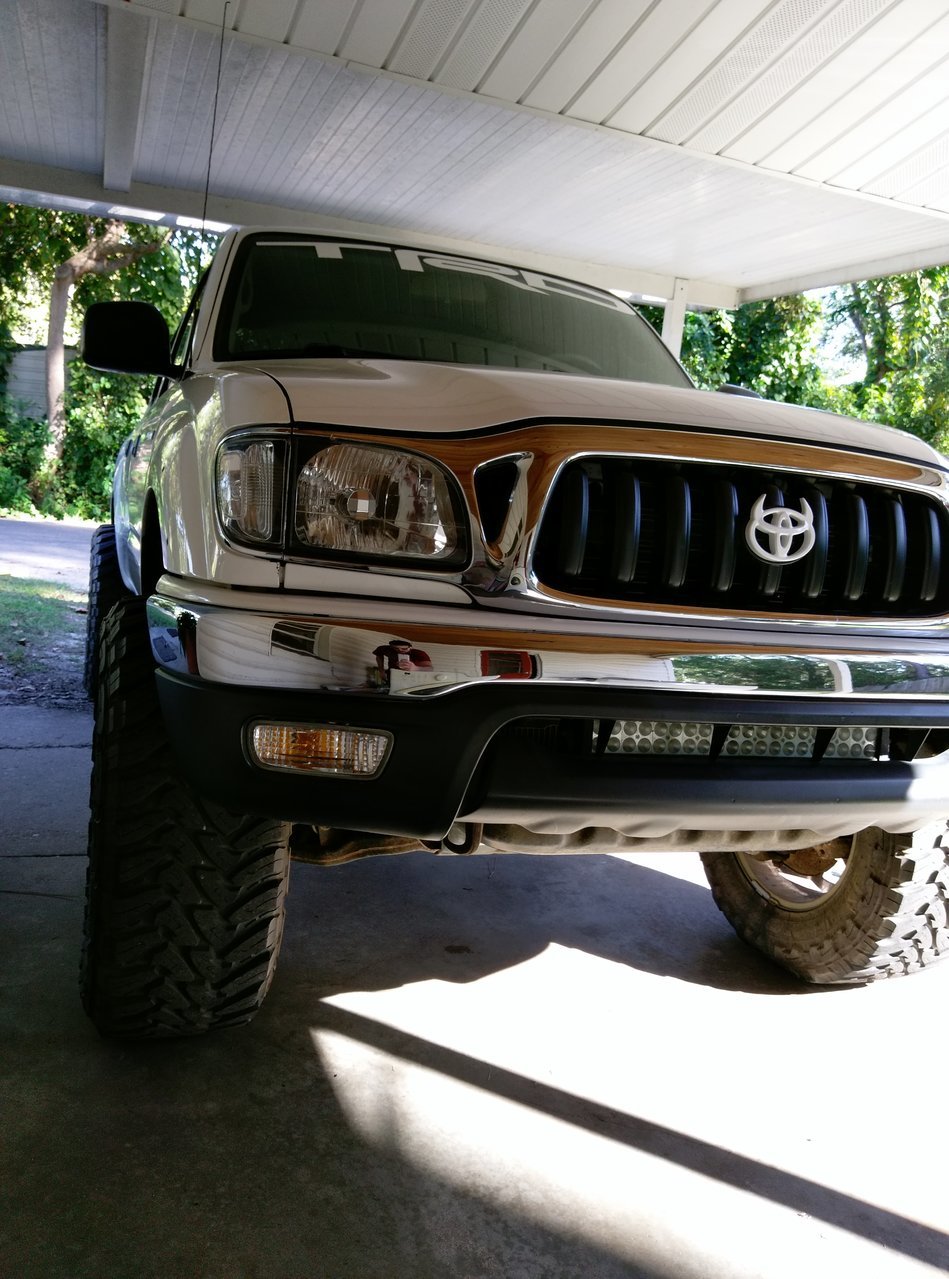

    I did a 24" single row behind the valence. You cant really see it unless you look straight at it, so I dont stand out to thieves. Pretty easy to install and make brackets for. Wiring is simple with a supplied harness. Its pretty bright too, so I dont really use it unless I'm off road or on a backcountry road with no oncoming cars as I don't want a $300 ticket.1013171826b.jpg

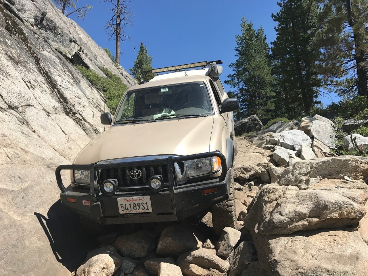

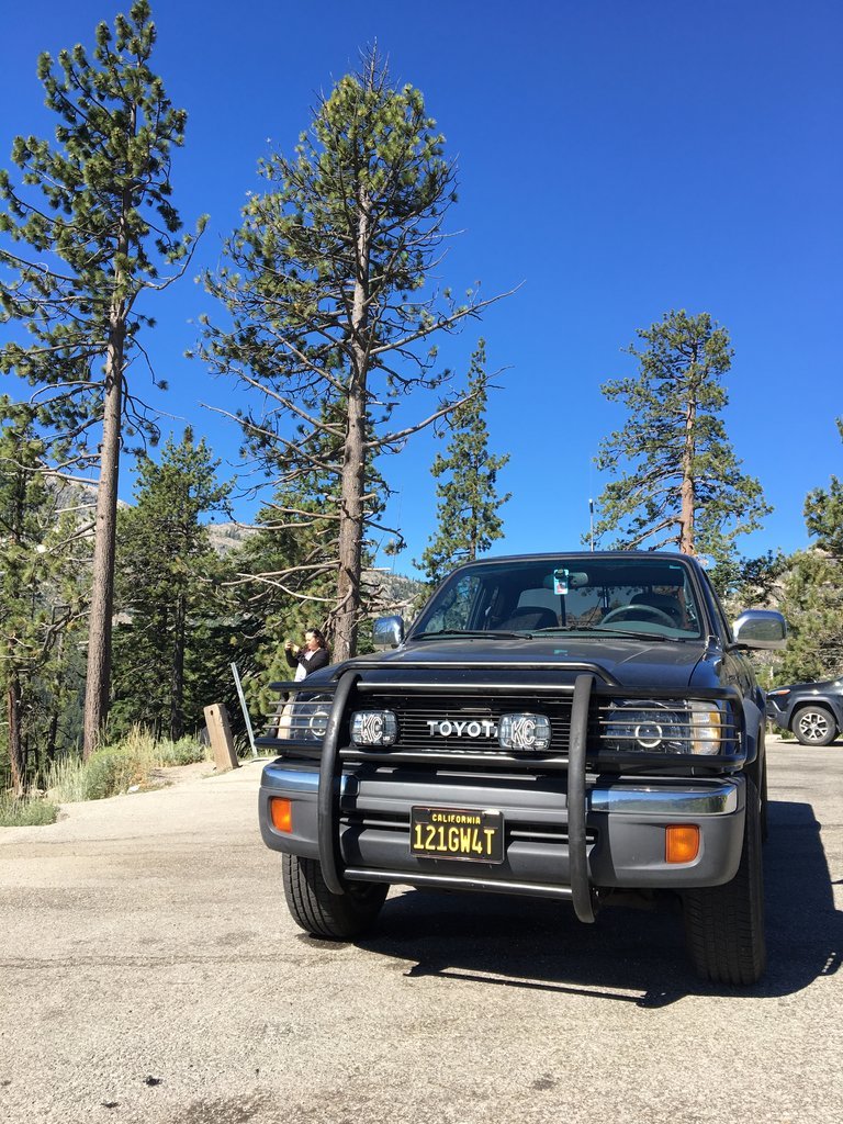

    I know it's not a light bar but I have LED KC lights mounted in my grille guard.

    I used a 24" bar from super bright leds .com. The brackets are pieces of aluminum bar stock that I bent to make the L shape. I went with a 24" but I couldve gotten one a little bigger I think. I bolted the brackets to the frame using the two oversized holes that a brush guard used to mount to. I think all trucks have the holes cause the guy I sold my guard to had them. Ill get some pics of the brackets up later. I don't have any on my phone right now.

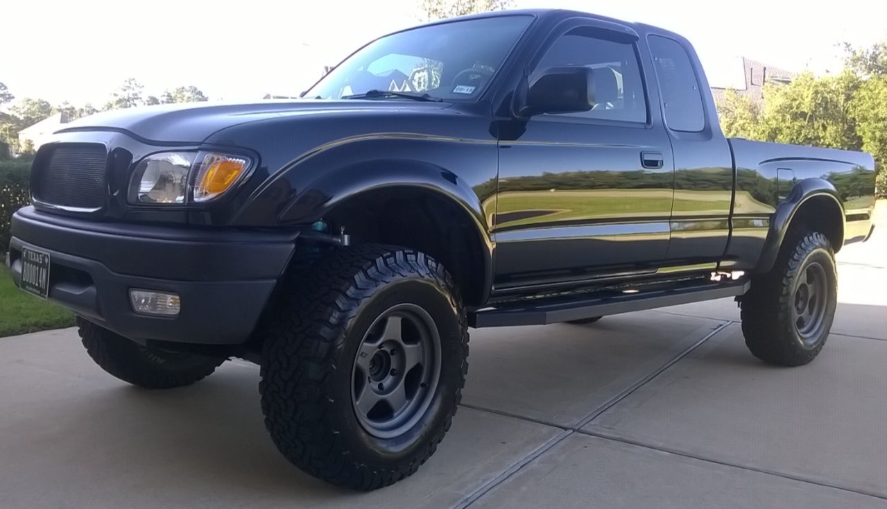

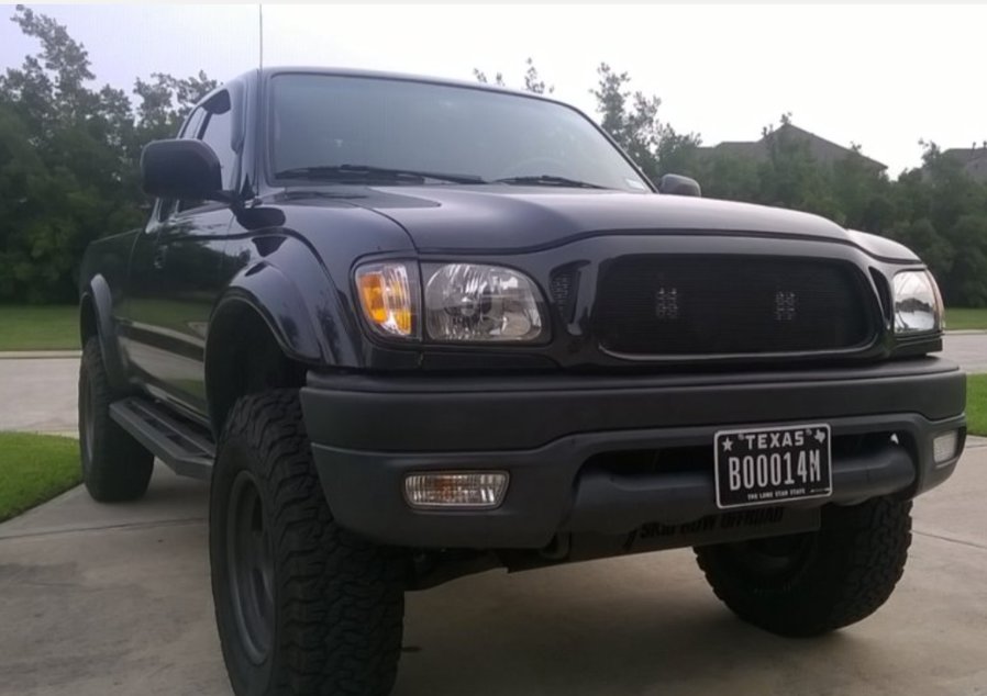

    Here is my set up. I have 2 Baja Pros mounted on the BAMF bar behind my grille. Very bright 10k lumens, stealthy, tucked away from thieves.
