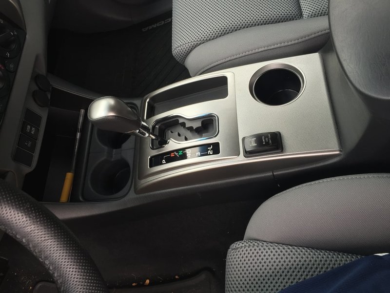

    Yes... I cut them out. if you go with a 31.5" light bar you can leave about an inch of the center fin on either side of the bar... I didn't do this but wish I had. The dual row light fits in snug so I don't think anything will flex or vibrate....
    The opening on the 2012-15 model is not as high, so most guys seem to use a single row LED... but the Rigid Mounts still work.
    As for the switch, I went through the rubber grommet in the firewall and ordered a push-button one that matches the factory fog light switch. Waiting for it to arrive and will post pics!

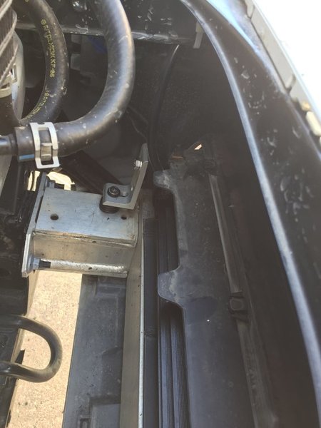

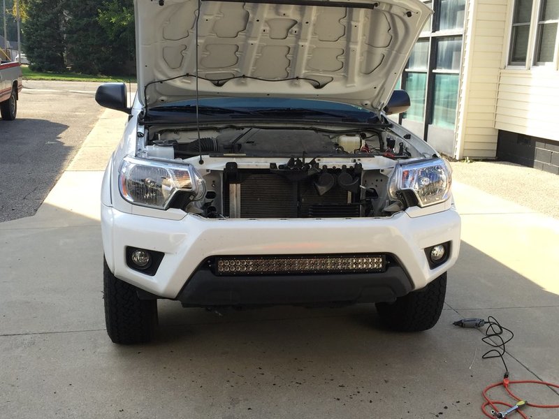

    Did this mod to my 2015 a few weeks back. I've been lurking around this forum for quite some time so it's time for me to put in my part.
    First, I bought a Bi-Color 31.5" LED Lightbar.
    For installation I used the standard mounts that it came with and mounted them to two pieces of angled aluminum. I had to kind of wedge the bar in the lower valence to get it to fit flush.
    Next I wired her up! For a bi-color switch I essentially had to wire up the light like I was wiring up two separate light bars. I have two separate relays to send the load to the light bar, one for normal LED, one for amber LED. These relays are hooked up to a DPDT switch that I installed in my center console behind my shifter.
