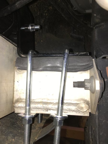

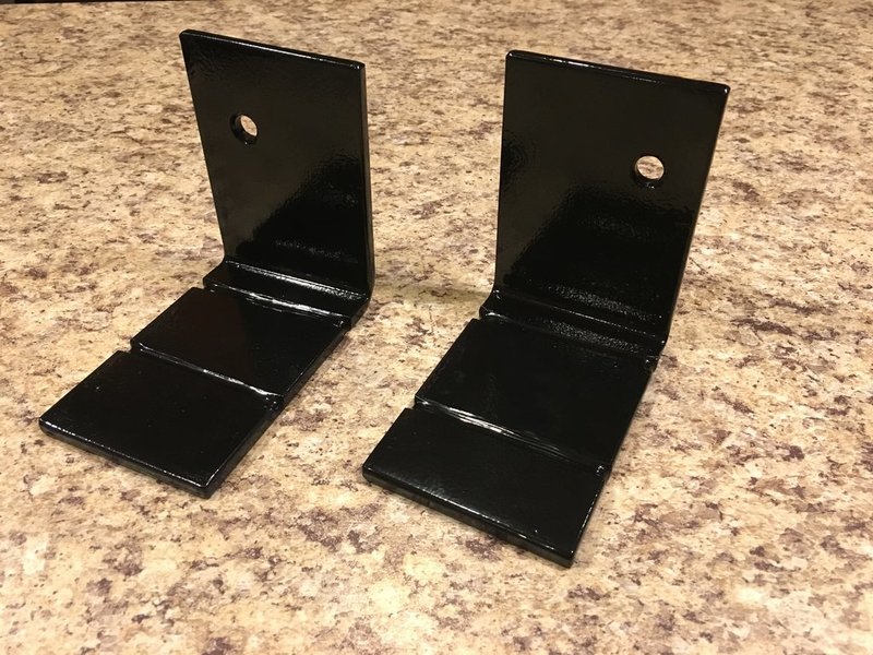

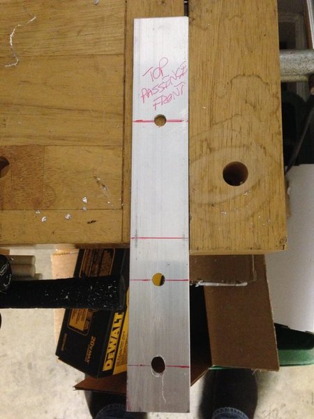

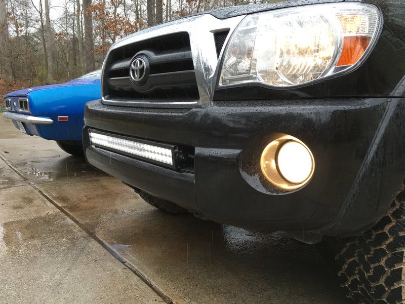

    Here's the homemade mount I did for mounting my 30" bar in the lower bumper. Total cost for making mounts was around $30 including powder coat.
    I wanted something that could be removed and didn't require drilling into the bumper support. I had two pieces of 1/4" flat bar cut and bent. I used a grinder to make some slots for the u-bolts to fit in so they wouldn't slide around. The brackets are mounted using u-bolts and I stuck some bicycle tube rubber in between to minimize vibrations.
    I've had this setup on for a while and it hasn't budged an inch. It's really solid! I didn't want to spend a lot of money and I have fun making stuff myself so I got creative.

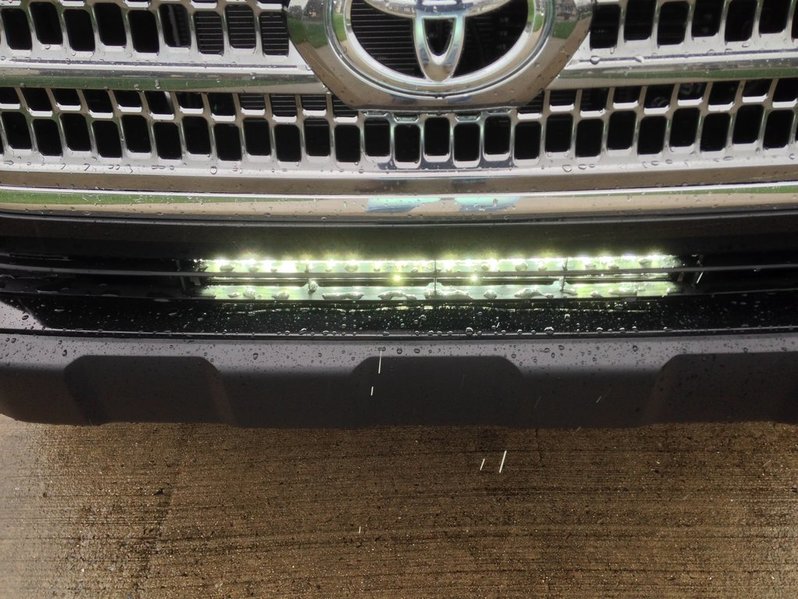

    Bought this 32" 18000 lumen 180 watt from Amazon. Mounted it to the bumper support with self tapping screws.

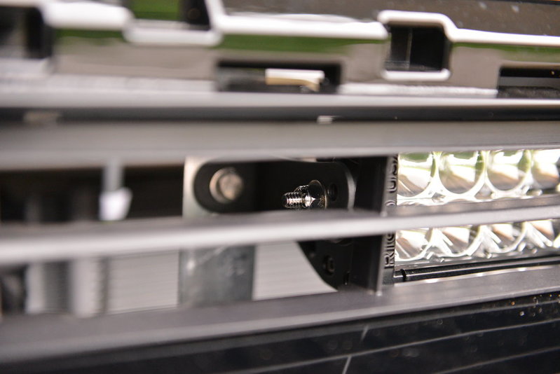

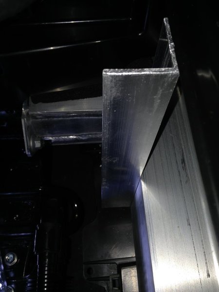

    I used self tapping screws to mount the brackets included with bar to crash cans then loc-tight hex bolts to light bar. Has been holding up fine with regular driving and occasional off-road. Lock washers between screws/mount may secure it further.
