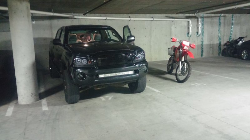

    [​IMG]Put a 34" light bar in mine with the mounts on the light bar included in that measurement. I made my mount with an L shaped bracket you can by from lowes orhome depot. I had to put two verticle flat brackets mounted to the L shaped bracket as the L shaped bracket did not come up high enough to reach where my light bar needed to be mounted to be straight. I drilled a hole, one on both sides, all the way through, on the aluminum bumper stops and bolted my L shaped bracket to that. One on each side. I did it all without removing a thing. Did not remove my bumper, grille, or head lights like i have seen other people do. Also, i obviously had to cut out the slots in my lower grille. Wiring it was probably the more tricky part. But there is an AMAZING thread on here for that...

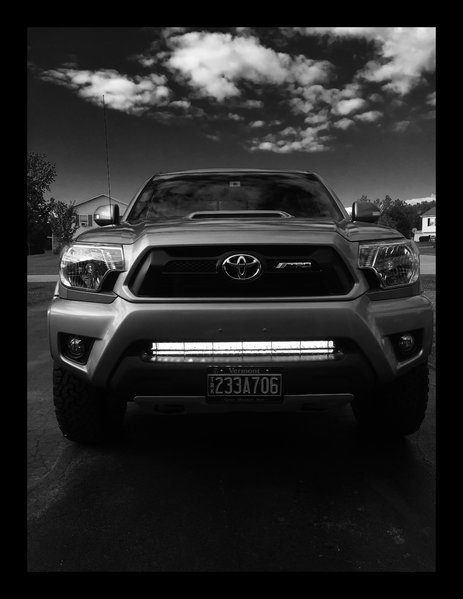

    @MojaveMadman mount and Caliraised 4D lightbar. The mounts are a work of art and definitely the way to go for a lightbar in the lower bumper.
