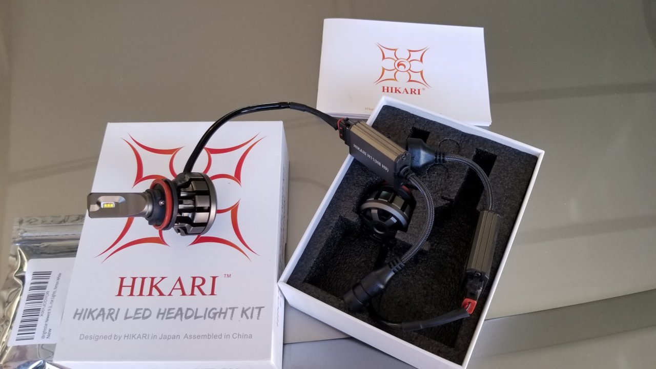

    Got the new Hikari's in the low beams today. Went well and they are impressive . Posititioned the diodes so they sit at 3 and 9 o'clock. Wondering if the narrow tip of the bulb should be pointing upward or if it's possible to even try the opposite(pointing downward). Thought about it after buttoning every thing up and it got dark. They work great anyways.

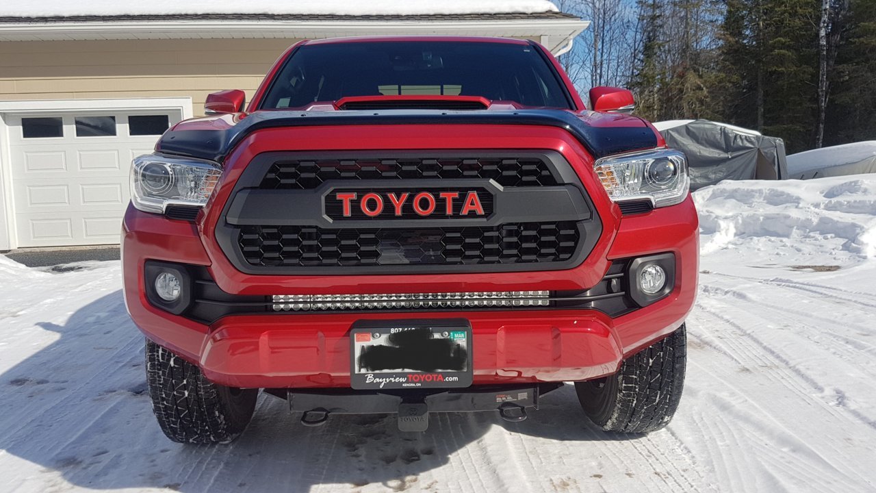

    Where did you get that led bar. Did you have to cut anything ?

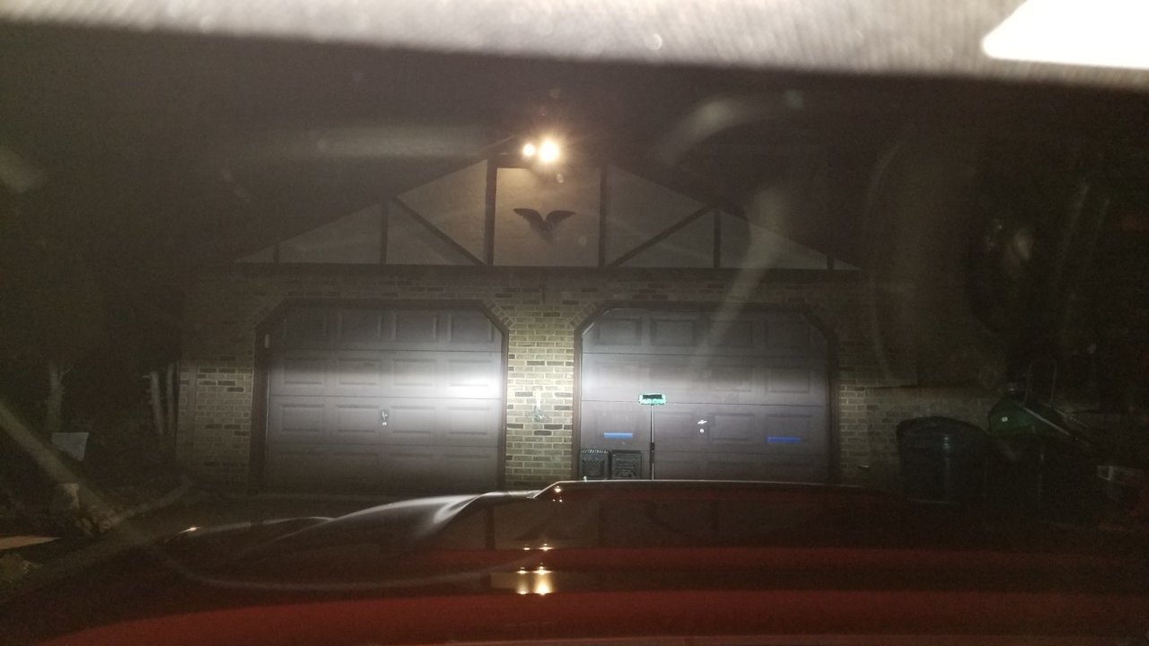

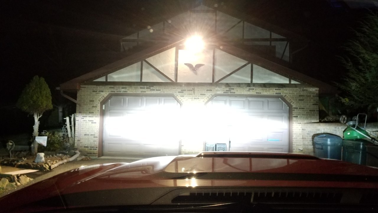

    Here's the proof right here:
    New
    Added the other set of Hikari Philips Lumileds to the High Beams to go along with the Hikari Philips Lumileds Low Beams and the Morimoto XB Fogs
    First pic is no lights so you have a frame of reference. Just so you know how dark it is up at the house. Even with a full moon.
    Second pic is just the Morimoto XB Fogs and it definitely looks like I might have to adjust them a little more as to me they look a little low. The base of the second tree on the right is approximately 60' away.
    This next pic is the Fogs and the OEM DRLs. The DRLs really do a great job of supplementing the fogs.
    This 4th pic is the Fogs, and the Low Beams, No DRLs. I think I need to adjust the low beams up a tad too. The DRLs do add some light.
    This is the money shot. DRLs, Lows and newly installed High Beams on. Wow.
    Not bad for $227.00 (after I sold my OEM fogs for $65). I am completely satisfied and up here in the country with our large deer population I feel much safer.

    Didn't have to cut anything. I installed it using a 2nd gen light bar mounting bracket because they were half the price of the 3rd gen brackets. The light works really well and at $35 was worth taking a chance. I actually spayed it with my pressure washer at close range to see how water proof it is, no issues. The light is shallow in depth so it makes the install easier.
    https://www.ebay.com/itm/32-inch-LE...e=STRK:MEBIDX:IT&_trksid=p2060353.m1438.l2649

    Wow, Rob! Excellent light review my friend. Very detailed and consistent. Once again showing how great those new Hikari Phillips are. Those Mirimotos look fantastic as well. I wish I could find a road near me that as dark as that for my next comparison.
    I noticed you said you might need to adjust the headlights up a tad bit. I agree, because that’s what I did as well. Not to much though....what I did was pull up to a wall and turn the low beams on. Placed a piece of green painters tap right at the top of the cut off making sure it’s level. Then adjusted both headlights so that the new cut off passes that tape line and that should be plenty. Maybe about 1” I’d say. Good luck!

    Yea, since when I pull up on vehicles at red lights and the light is not riding up on the trunk of the car, I was just going to pull my car into that lane and pull up behind it and make the adjustment. That way I know for sure it's not too much. I think like you said, 1" maybe 2" but that would be max.
    RuggyBuggy, I would do this at my house but my driveway starts to arc about there and the light beams just continue to rise.
    Why I think doing the adjustment down in the flat lane with both vehicles on the same plane would be best. I could even make the adjustment and get in the car and pull it forward to be sure it's not to high and coming in. I mean though, that's what auto/manual dimming rear view mirrors are for. I'm more worried about blinding oncoming traffic. Right now as it stands, not a single flash.
    :thumbsup:
    I forgot to add these photos last night/this morning. These photos show how uniform the beam pattern is of the Hikari Low Beam and High Beam combined.
    I had to adjust the camera settings to speed up the shutter just so that the actual light pattern could be seen. That is the second photo.
    The reason it's so high is because the driveway is arcing or rolling off at this point. Pretty intense no?
    Here's the adjusted shot
    Pretty damn even spread and pattern of you ask me. Especially when people say LEDs don't work in these projector housings. LOL
    Looks like they work to me. Oh, and I am not skilled or confident enough to adjust the collars of the bulbs on the High Beams like some have done so these are just right out of the box and into the truck :D
