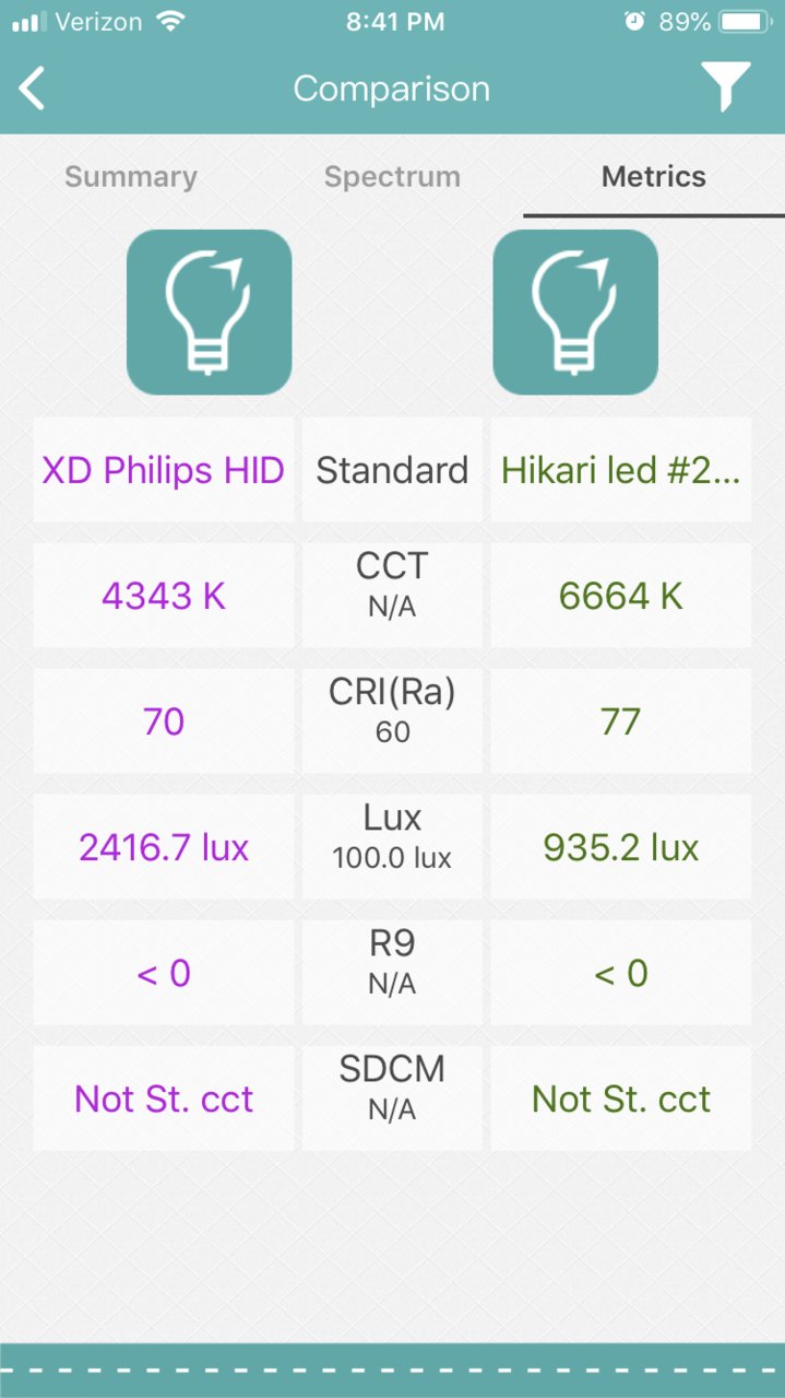

    As much as it pains me to say this, you get better output out of the Hikaris in the headlights due to their thinner cross section creating a more intense hotspot for further distance projection. I've tried several and they actually do they best. I’m not a fan of fans for cooling and I do question the Hikaris build quality, but overall they mimic the halogen better than others for best performance.
    Even the Hikaris produce glare in the reflector fogs though, as demonstrated here:
    https://www.tacomaworld.com/threads/led-lighting-conversion.436865/page-151#post-18006593
    Which is why one of these options is a far better approach for a fog:
    https://www.tacomaworld.com/threads/the-led-sae-j583-fog-pod-fog-light-review.554813/
    Excellent choice. While the Hikaris may be bright, there is no comparison to HIDs. I like that XenonDepot offers genuine German Philips bulbs, and 4300k is the best color temperature for output.
    Here is how Hikaris compare to XD Philips HIDs in measured readings:
    They are over 2.5x brighter than the brightest LED.

    Damn dude, I read the first part of your post thinking it was in reference to me saying I ordered HIDs. I was like shit! Then I saw my section you quoted...phhewwww. Almost got pissed there for a second!
    Glad to see the HIDs are still have a much higher lux reading.

    Haha, no, definitely not! The HIDs you ordered are going to be far brighter with better distance projection than LEDs.

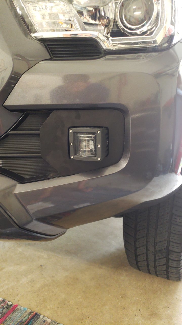

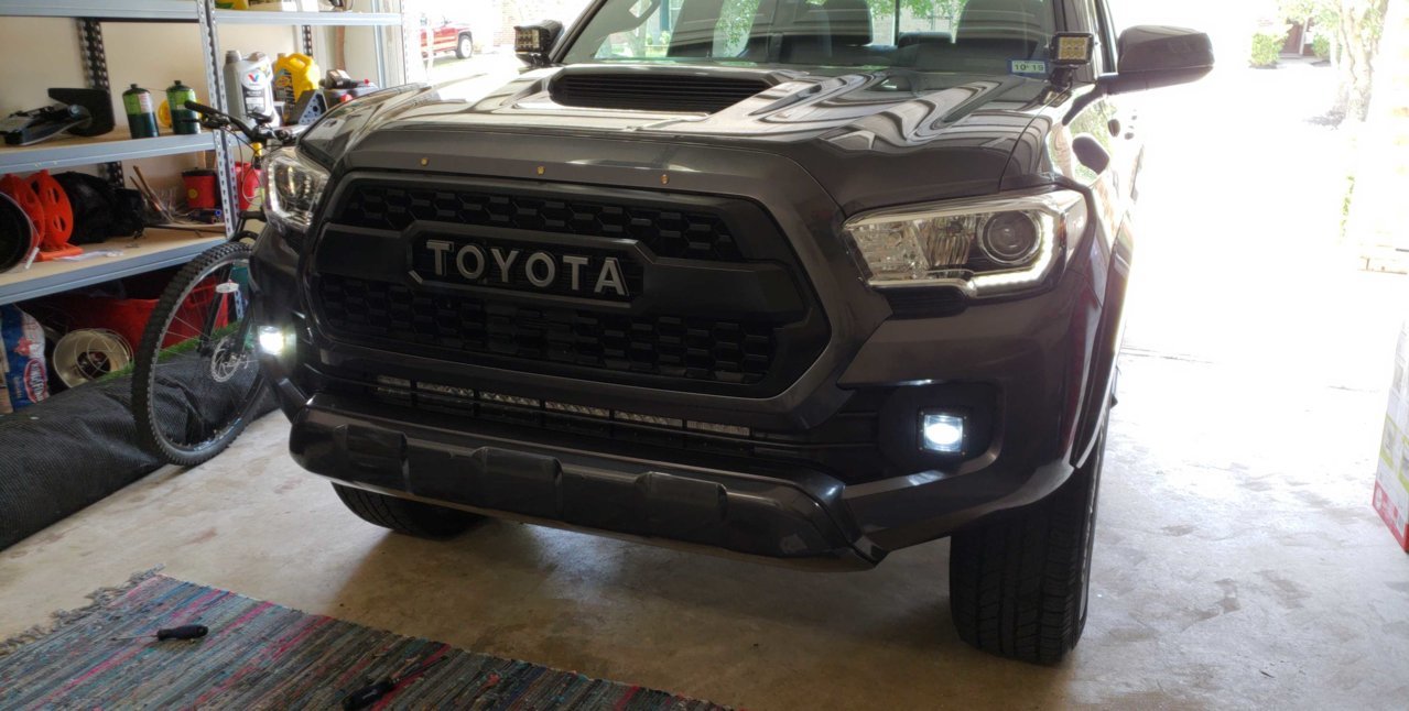

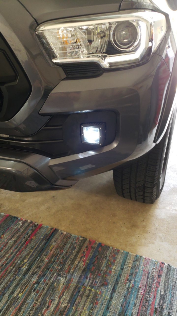

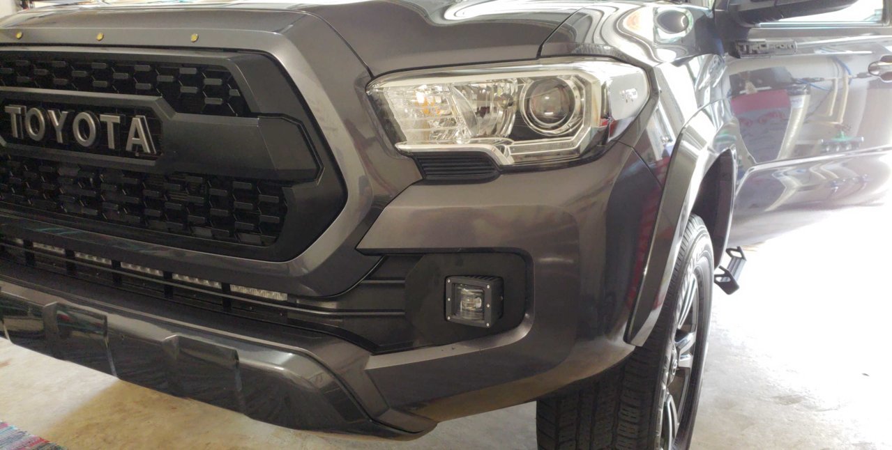

    I'm still running the OffRoad Town SAE projector cubes you sold me as my fog lights. They are kick ass and I love them :thumbsup:

    I suppose those are the ones. I bought them directly from @crashnburn80. I have yet to get a picture of them. I have the before pictures using the OEM reflector housings and AuxBeam F16 and Hikari Phillips LED bulbs. Its been raining in Houston for like 3 weeks straight. As soon as I get a chance I will go to the same spot I took all the others and get the after shot.
    Here are some pics of them installed.

    Difference is those are drastically more powerful than Morimotos, easily worth the couple extra dollars IMO.
    Lux at 18ft
    Morimoto: 170
    ORTown pods: 352
    And while being far brighter they have perfectly clean cut offs with zero glare.
