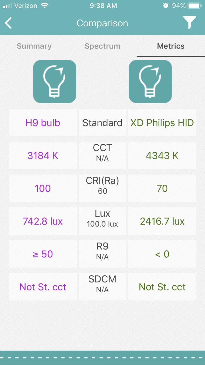

    I’ve measured the color temp, halogens are about 3200k and the Philips HIDs are about 4300k.
    You can see they are not the same color. However you may prefer a higher color temperature which is completely fine if that is what you like. You lose about 7% in output going to 5000k which may be very well worth it for your preference. Stepping up to the 6500k results in a 12% loss. All my recommendations are based on best possible performance, not lighting cosmetics. Your OEM HIDs also benefit from having an HID projector and not putting rebased HIDs into a halogen projector optimized for a filament light source, it simply isn’t going to work as well or look as good as using the correct projector.

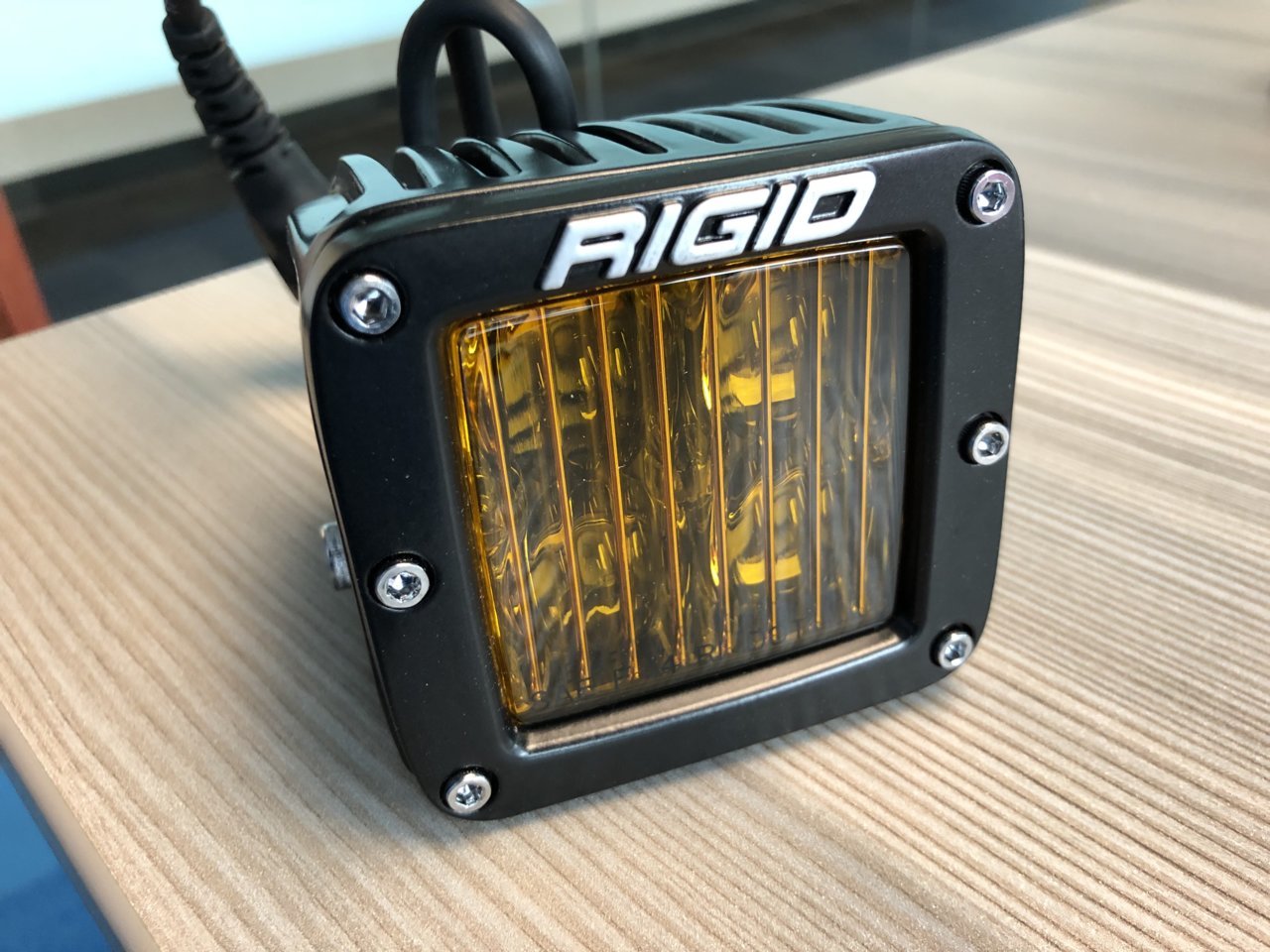

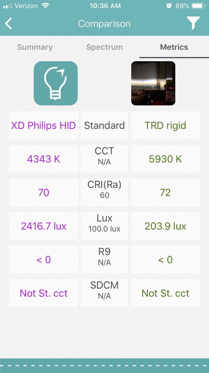

    Right the TRD Rigid Pro fogs are about 5900k. Even though a 4300k light is whiter than halogen it is going to look yellower than the 5900k LED fogs. Measurement for reference.

    Quality is not cheap! There was quite a bit of work that went into these to maintain SAE pattern compliance and get the improved output intensity in the amber color. Much easier/cheaper to build a product that does not need to meet SAE beam compliance standards. I’m pretty happy with how they turned out. Just waiting on the brackets to mount them on my truck for street testing.
