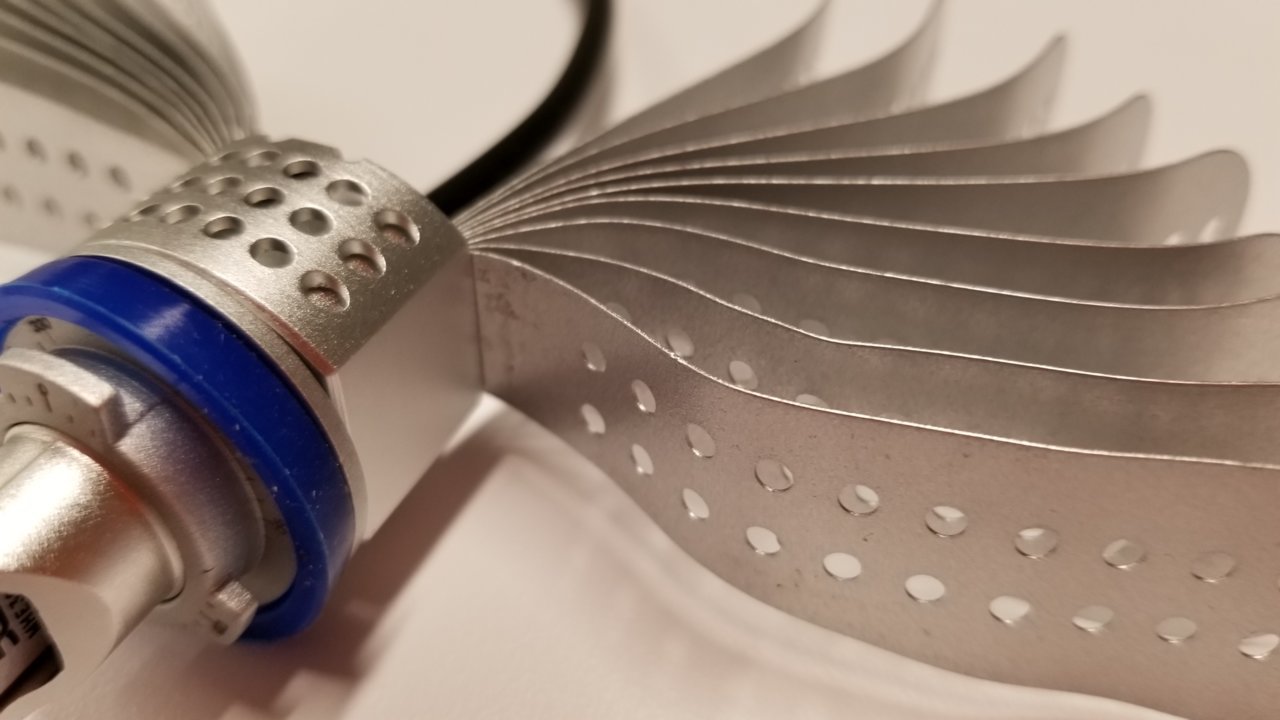

    So the fins on the back of the LEDs don't have holes like this
    And you bought the Extreme Pros?
    They don't get hot enough to melt anything. The washer fluid reservoir is way to thick to melt.

    Yes, I did get the extreme pro's. Another member replied, apparently they changed them recently, supposedly 10 percent brighter also, but I'm not sure.

    Interesting. 10% brighter. Double interesting.

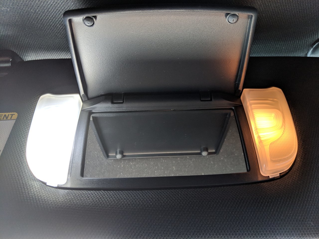

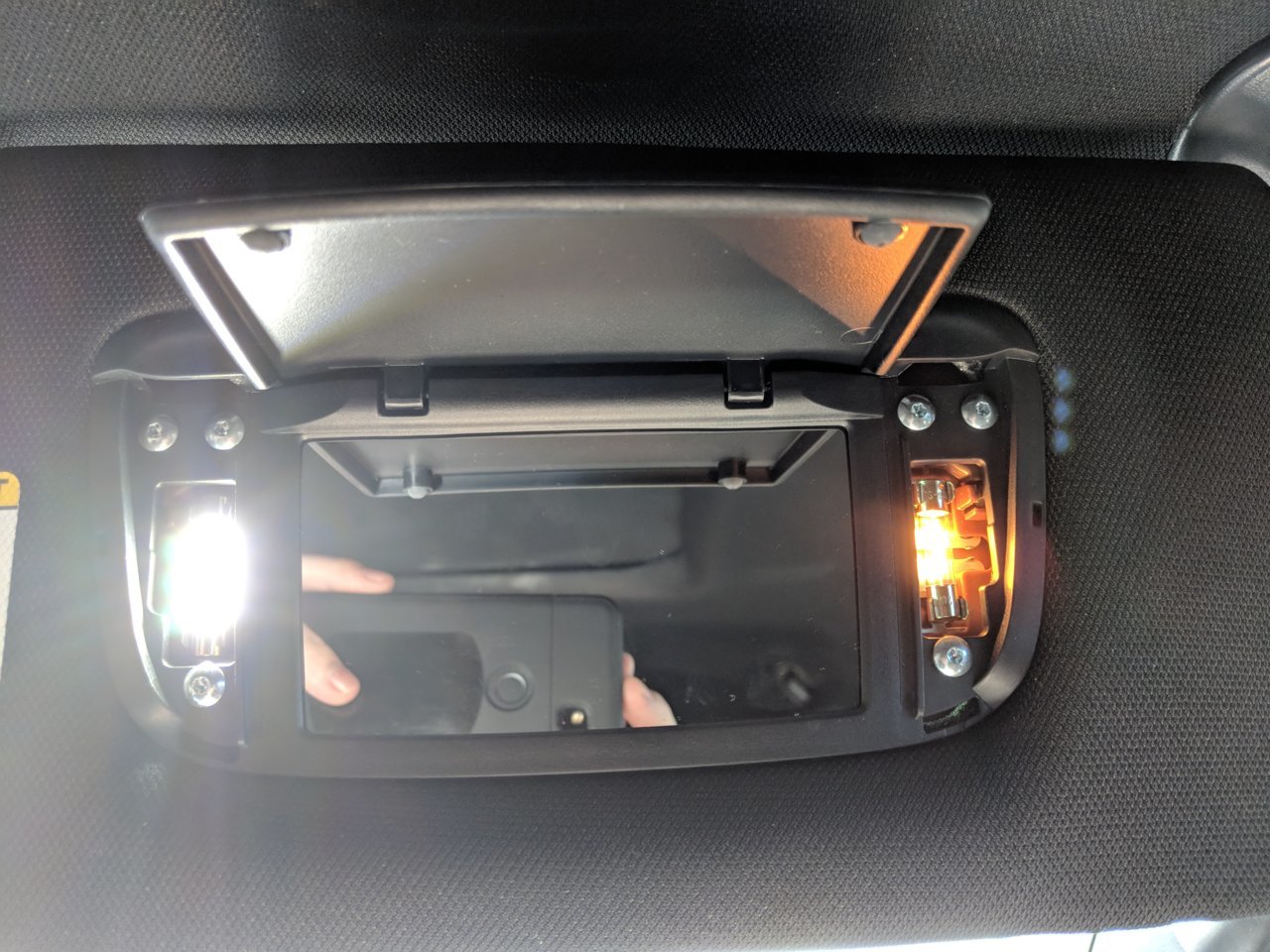

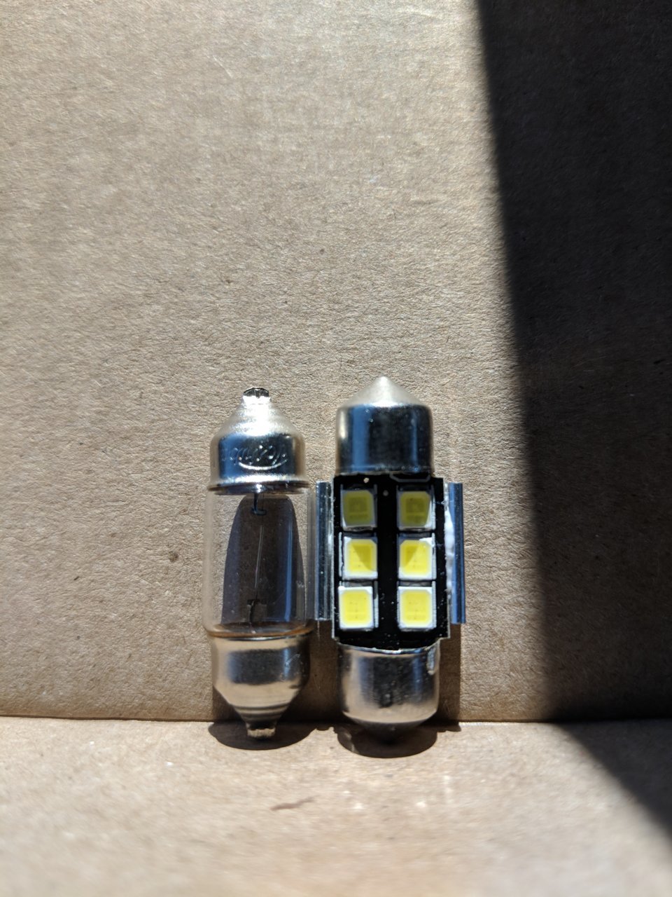

    Finally installed the complete interior light kit from @deAutoLED.com. Like said before the difference from stock is night and day. Almost too bright, haha. Great customer service and they even included a couple spares which I'm glad they did. The only issue I had was with the rear dome light being slightly larger than stock, I tried to cram it in but ultimately bent the connector back a little and made it work. :thumbsup:

    RobP62 likes this.

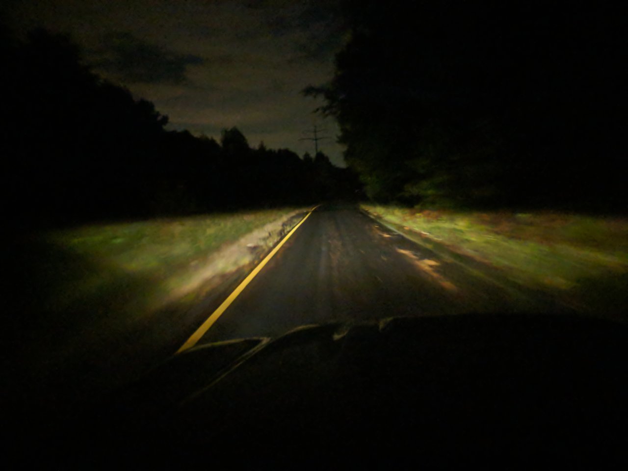

    I installed the LEDs at 3 and 9 o'clock, which is the only way an LED retrofit should be installed.
    In the video they compare stock to 3200+ lumen HIDs headlights plus drop in LED fogs. Comparing the first and second photo in the video, the much less bright LED fogs (compared to HIDs) look just as bright as HIDs with extended glare radius facing the vehicle in the video. The LEDs are no where close as bright, the video demonstrates extensive glare, the author is just not informed enough to recognize it. Not getting flashed is not a valid determination of beam control.
    Plenty of people install products that cause glare. I see dozens on the road daily. Even talk to some that have no idea they are blinding everyone and just think their lights are bright.
    Here is an example of my truck. The light on the right is literally over 100% brighter than the light on the left, but they look identical because the cutoffs are maintained and glare is controlled identical stock even though light output is increased substantially. That is what glare and pattern control should look like, it should be indistinguishable to oncoming traffic.
