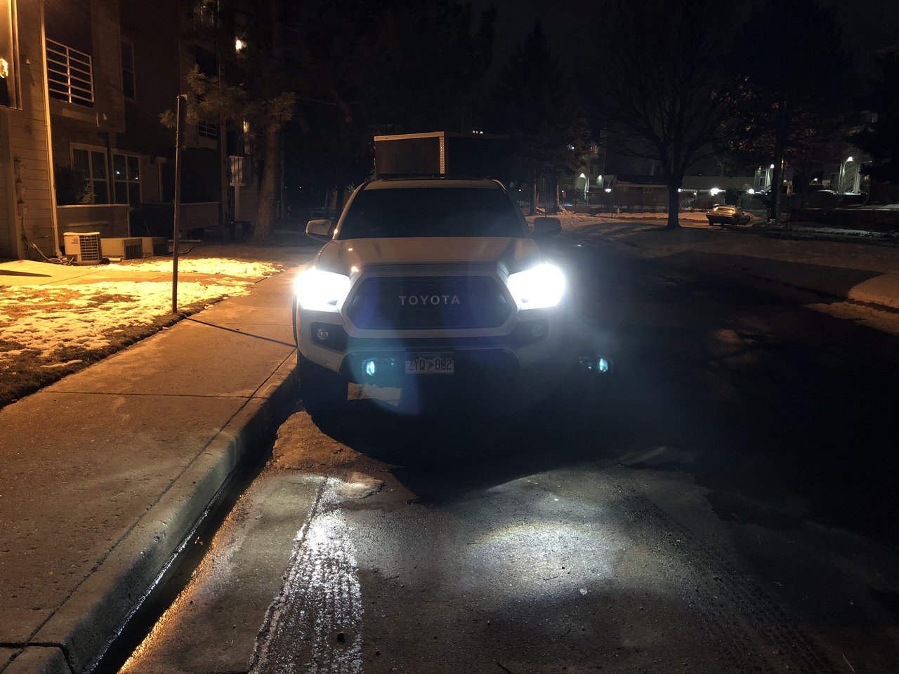

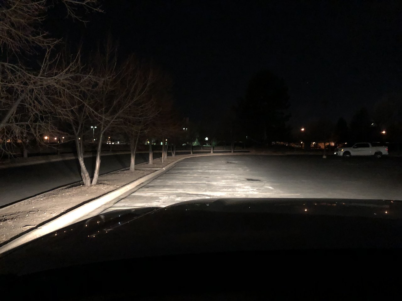

    Here are a few shots of the HID headlights output:
    Off:
    Headlights Only:

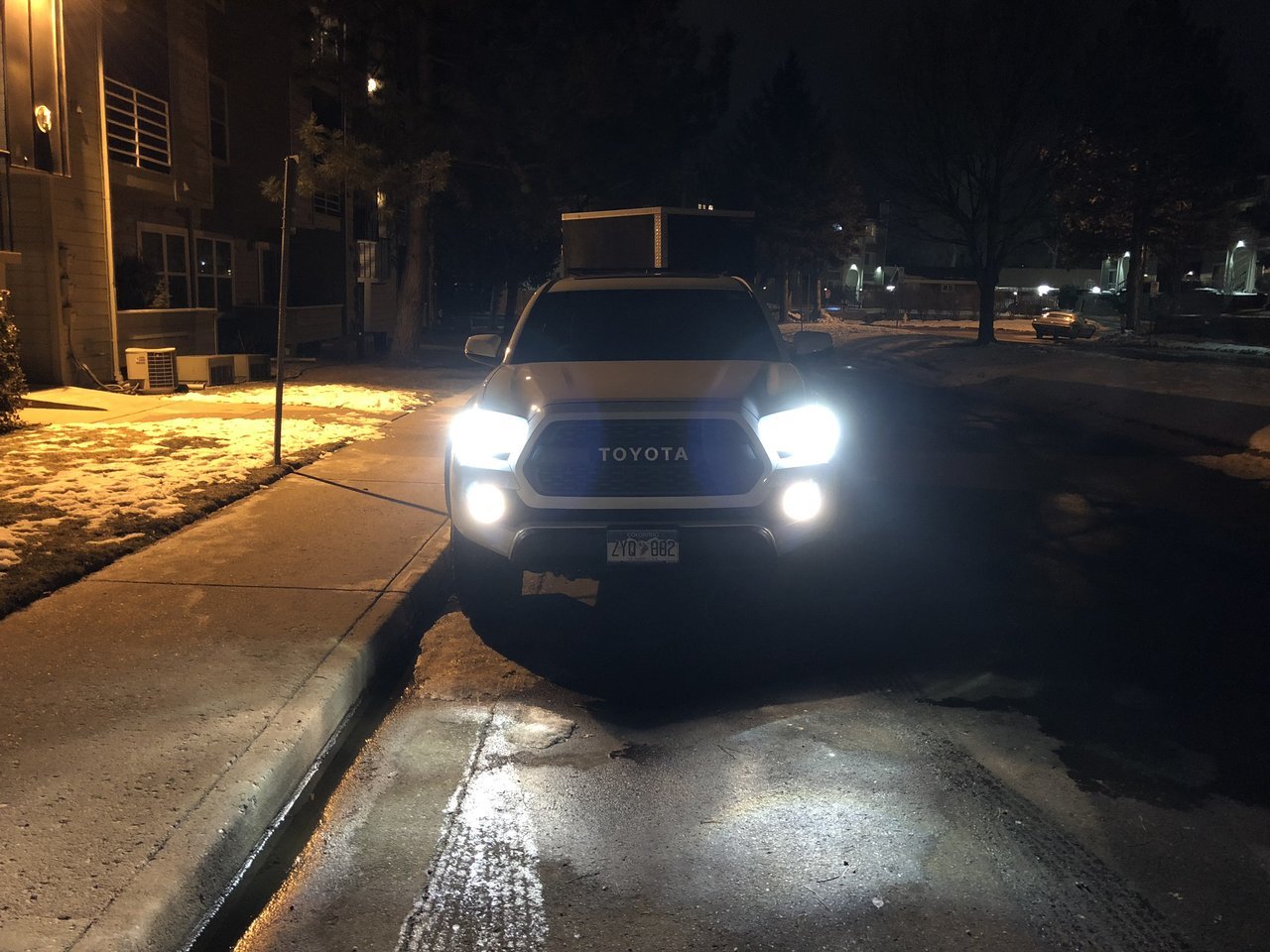

    Headlights and Fogs:

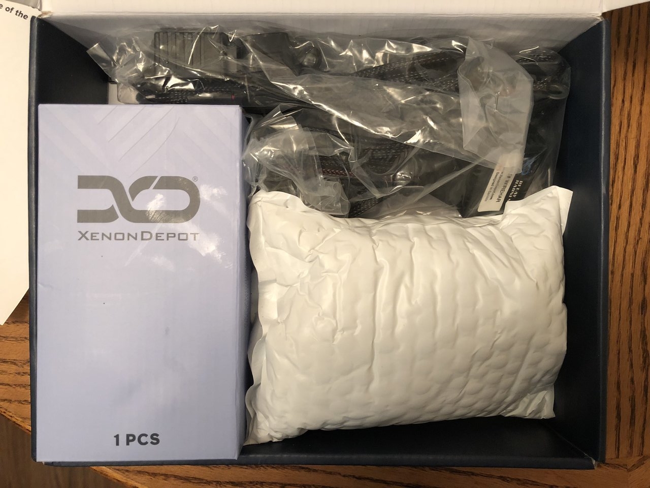

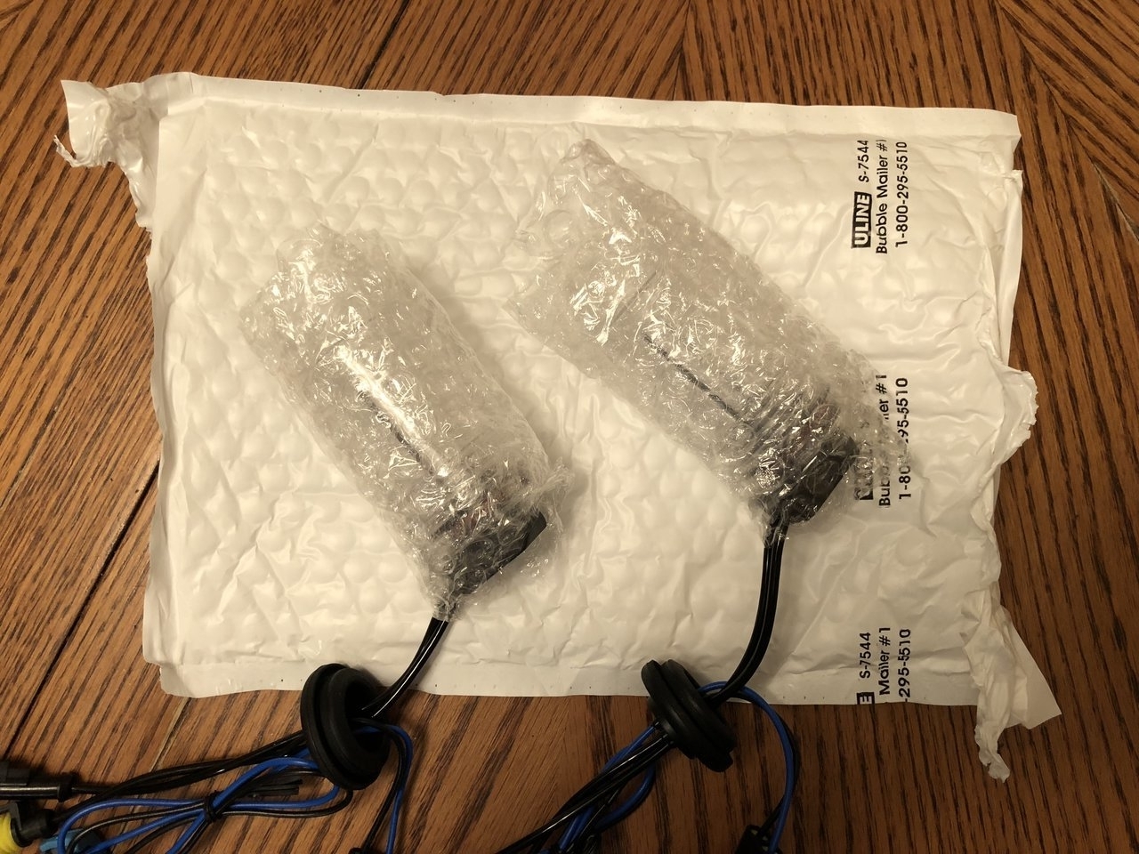

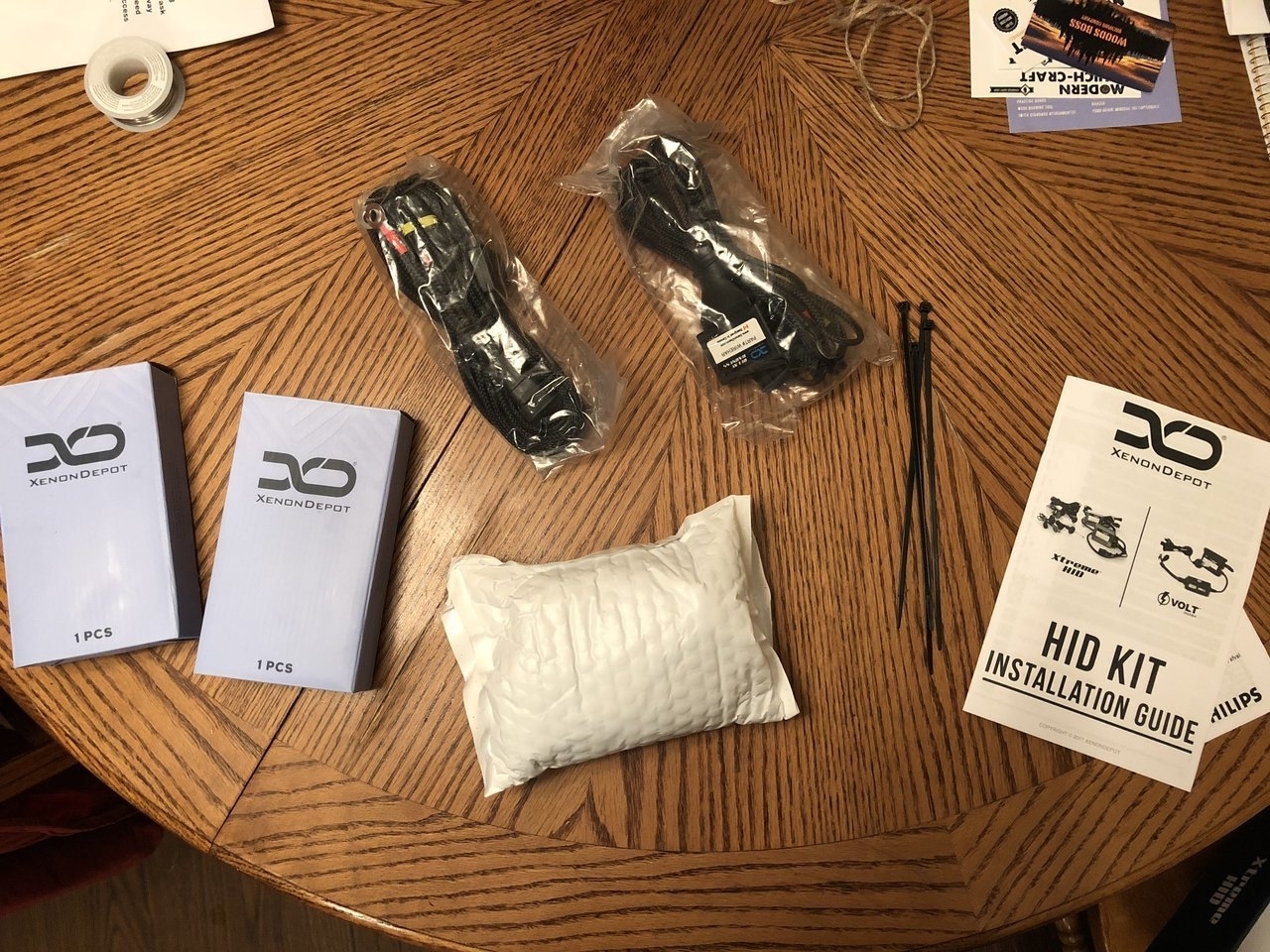

    This is how the kit was packaged when I opened everything up on Thursday. Everything was packed nice and tight with plenty of protection.
    Below, the Philips bulbs are packed in the white bubble wrap envelope then they are wrapped again in more bubble wrap outside of their individual plastic sleeves. The ballasts are packed in the boxes (they are stacked two deep), and lastly the harnesses are in the plastic sleeves. The kit also included some 3M adhesive for the ballasts and a minimal amount of zip ties (4)...GET MORE ZIP TIES, I used a lot of 4" ties and some 8" ties as well.

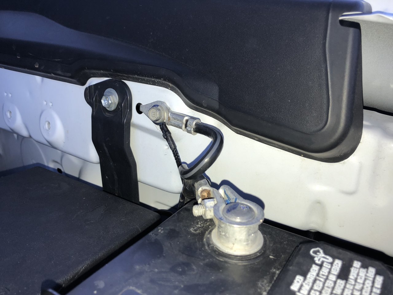

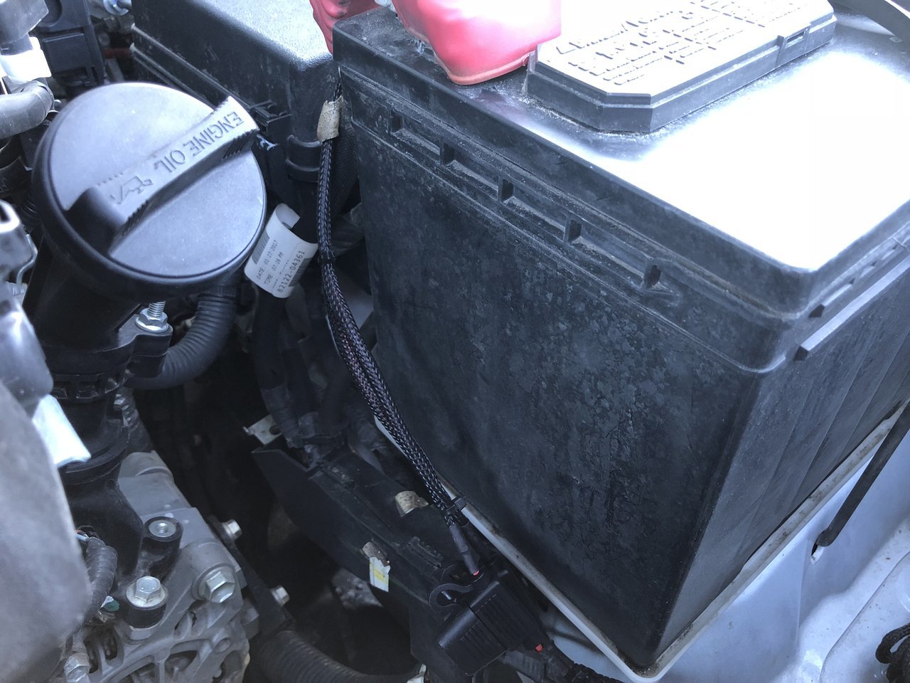

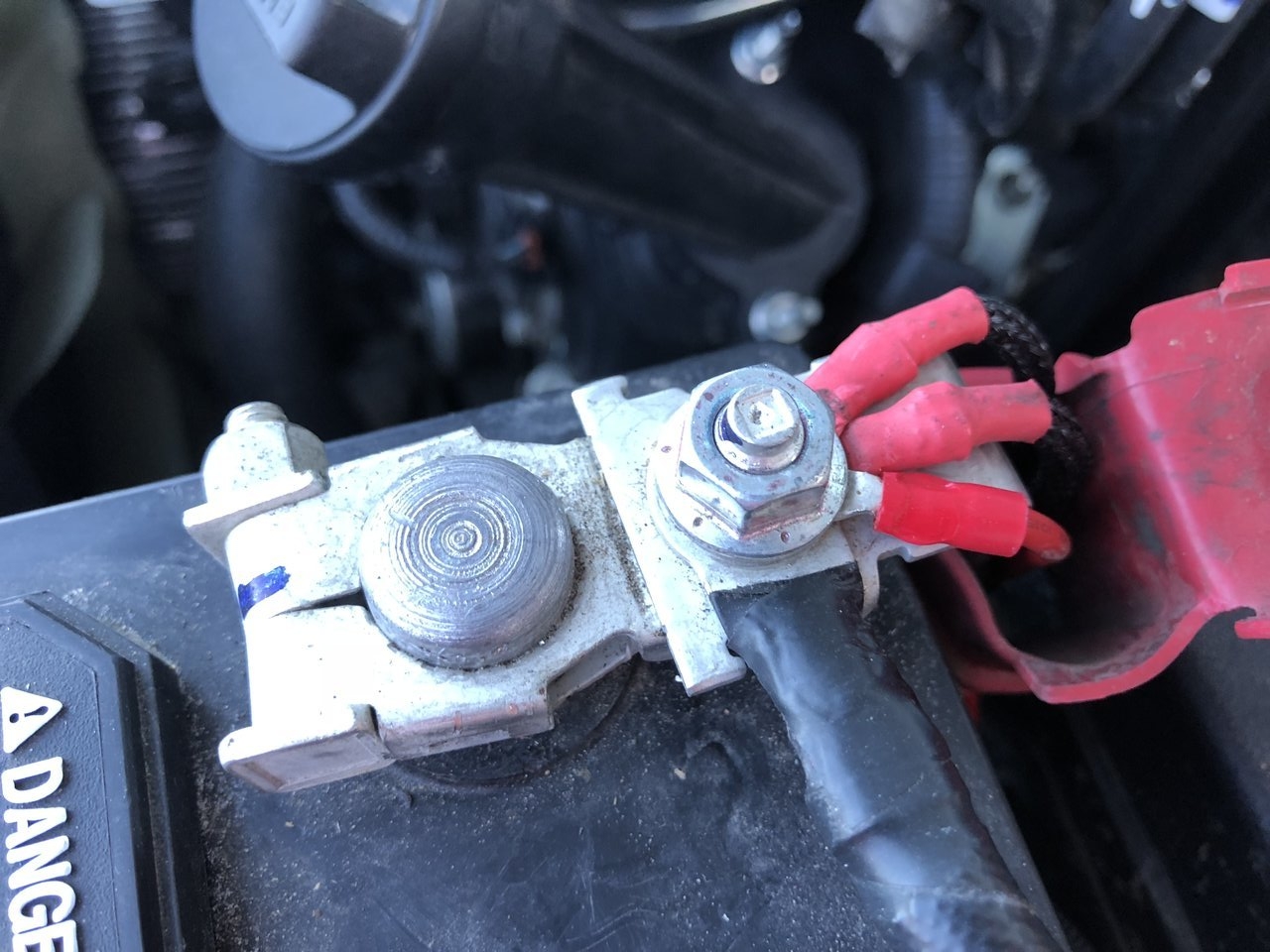

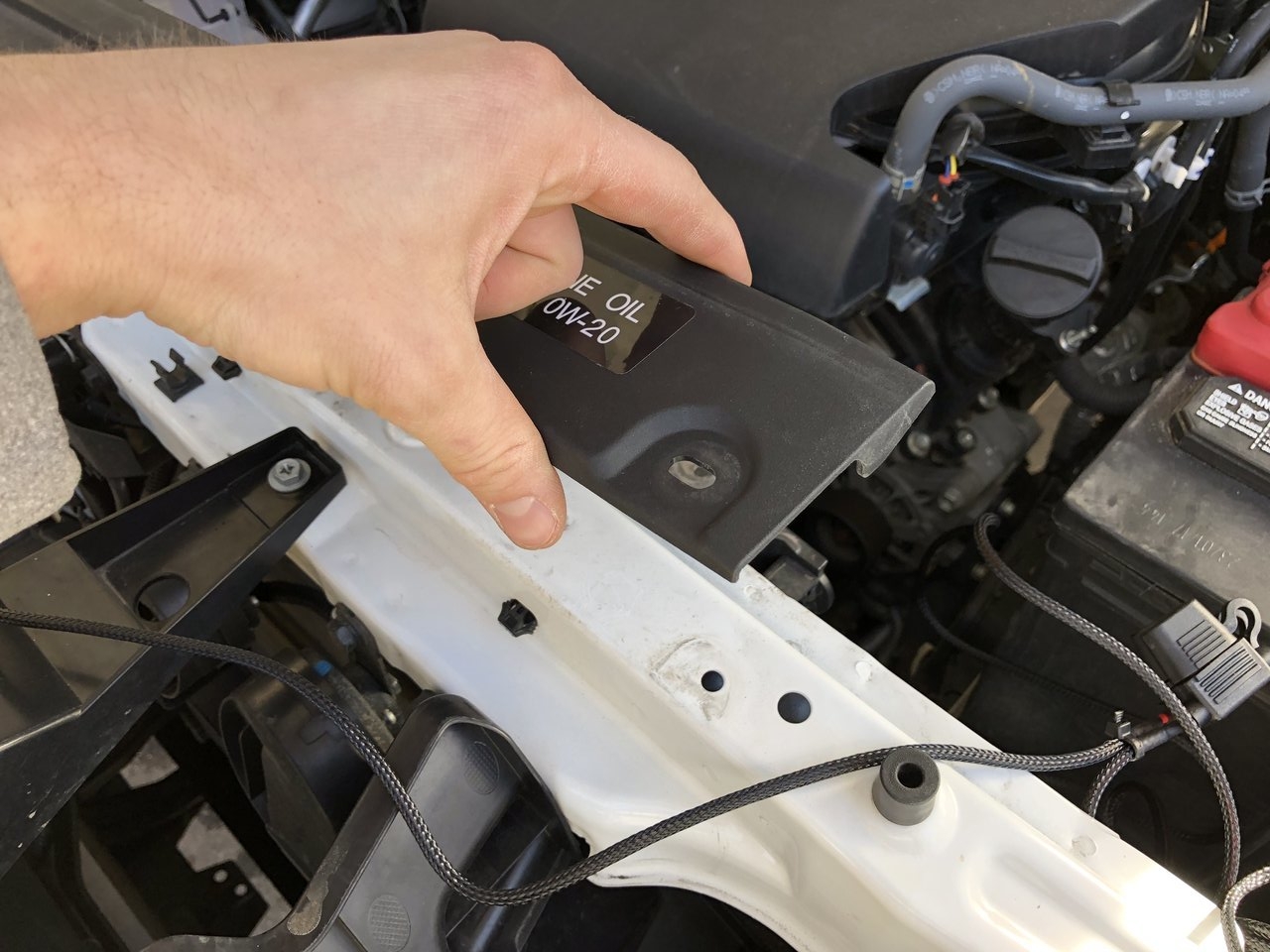

    Then I attached the positive leads to the battery and ran them around the battery:

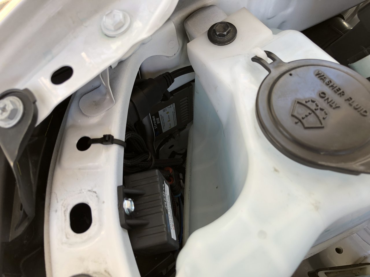

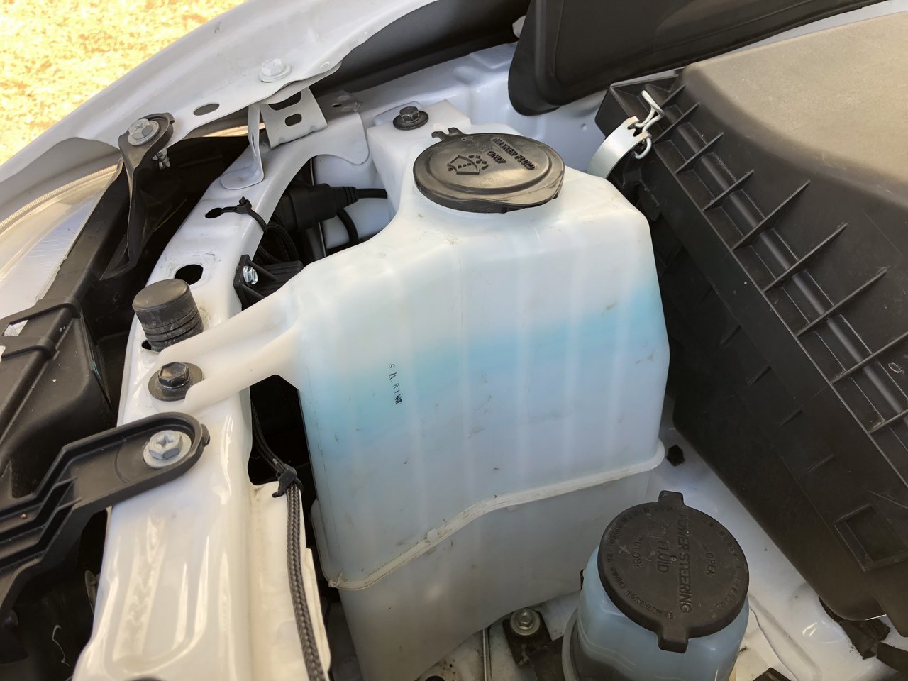

    Next I got the negative leads bolted down to the factory grounds on each of the headlights respective sides. (I pulled the windshield washer fluid reservoir to make this install easier)

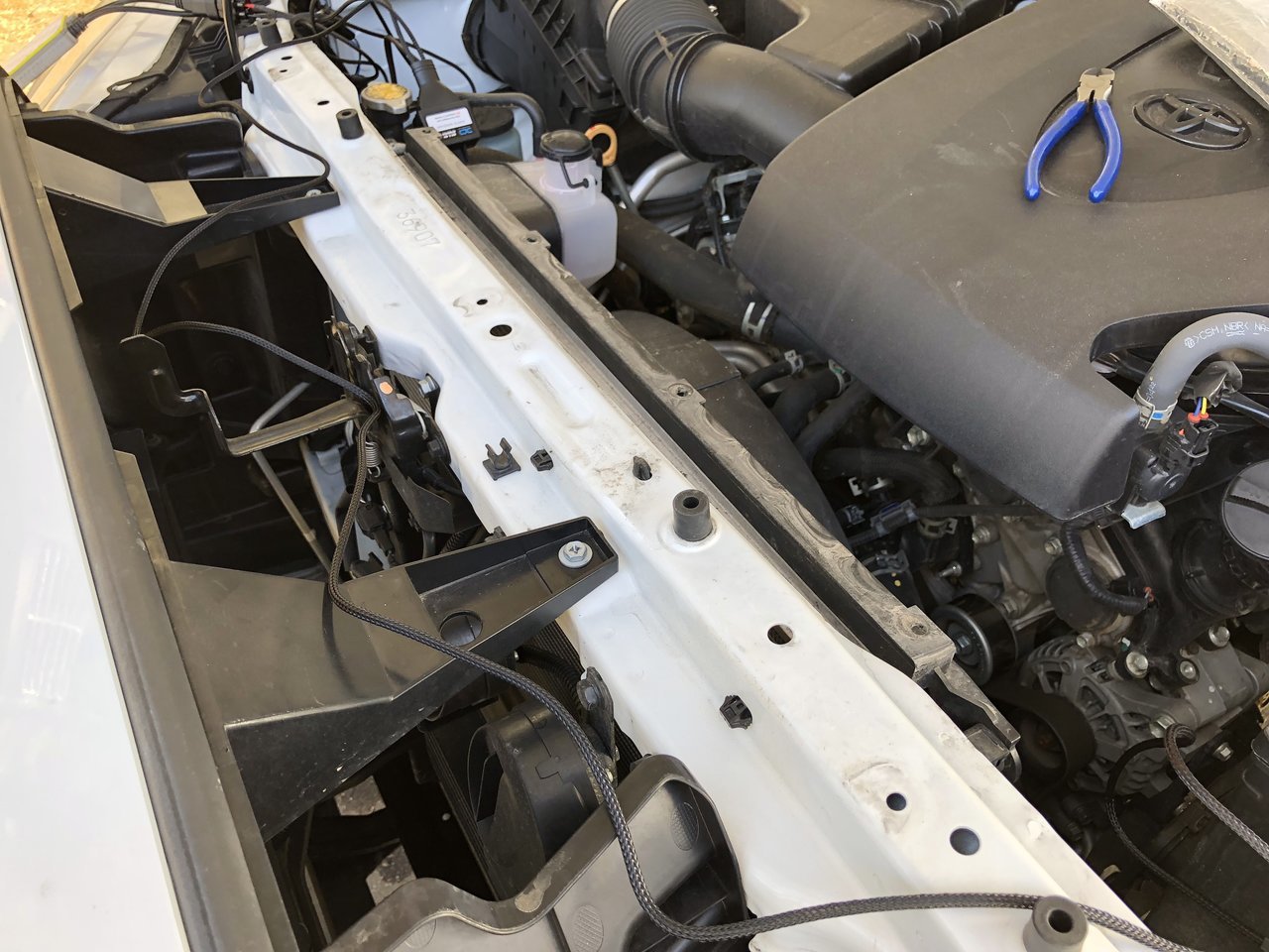

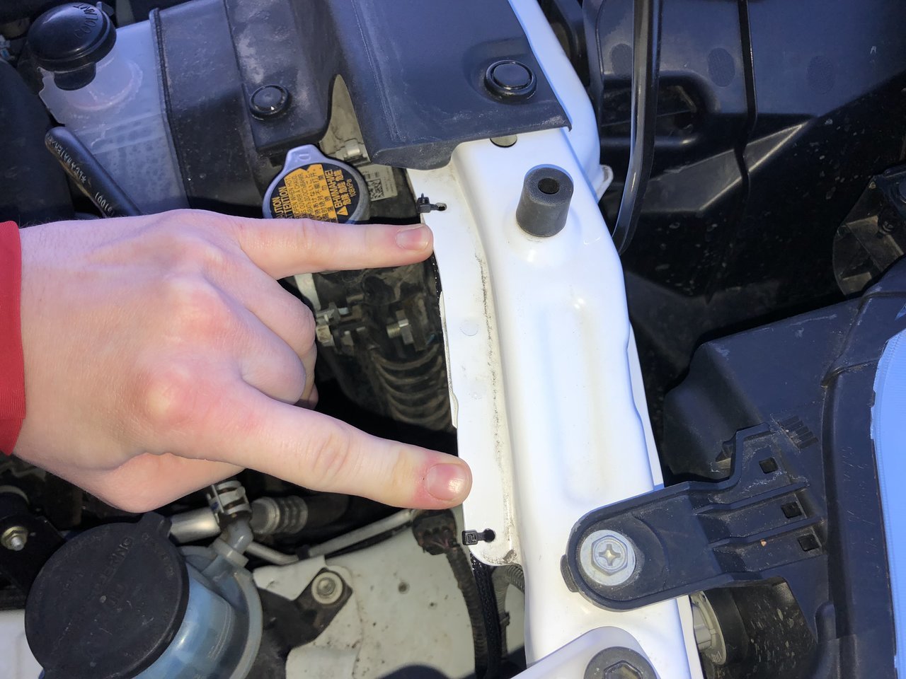

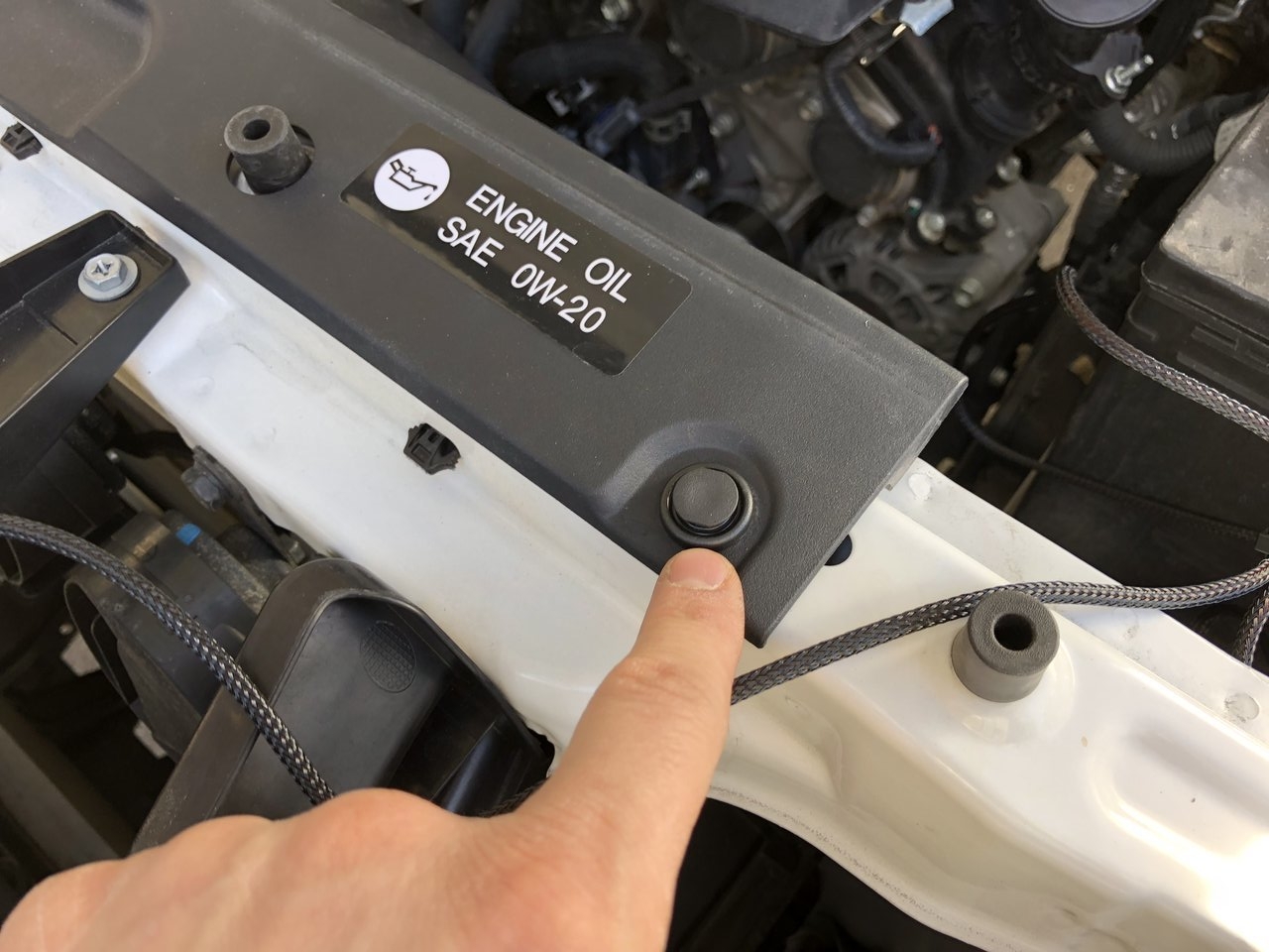

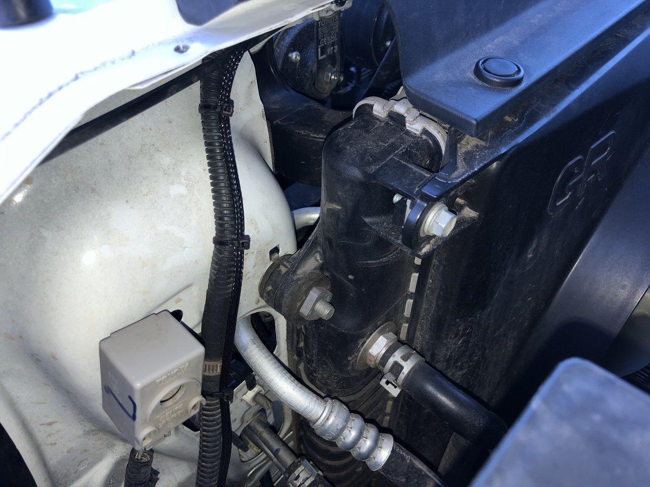

    To make running the wires to the passenger side easier and cleaner, I pulled the black plastic cover on top of the radiator by removing the seven small clips with a flat head screwdriver.

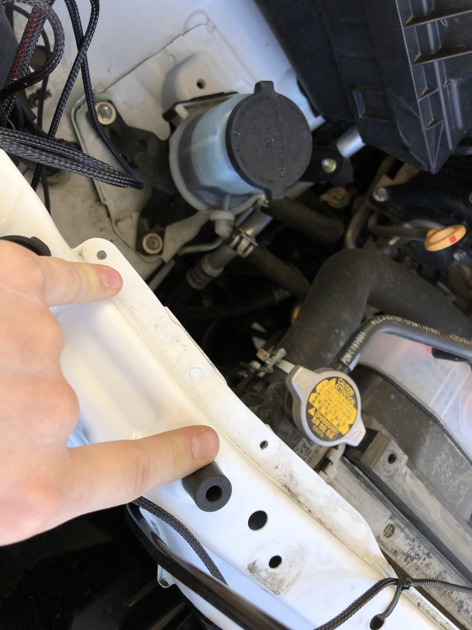

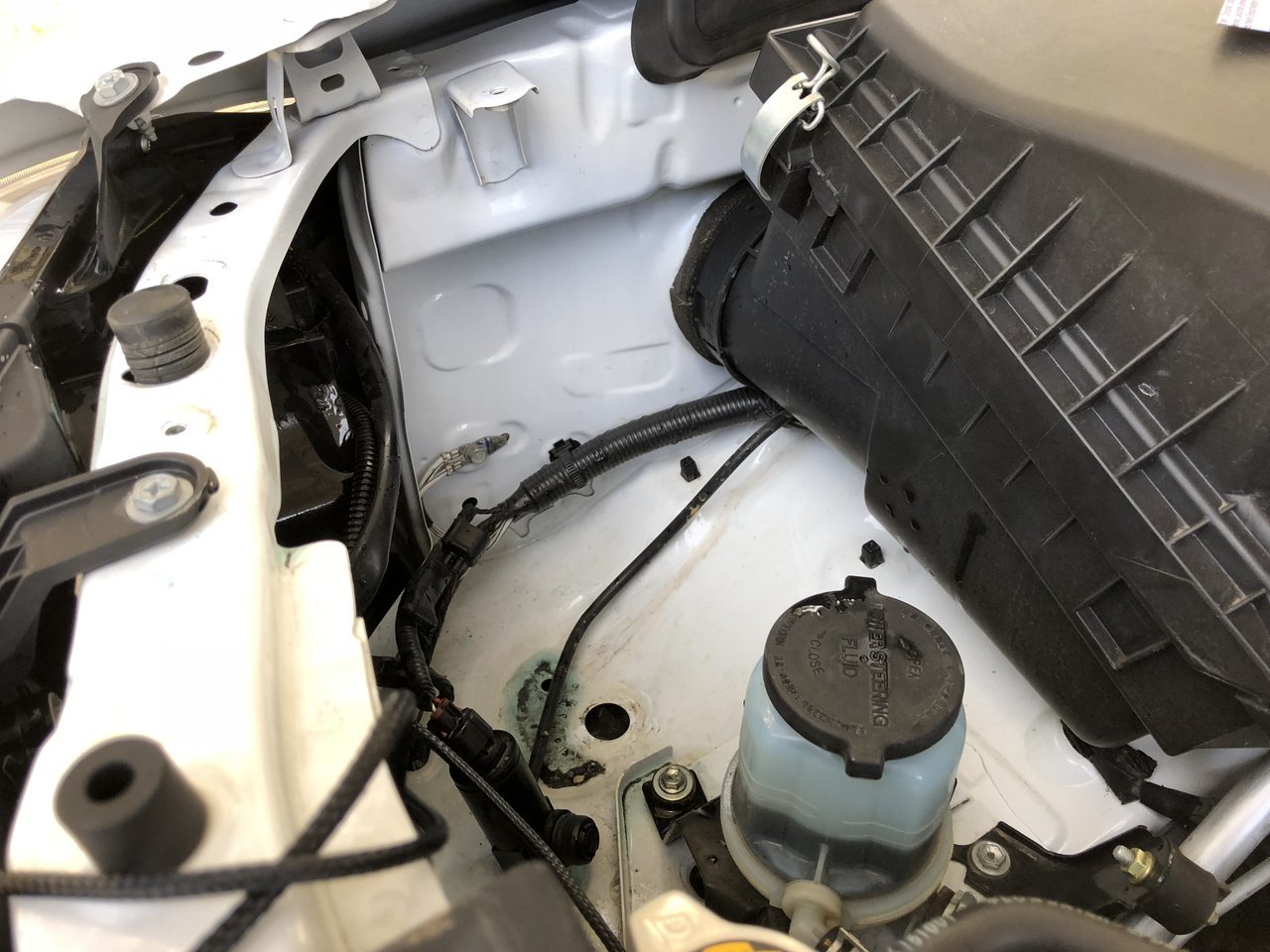

    One the passenger side I drilled two small holes to run the wire along the top and zip tie it up and out of the way. Hindsight is 20/20 and looking back at this, its likely not necessary. There is a small harness that run the whole length to the other head light that I overlooked. Do what you please.
    Passenger side positive lead line run up factory harness to passenger side headlight.

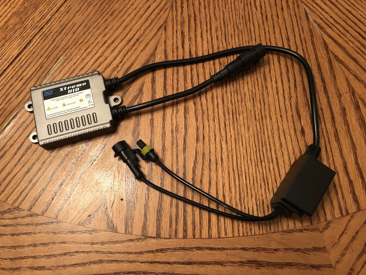

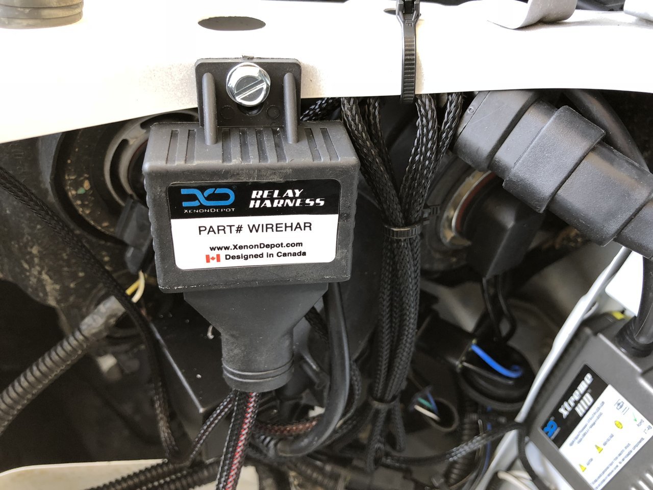

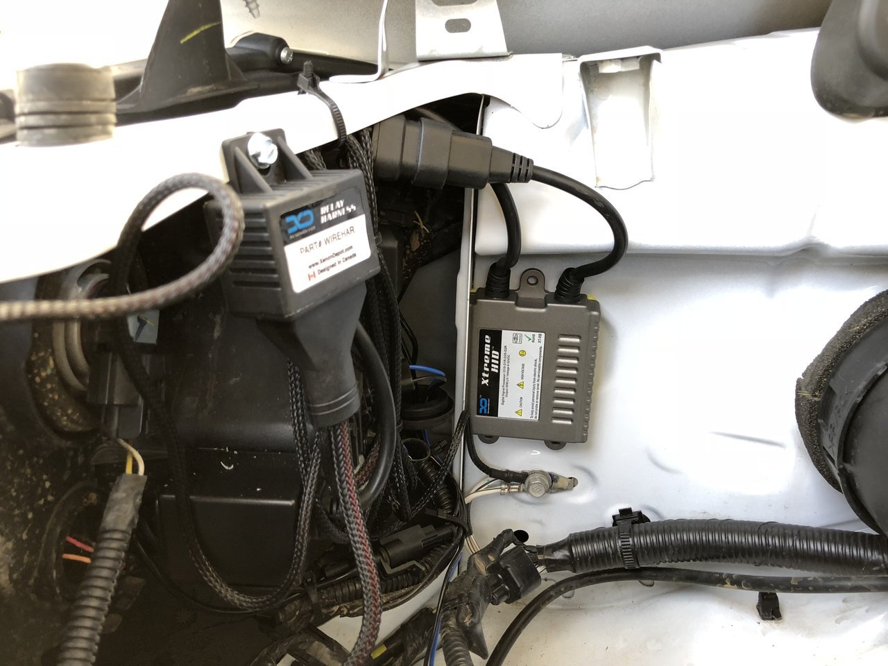

    After that I got the ballast and the harness mounted. The ballast is mounted with the provided 3M tape and the harness I mounted with a small self tapping screw.
    I got all the wires on the passenger side all bunched up as best I could and reinstalled the windshield washer fluid reservoir. (Again, I will be redoing this as I am not entirely happy with the cleanliness)
    Once the passenger side was complete, I moved back over to the driver side to get things cleaned up and was much happier with how all of this got tucked away.

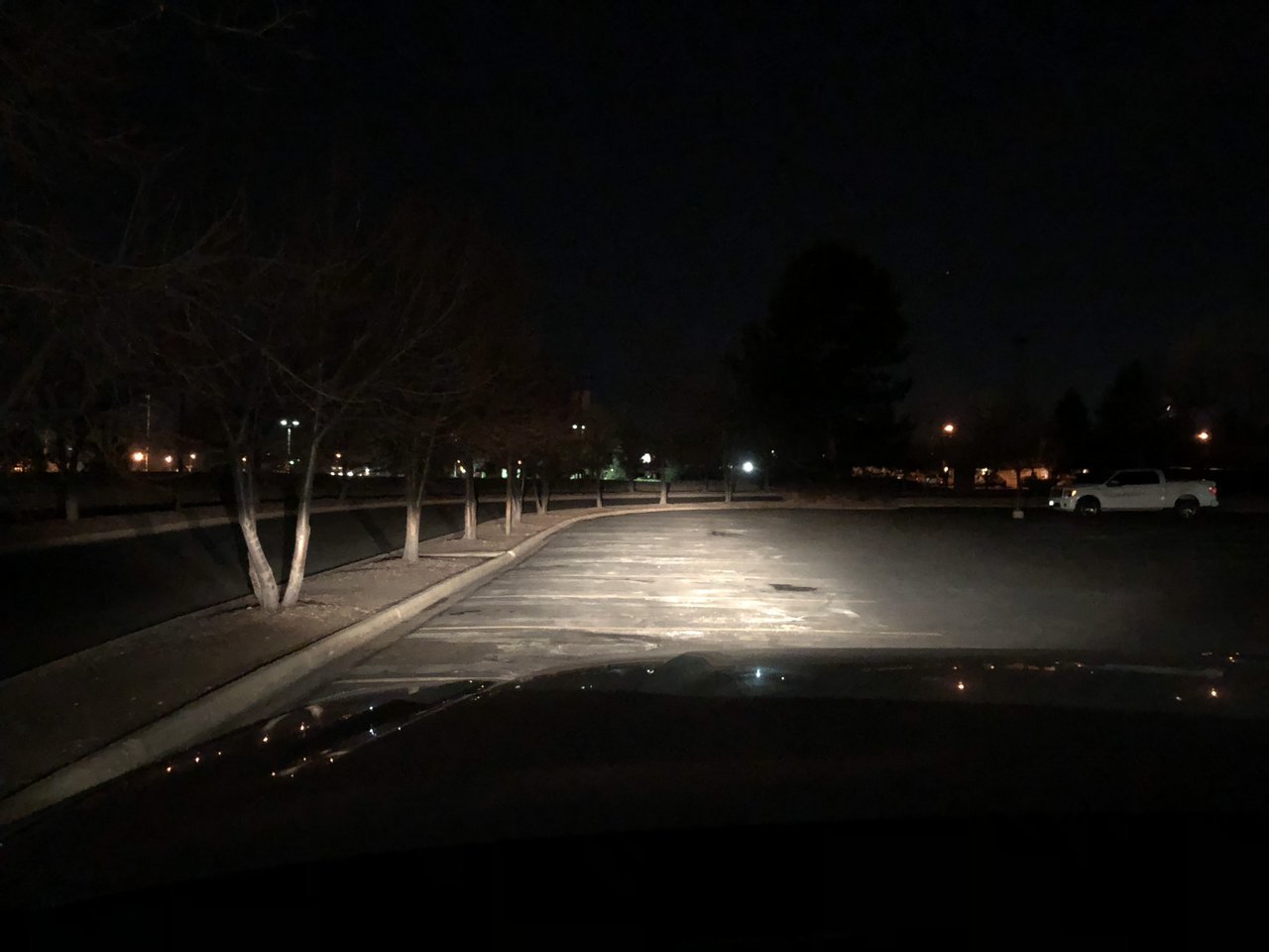

    COMPARISON TIME!
    Headlights only: STOCK
    Headlight only: HID
    Headlights+Fogs: Stock
    Headlights+Fogs: HID
    HIDS only:
    HIDS+Fogs:

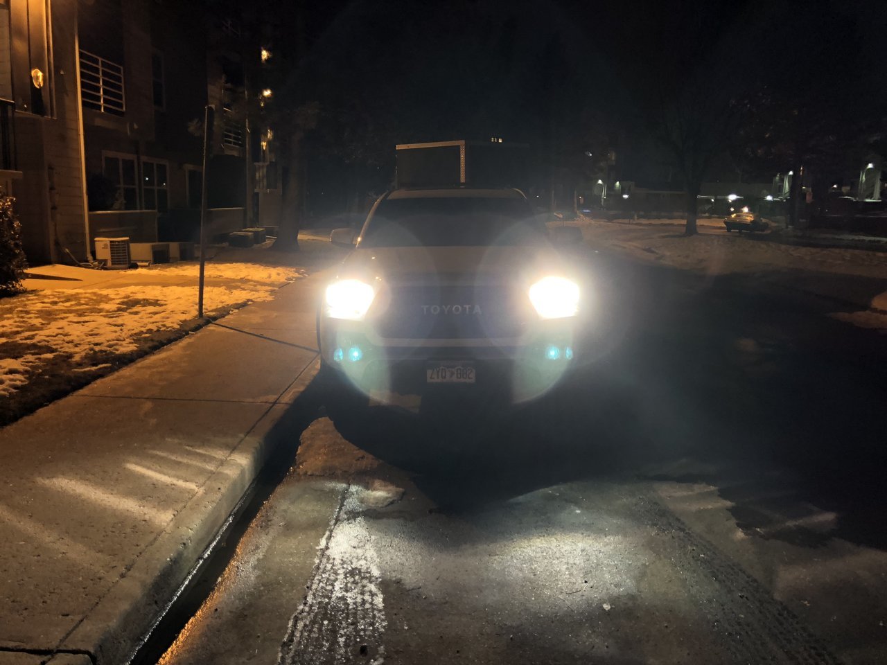

    HIDS+Highs:

    The harness is an insurance policy, im not taking even the slightest chance of frying my electronics in a $40k truck
