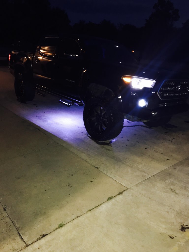

    Looking for advice/input on ways to wire side led lights so they come on with dome light or cargo lamp

    2016 TRD off road 4x4
    3"x1” leveling kit 20” Wheela 33” Trail Grapplers LED lighting upgrade Ridgid Ditch lights & 20”bar Doors- JL composites & coaxals Subs- JL 8”w3’s Amps-JL Xd400/4 &Xd300/1 Paint matched grill & fender flares LED Accent & step lighting 5% tint
    Got the light bar, strobes, ditch, accent, and running board LED's install finished up
