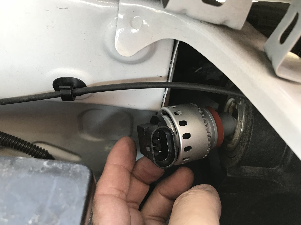

    Tried installing a LED (3.8 inches/96mm) on the low beam and found out that it didn’t fit because it was too long to get around the tight angle behind the low beam socket. As you can see, LED with a fan on the back makes it too long to get the bulb in. I tried every angle to get it in but couldn’t. So anyone looking at a LED conversion should make sure it’s not too long. 187E7619-4DE6-4C44-81E3-64466E2CBB3A.jpg

    Which bulb was this ?
    I read somewhere.... this thread ? A vendors blog ? I don't recall but somewhere :rolleyes: someone mentioned the possibility of having to loosen the light and tip it out a bit from the top to get access. I was very happy when I found I did not have to do that to install my Auxbeams.
    Yours is close, almost looks like you could "tip" it in there, but I'm sure you tried every angle. Maybe try to loosen up the light at the top ?

    I had the same issue with these in my wife's 5th gen T4R
    https://smile.amazon.com/CougarMotor-Headlight-Bulbs-All-Conversion/dp/B01H6NZ7D8

    By returning them. Honestly, I tried Cougar Motor and Beamtech LED's to see if there was an easy, cheaper solution to going HID. I figured if I was going to do much more than swap a bulb, I'll just go with the Hylux Tech HID kit. I decided to simply go HID for the low beams on both my wife's T4R and my 18 DCSB OR.

    They were Racbox, but also goes by the names of Safeco, LED 7s, and many other. But I am fine that it didn't fit because I can return them. Especially after read so many reviews about how noisy the fans are I decided to look into fanless LED. I really don't care if the LED are not too bright. As long as they are 6000-6500k. I generally don't drive too often at night and I tend to leave the fog light on anyway. Just want the low beam light to match as close a possible with my fog.
