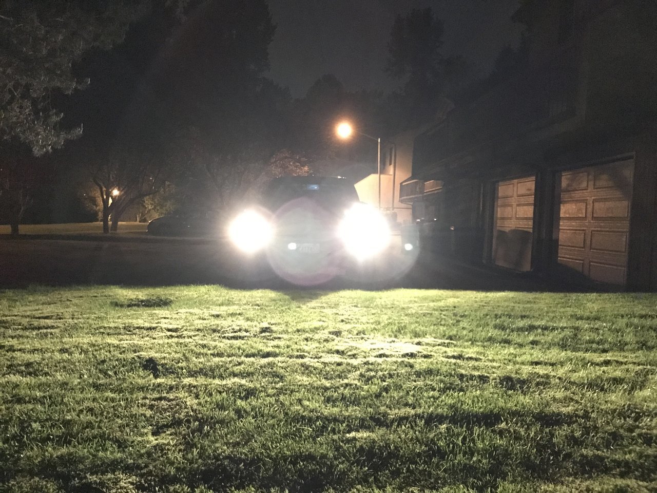

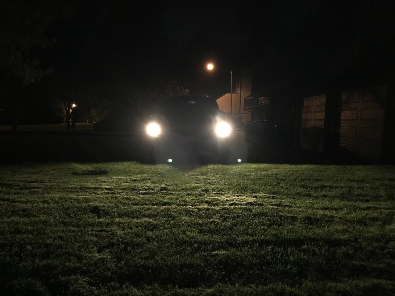

    Lighting is deceptively hard to photograph. I've had plenty of experience. Those photographs are in no way remotely comparable for output comparison.
    Look at these photos:
    Which light is brighter?
    They are the exact same lights, photographed from the same position, seconds apart, with the same camera but the point of focus was slightly different. They are identical. This is why I do all my light comparison testing side-by-side at the same time. If 2 separate pictures of the same lights, at the same point, at nearly the same time, with the same camera can vary that extensively, then different lights in different locations, taken at different times with different cameras has so little meaning it is worthless for output comparison.
