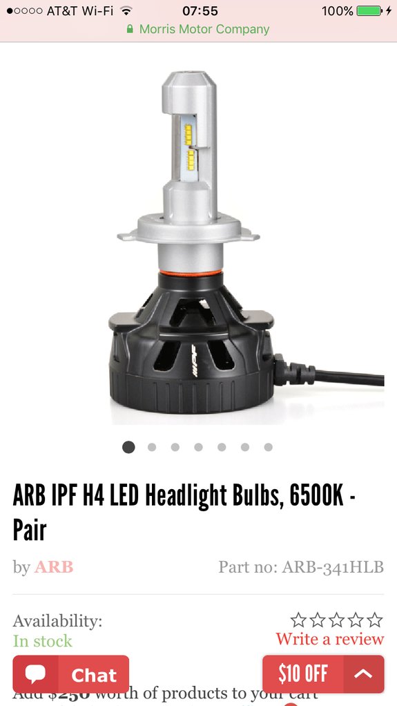

    IMG_3103.jpg I've read some reviews and saw a couple videos and these are the closest ones I've seen to a halogen pattern but at 250 a pair I'd hate to find out they really aren't that much better

    Yes, I've seen also that kind of "reviews" for many different LED bulbs. Internet is a whore and take anything for granted.
    Put your money where you mouth is. Show the wall pictures.
