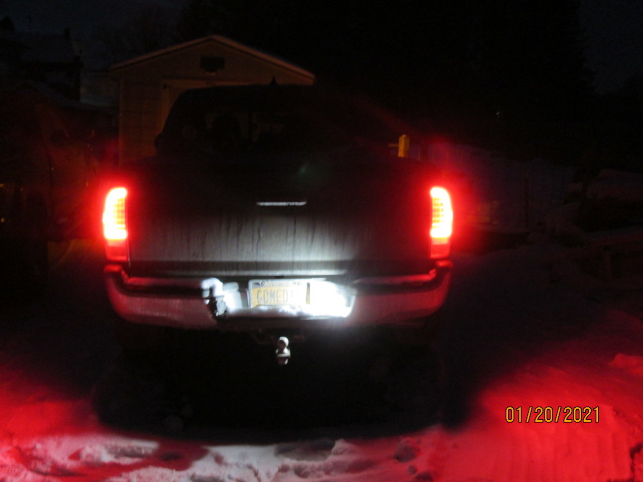

    IMG_4271.jpg Another option if your bulb issue isn't resolved - I replaced my one license plate light with a LED unit that is insanely bright. The light on the other side was replaced with a tow harness plug.

    I like those. I put LED's in place in my housings but every few months they start to flicker and I have to replace them. Got a linkie or website?

    Central NY
    2012 DCSB TRDOR
    I got mine from Amazon. They're about $12-$15 for the pair. I've had them almost 2 years without any issues.
