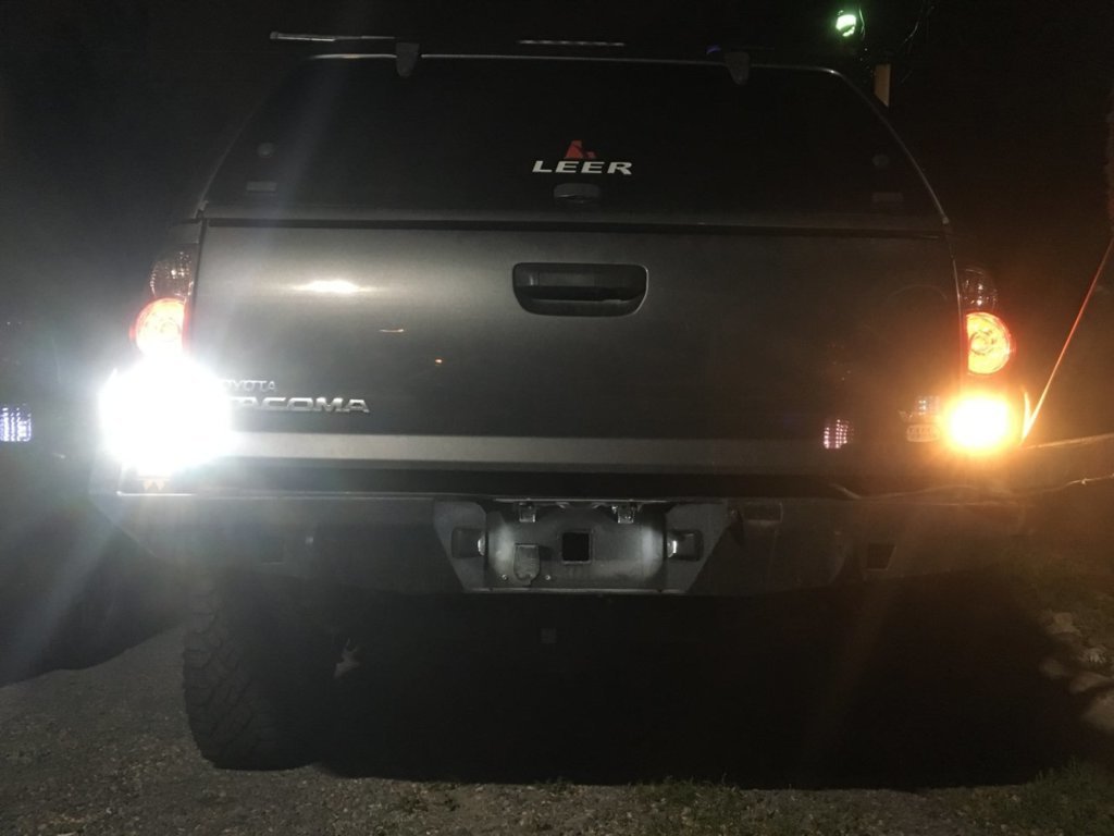

    Personally I wired in tail-as-turn modules from diodedynamics.com to utilize my running lights/brake LEDs to work also as my turn signals.
    I plan on getting some white LEDs to put in place of my old turn signal bulbs and splicing them into my existing LED backup lights to have more light output when backing up, but I haven't gotten around to it yet.
    But as far as quality LEDs go, I would recommend vleds.com (pricey, but they're worth it). Or superbrightleds.com for something more economical. There are also some suppliers on here if you look around, can't remember who they are though.
