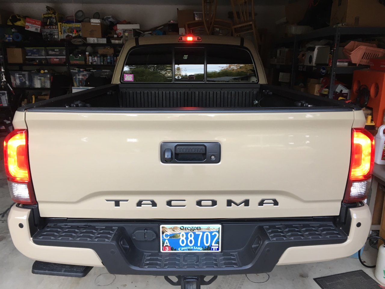

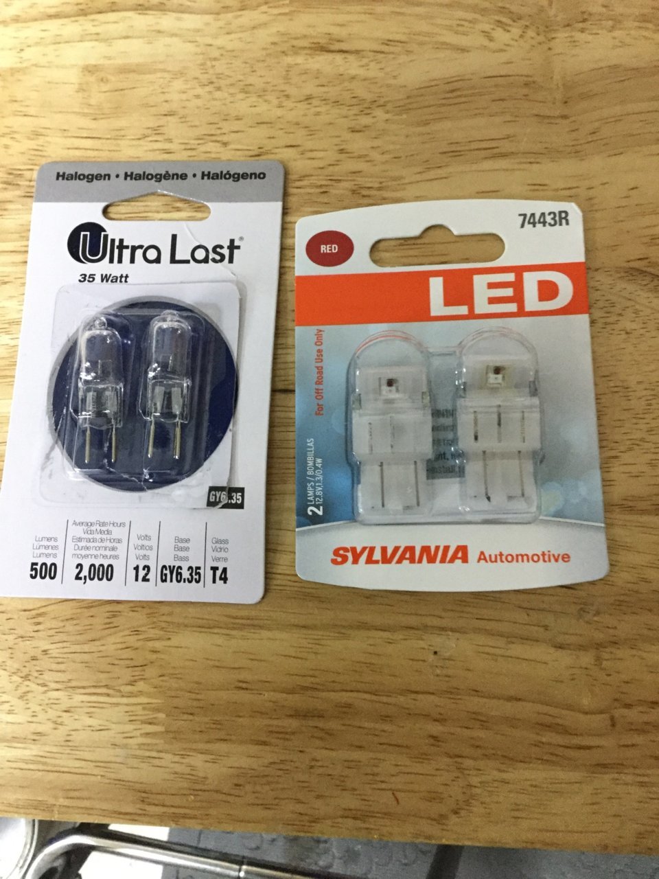

    Welcome to the forum fellow Oregonian! I went with Diode Dynamics Tail as Turn mod as well as using led bulbs in place of the incandescent bulbs from the factory. Had to add resistors to eliminate hyper flash.

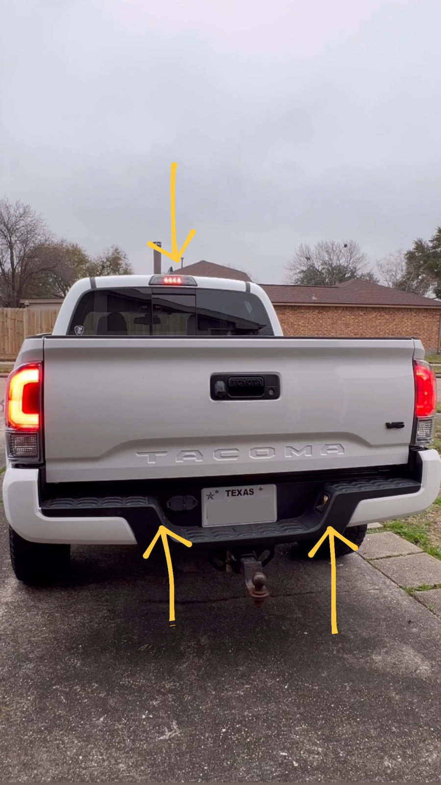

    Hate to bump an old thread, maybe someone can be of assistance. Has anyone had any issues with the lifespan of the VLED’s?
    Trying to eliminate a bulb issue, bad ground and or trailer harness module issue.
    As of now all my fuses are good, my issue is all my running lights (front and rear) including license plate lights turn on when I hit the brake pedal.
    When I turn all my lights on, all the brake lights and the 3rd up top stay on as well.
    Kind of stumped at this point. Hoping someone can help.

    Haven’t had any problems like that at all. Are you running the VTAIL kit? And this only started recently?

    My go to first thought when weird stuff like that happens is an open or loose ground. It might be in the tail lights, but it doesn't have to be just there.
    I would start by disconnecting the LED tail lights and seeing if that corrects the problem.
