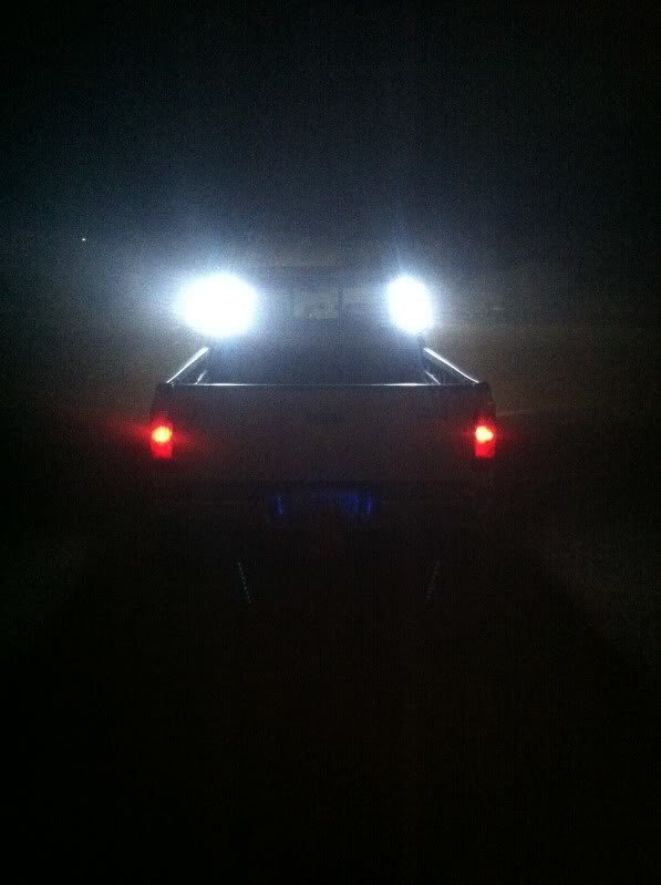

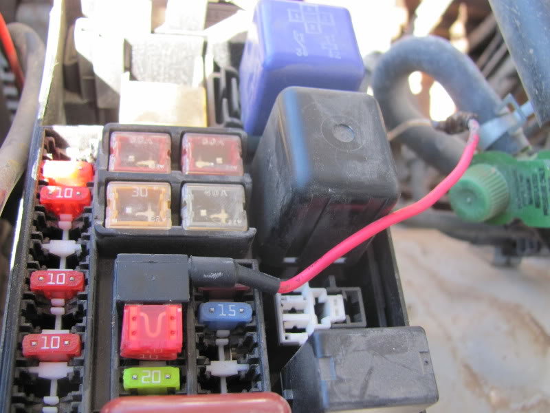

    the best way is to go back to the the battery. i did what ^that guy^ said. heres some pics of my bedlight mod
