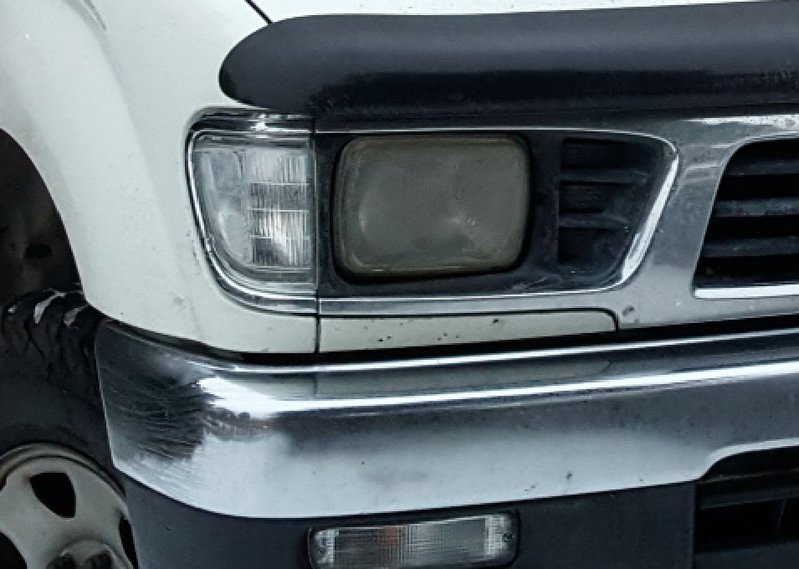

    DD Deck+backup camera, LED DRL, All LED except H4 Hella
    I will have to do it, as they already have some small rusty spots :). I guess the paint chipped from road rocks.
    BTW, the headlight is not fogged out, it is how it looks after driving across Poland in winter:eek:. It's all clean now:cool:

    The left one wouldn't pass here (the right one either) - it's shooting light all over the place :eek:. I have Autopal H4 Euro style (with Euro legal cut-off), and set of Hela H4 (also Euro) still in the box. All cars here have to pass full annual inspection (not just smog, like in Cali). They even test shocks - I haven't see it anywhere before. No way to to put HID or LED in reflector housing. BTW, if car has HID it also has to have auto leveling system and automatic cleaning system (spray and wipers). HID bulbs behind dirty glass gives to much glare.
