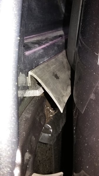

    Guys it's not only the drop window, I recently installed a ARE z series 2 months ago and it leaks like crazy. I've been back to the dealer 3 times and they said the cab side bed rail cap allows water to flow in. The next step is to take shell off and remove rail to lay a bead of silicone across the whole rail. Not sure if this is the answer but it's the first step. I have a carpeted shell and it gets completely soaked along both sides of the bed rails. Frustrating!!

    The dealer did a water test with the hose running down between cab and shell mostly on the drop down window and it was running through the rail into the bed. I just can't imagine if that's the only spot since the carpet is wet but who knows. I saw another thread where a guy made a flap to direct water away from the drop down window. Looked like a giant mud flap. I'll try to find it and post. Hey nytaco where in Rochester are you. Just noticed that and I'm there as well.
