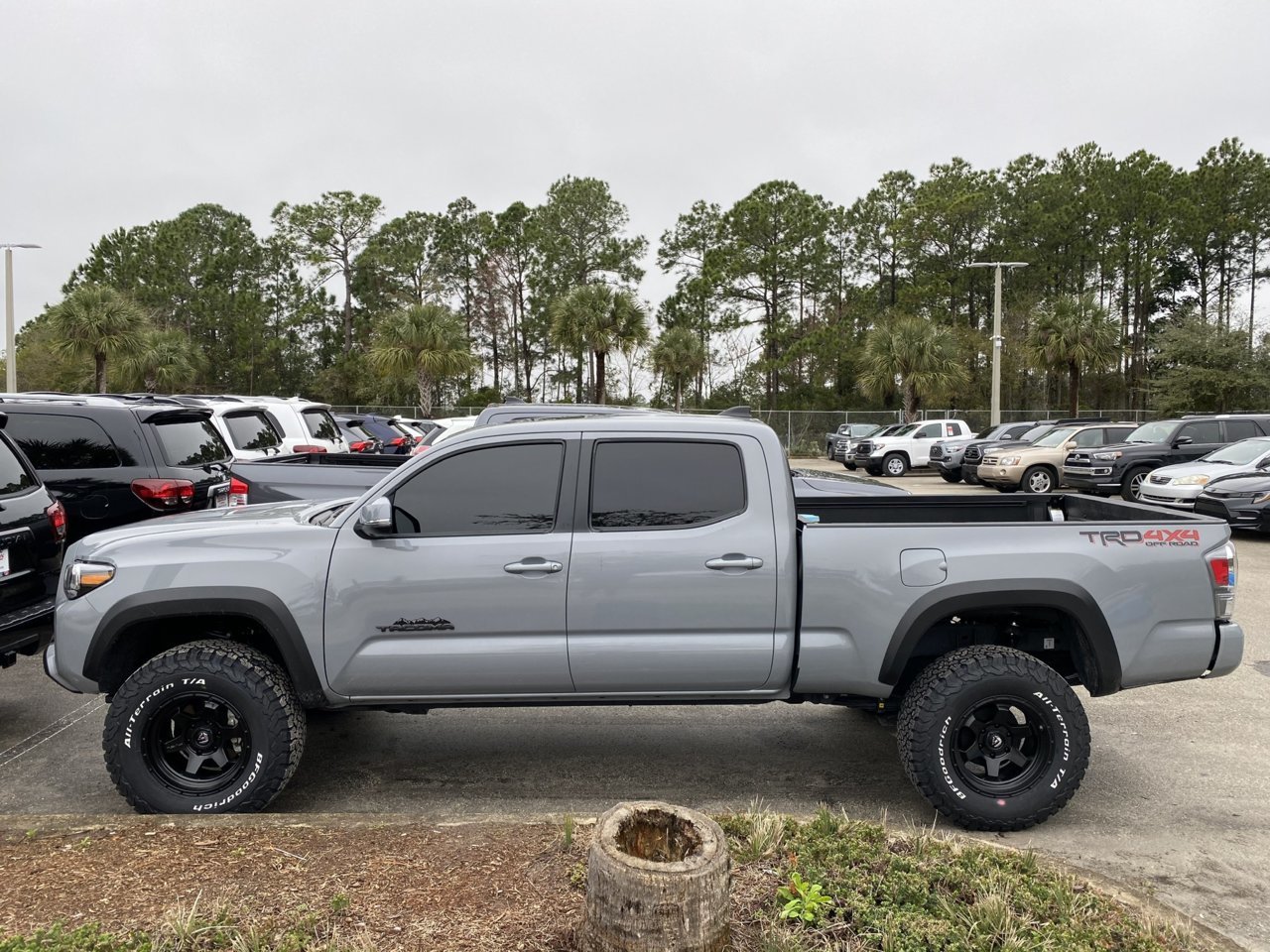

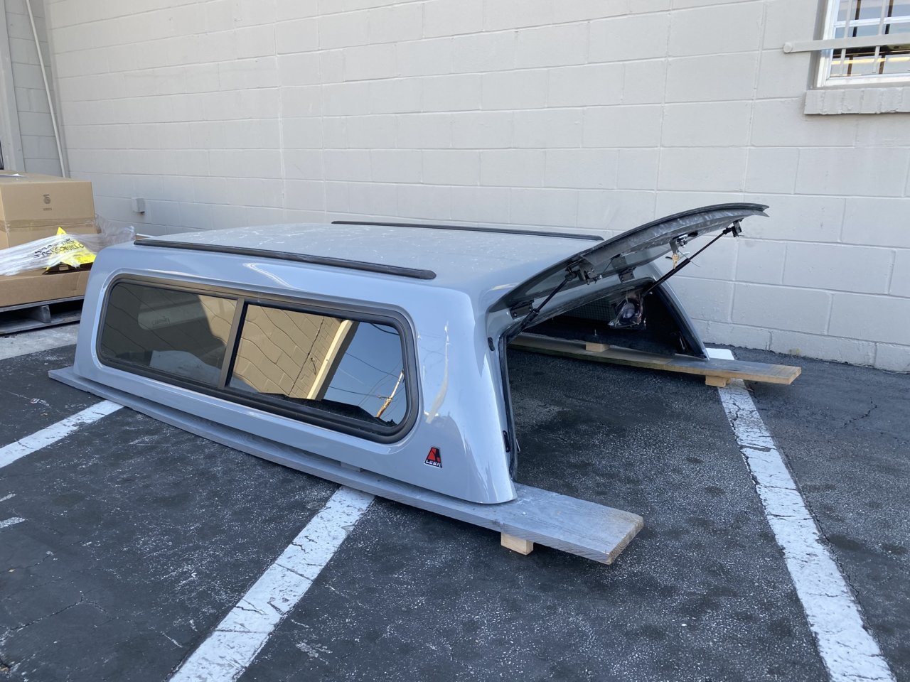

    Leer xr just arrived for 2020 taco LBOR... plan to keep my Malinois and gear inside when temps permit. Dealer doesn’t seal up as says needs to drain but having never had a topper have heard the complaints of everything getting covered w dust etc. other than obviously around tailgate what other areas should and how need to be addressed. Thanks!!!

    Any advice apriciated. Ordered tailgate lock actuator from R4T

    Had a topper on my 12, don't have one on my18. But most dust comes in at tailgate. Get tailgate seal, foam tape on front bed panel. Does Leer come with seal already installed, for bedrooms? My ARE, did but I added another. Also seal rail caps @ bed front cap that's where water can get in. I also sealed bed cubby drains, dust comes in there also.

    I went through this same thing, having installed a Leer 100XR a week after getting my 2021 Tacoma. I did the following things in preparation:
    1. Installed Total Chaos bed stiffeners.
    2. Got the wiring ready. I didn't want the cap installers tapping into my new truck wiring, so I got the Leer kit that uses the 7-pin trailer connector as a source. (It plugs in behind the rear bumper, with the 12-volt hot lead running directly to the battery.)
    3. Waterproofing. I pulled off all 3 bed caps and put lots of silicone sealant underneath. Also installed the OEM rubber plugs for the front corners of the bed ($30 each, and this requires notching the bed caps). Also put plugs in the three 5/16" drain holes in the front of the bed, and the two in the storage cubby. The other holes in the storage cubby are still a problem, but I'm working on that.

    Uses a bulb gasket (this may vary with the dealer). Most of the leakage comes from below, with water splashing up between the outer fender and the inner bed. That's why it's important to seal under the bed caps. But don't block the holes at the top of the fenders (because the bed caps clip into those holes, and water needs a way to drain out harmlessly). Seal inboard of the holes.
