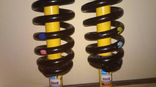

    Ok so I got a 2014 trd sport. Got a lift from Les schwab... Ya I know a dumb idea.. Later I decided to fix my dumb idea got ome 885 coils for front with ome shocks. This is their fancy work..
    173/cat/500][​IMG][/url]
    172/cat/500][​IMG][/url]
    Fukers be warned!

    885s and stock shocks are not gonna work together - especially with that spacer.
    Take it back, put the stock stuff back on before something fails.

    Um what? He said he bought ome 885's and ome struts.

    ya got 885's with 90000 sports now not the stock shock lol. I'm not that dumb lol! Well I did let les scab put on a lift so....:mad:

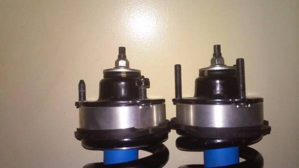

    Thats just nasty right there. Those coil spacers are about the worst lift you can get. Good to hear you did right changing over to OME coils/struts.
    Saw a guy running this setup the other day and he had flared fenders and prerunner bumper which made him look like even more of a dumbass :D

    I think those pictures were of the "spacer lift" that LS originally put in. First, it is all wrong. ALL wrong. Spacer in the wrong spot. Extended studs only on one side? Coil isolator is wrong.
