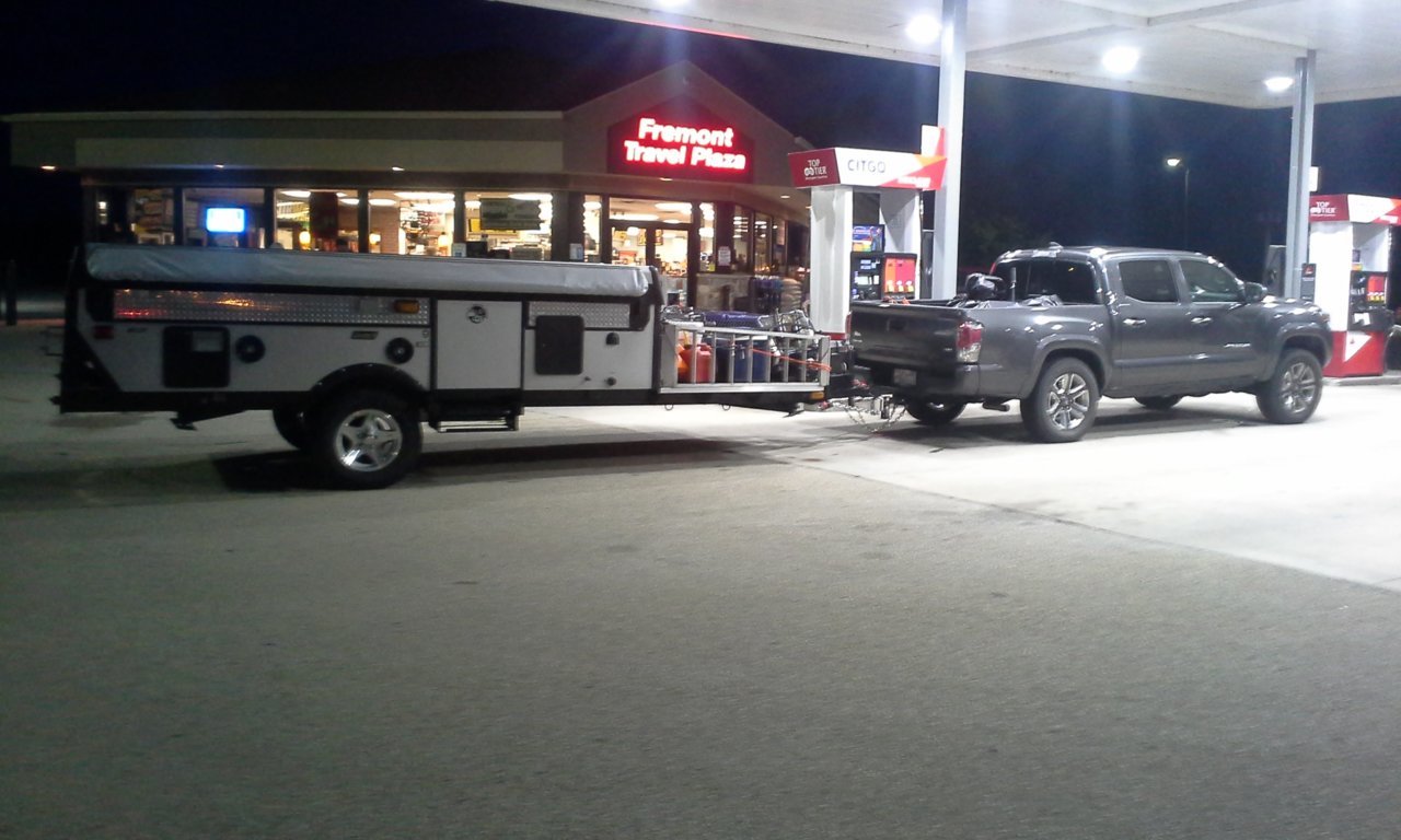

    One trip up north Wisconsin, 265 miles,
    Around 4000 lbs. Weight distribution hitch, electric brakes. 2018 limited built 1st week of August. Used s4 most of the way. Truck would shift down into 3rd 2 to 3 times on a long uphill. I traded it for a trunda. Can you do it? ya sure. I didn't feel like the truck was liking it.
