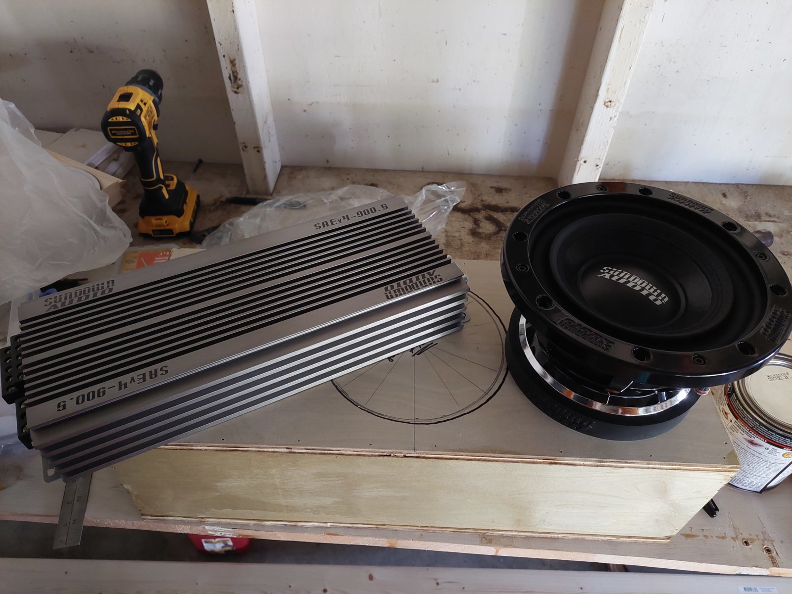

    Next evolution of things... swapping two Kicker Comp C 8s and a 43CX6005 5-channel for a single Sundown SD-3 8 and SAEv4 900.5 5-channel. Should put a bunch more power to the front components (ID65CS) and rear coaxials (ID65) - 80x4 at 4 ohms with the sub getting over 300 wired to 2 ohms. Didn't need all the juice available at 1 ohm on the sub channel.
    Overall, just going for something that sounds clean and has a ton of headroom.
    Box is just a simple sealed birch plywood rectangle that should be about .5 cu ft with sub displacement (22x9.5x6.5)... tucks right in below the rail on the back cab and leaves the childseat anchor in place.
