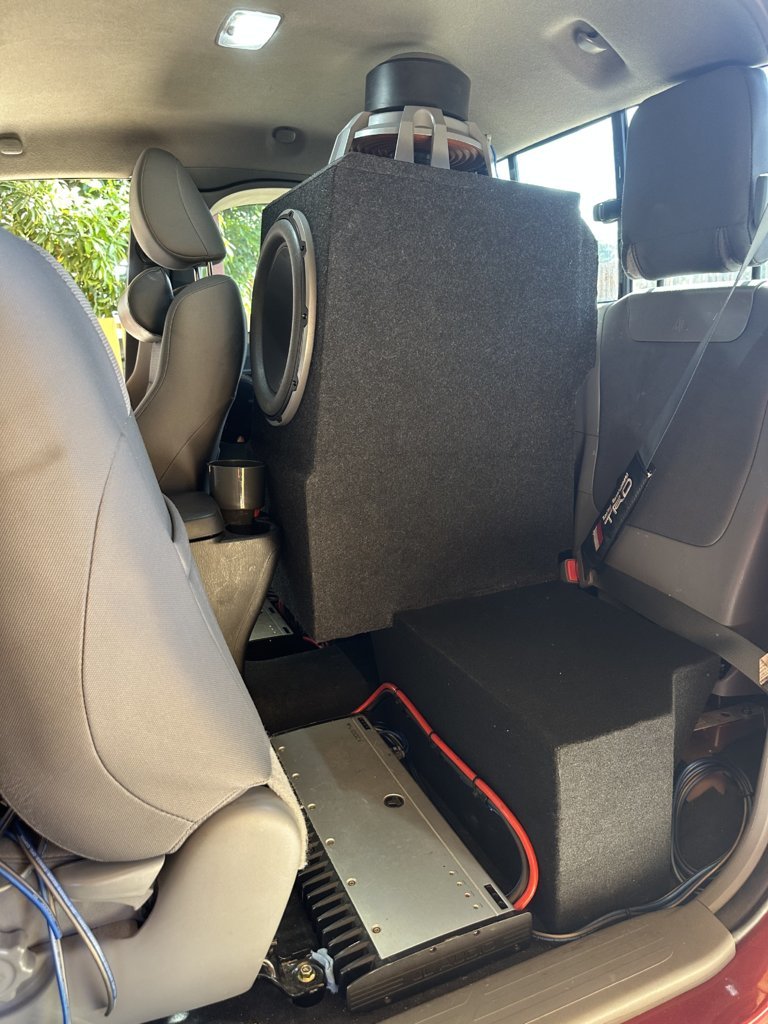

    Felt like I needed more bass (never seems to be enough)… just so happens that the Kicker 10” L7T loaded box fits pretty perfectly right behind the drivers seat and already having a spare amp laying around that has a 500w sub channel, it was too hard to resist. Was originally looking at the JL TW3 wedge box to match the two 8” w3’s behind the back seat but I really didn’t feel like spending $700 on a single shallow mount sub. The Kicker was half that price which was much more appealing. Turned out great. Essentially doubled the bass output and being right behind the driver seat you can really feel those kick drums now. So as it sits now I have 2 8” w3’s in a ported box running 600w rms and a single L7T in a sealed box running 500w rms. Before this truck, I’ve only ever installed subs in SUV’s I’ve had. Never realized how spoiled I was. Although I think this truck sounds good now, I could easily get double the bass from half the power (and half the money) in an SUV. Pretty wild.

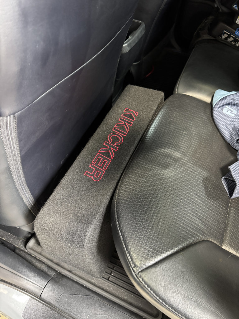

    Test fit was a success! Now to clean up this rats nest of wires.

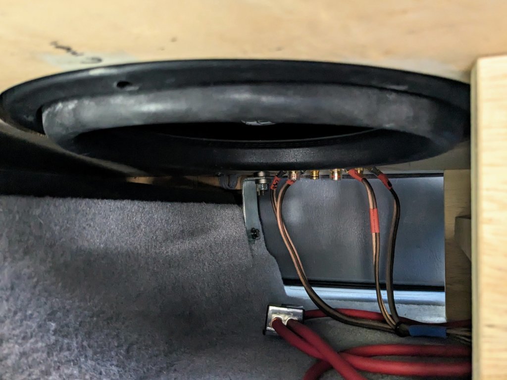

    Running 2 - Sundown Audio SA12's off of 1800W RMS. Enclosure is 3 cubic ft net and ported to 33 Hz with 1 woofer firing up and the other firing at the floor. The front and rear doors have Rockford Fosgate 6.5's off another amp, the head unit being an old iPad mini and Clarion EQ. Since this is my daily driver for 7 yrs now I wanted to retain the rear storage for the jack, etc and keep things fairly functional. All told the build was super cheap and everybody can have a good laugh at my horrific suede wrap job, my 80lb PitBull shreds it whenever she's in the truck anyway.
    And yeah, the cab doesn't have enough airspace to have the enclose work properly but when the passenger window is rolled down the bass will make your shirt ruffle and your vision go blurry. It tripped the earthquake gas meter at my house when I first turned it up.

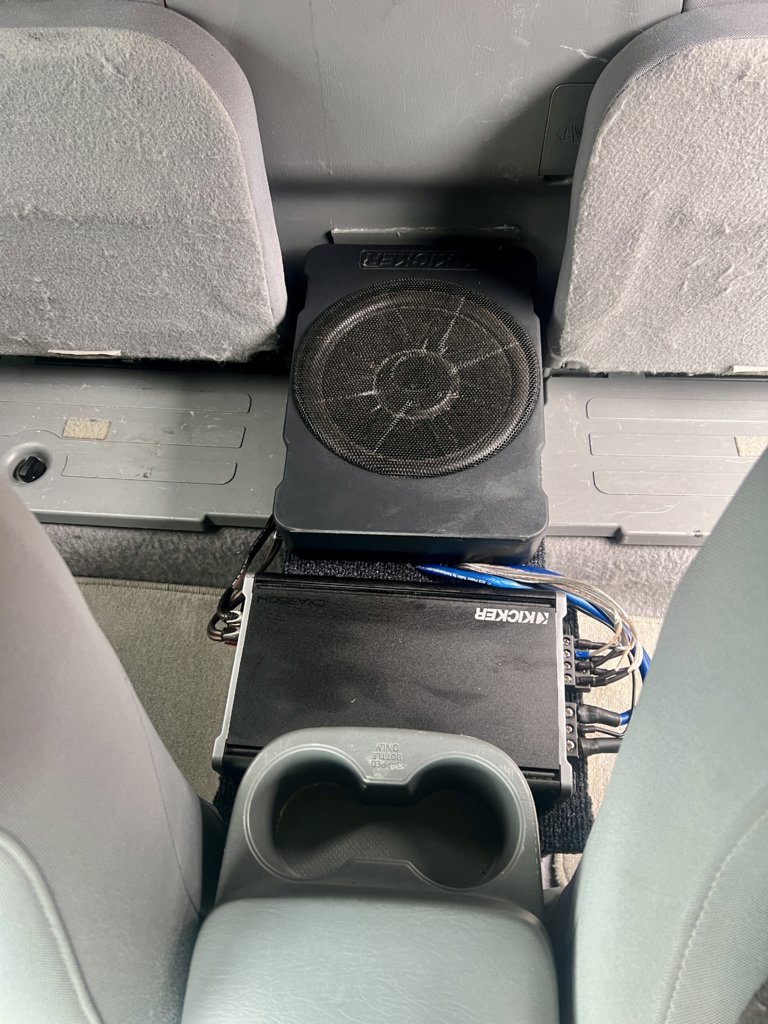

    I removed the stock subwoofer on the back wall and replaced it with a Kicker HS10 Hideaway.
    I wanted to mount it on the back wall, but I couldn’t come up with any ideas except a rear seat delete, which I plan to do in the future.
    For the time being, I removed the rear center console and built a small shelf for my amp and the sub.
    I’ve had it for about two years now and I’ll say that it is a well built product that can add a fairly decent amount of bass to your set up. For the size and price, i think it would be difficult to find something better.
    That said, proper sound deadening (100% KnuKonceptz Xtra Thick cld, ccf, Resonix barrier, lead block off plates, 3M Thinsulate, butyl rope etc) has really helped my entry level system come alive.
    Other than that, I have a single din Kenwood headunit and Kicker 4 channel amp powering JL Audio C1 6x9 components up front and 6.5 components in the rear.
    If I do anything in the future, I will likely upgrade the JL C1s to something better than entry level and replace the amp with a more SQ focused brand.

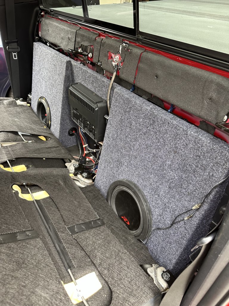

    Seats fold back to their normal positions and it doesn’t interfere with the subs. They sound greatIMG_8037.jpg
