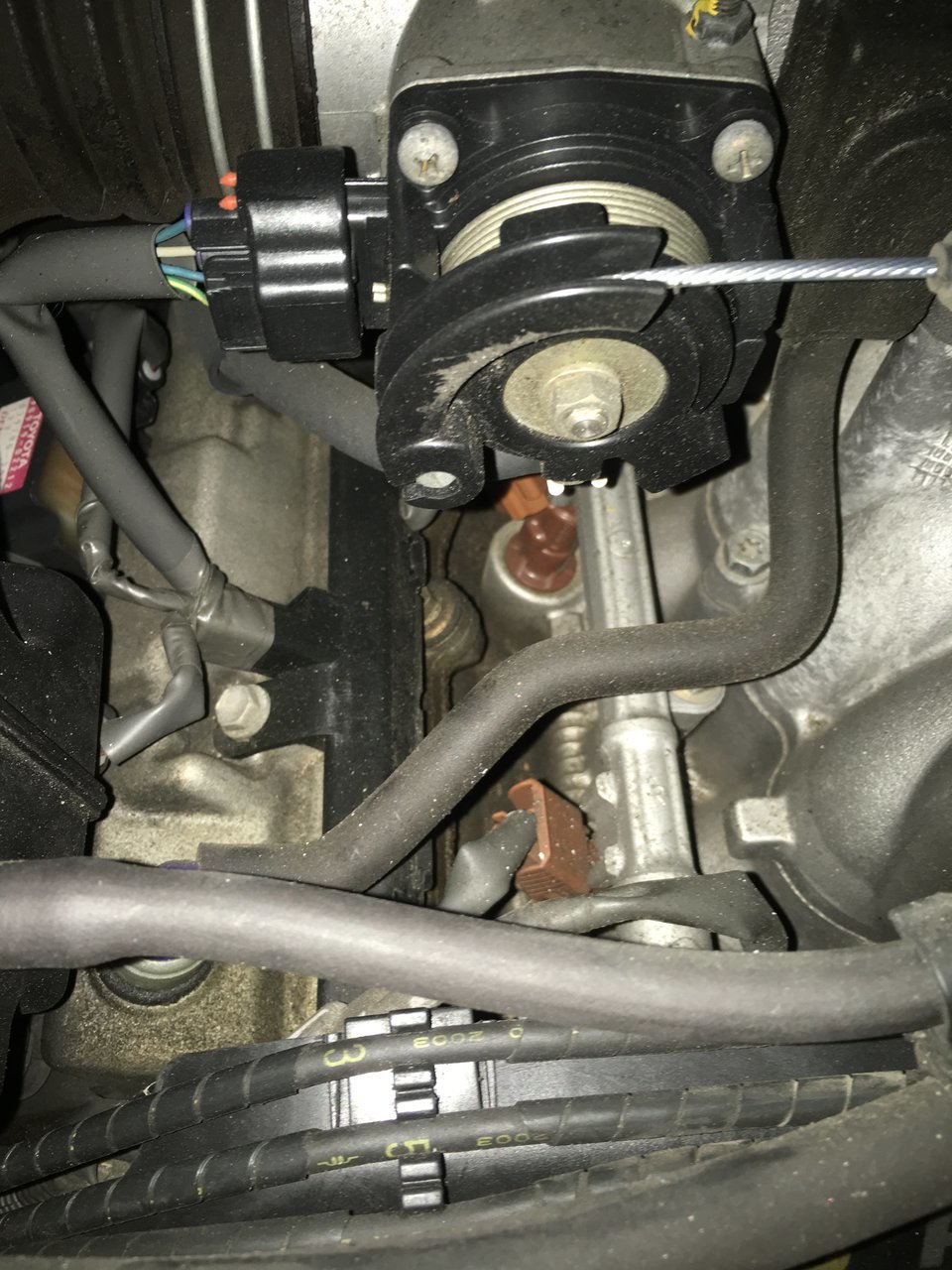

    Well I tried this, it’s hard to tell. There’s all kinds of ticking going on in there. I can definitely feel the injector firing and it does seem to line up with the ticks. BTW there ticking going on at idle and at all times. It stays consistent and syncs up with how much throttle I’m giving it..
    what color are the stock 5VZ-FE injectors? Mine are an brown/orange color.....maybe the previous owner did some fuel mods?.....I’d also like to note that since I first drive this truck I noticed more pep. I got on it today to pass a semi and was really surprised and caught off guard at how much the truck got up and hauled ass. Maybe something’s been done but maybe my old one was a bit tired. I don’t know.

    Here’s a picture of the injectors.

    I thought I replied but I guess I didn't :notsure:
    But those are stock, they look just like my old ones. This engine probably also has less cylinder pressure loss than the other one. I have 183k on my 3.4 and it used to have 145-150 psi per cylinder but I used some "engine restore" stuff and it boosted them all to 190-210. I'm not sure how it affects bearing surfaces, but I have like 6k on the stuff still in the motor and zero noise or issues.

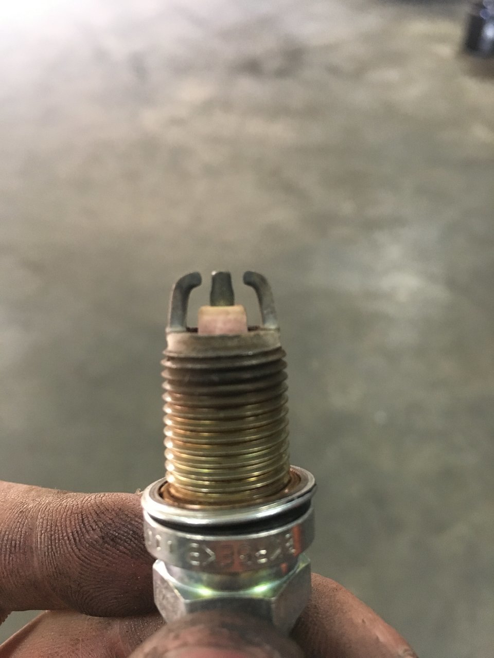

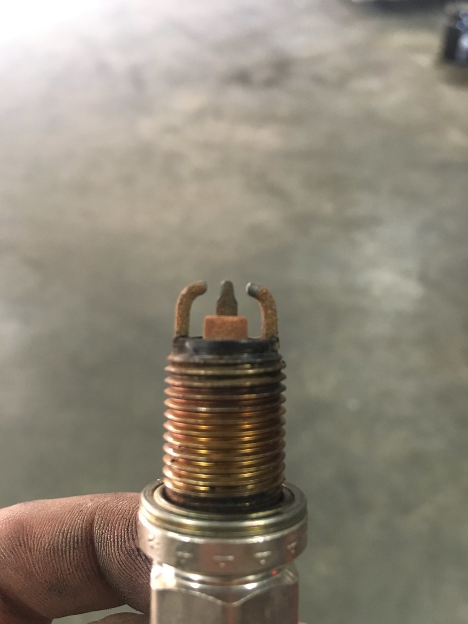

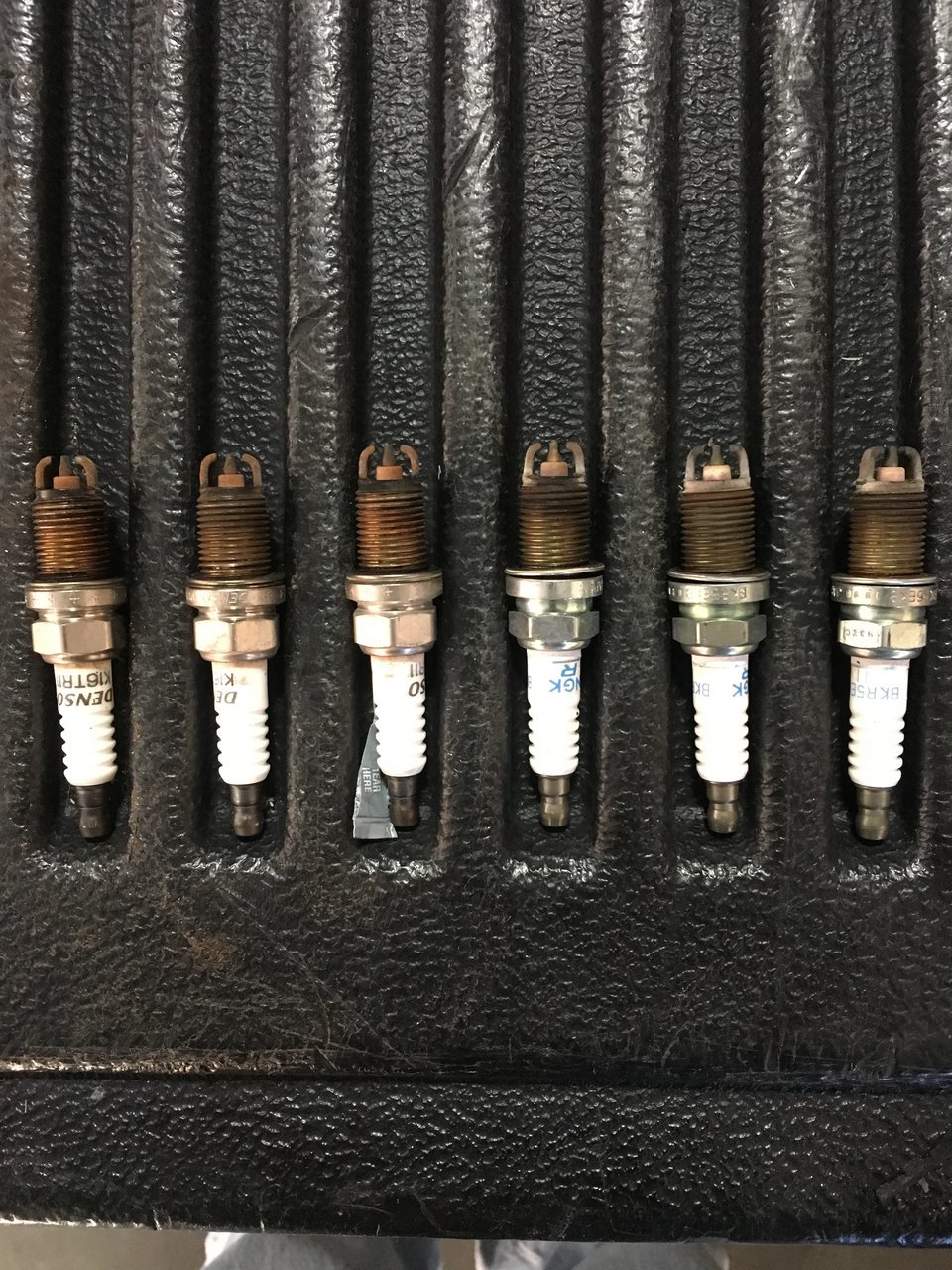

    So I changed my spark plugs today. I’m thinking that for 108000 miles they were never replaced. It still has the Denso in one side and NKG in another. The engine definetly sounds better. I’m not sure if I’m still experiencing the sound I first heard, I’ll have to drive it a bit to find out.72A31211-95A0-42BC-968A-318BBD6DE3BC.jpg
    Densos
    NKGs
