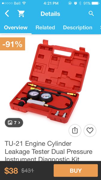

    Ok so far ....... the interweb has told me that i take ALL the plugs out, bring the test cylinder to TDC compression screw in a leak down tester and fill with air PSI (unknown yet). If you hear air from adjacent spark plug hole head gasket or cracked head, air in exhaust exhaust valve, air in intake intake valve, air in oil cap or dipstick rings ..... This is just interweb searching and if its found on the interweb its got to be true !!! just like the "use the vacuum line from brake booster"
    Sooo i think i am going to order a CHEEP leak down tester

    Thoughts ? $38 +14 to ship Us so its like $400 cad
