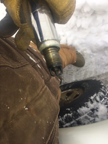

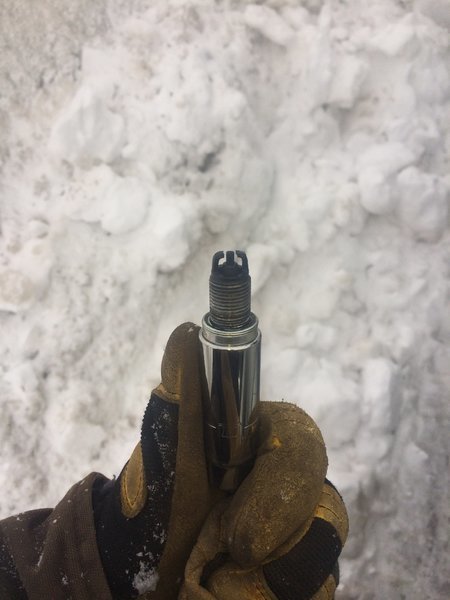

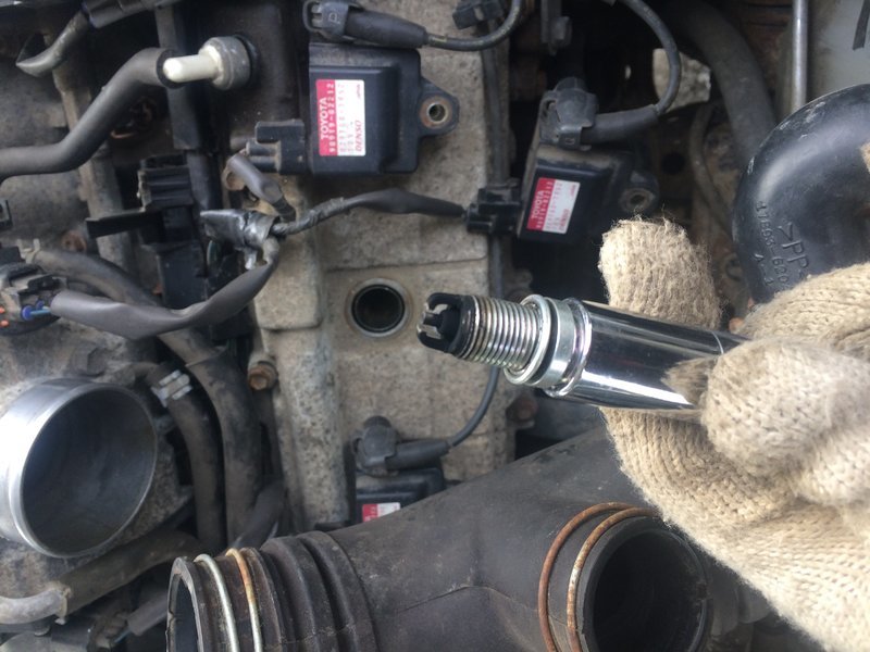

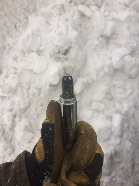

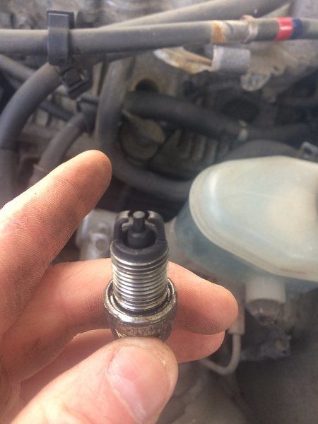

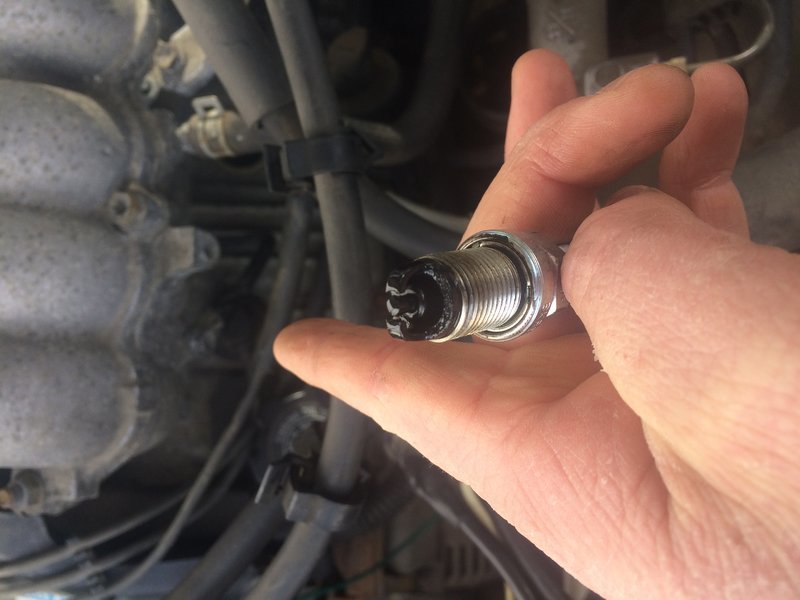

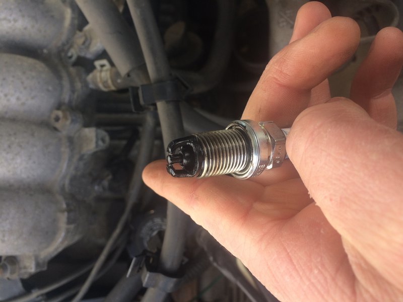

    What #3 looked like BEFORE seafoam
    Also one of the cyl that is missing
    AFTER sea foam sucked in from the brake booster. That I now know was the WRONG vacuume line to use
    I wanted to check the plug before I sucked the sea into the PCV line

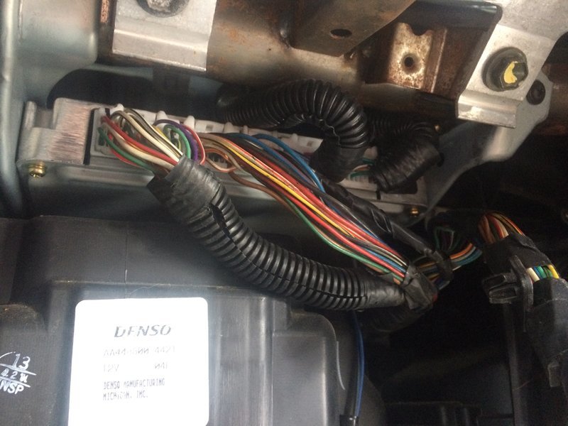

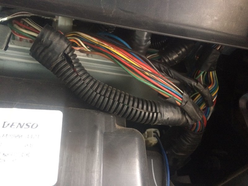

    While the truck was warming up I hauled out the glove box and the plastic liner to look at the wires, someone was in here before (PO) as the plastic shield wire loom has been removed from one of the wires. Everything looked ok no signs of hack wiring IMG_3080.jpgIMG_3083.jpg

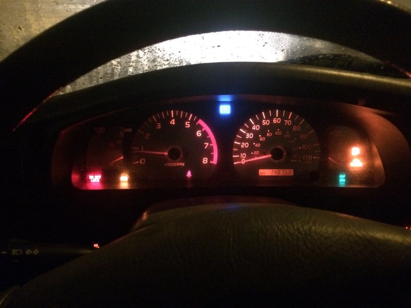

    Still waiting on my leak down tester and the cold and snow to stop. Started the silver lawn ornament and moved it on the street while I cleared away the snow. I think every light was on in the dash. Once the weather is better the injectors are coming out of this for a rebuild. Stay tuned :) IMG_3185.jpg
