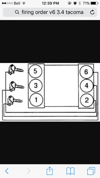

    So 3 and 6 are missing, 2 and 6 were wet and 4 was dry. But the non start was lack of gas :(

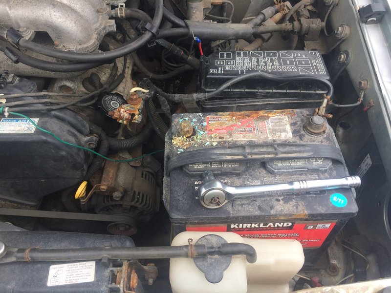

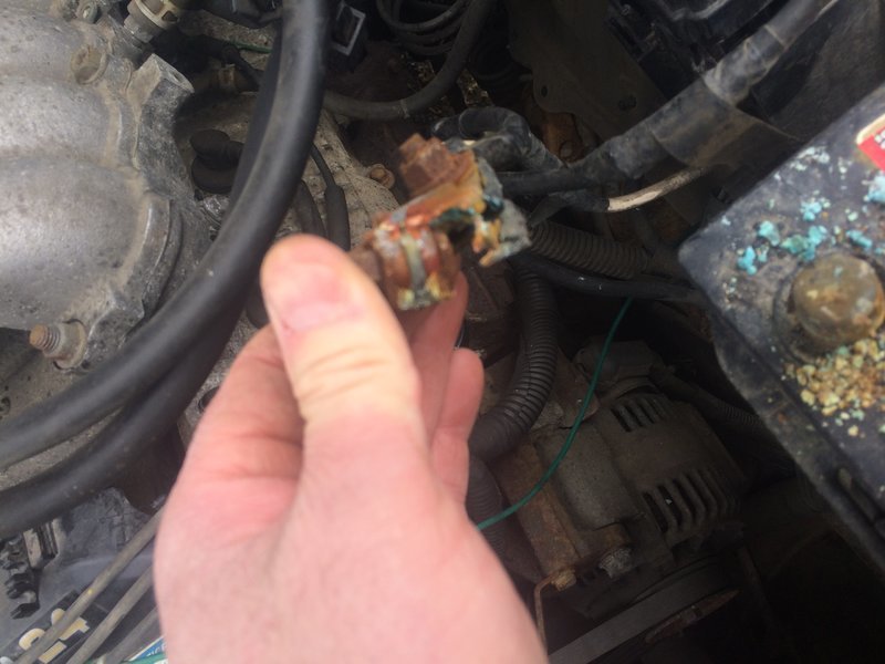

    Just an update if anyone is following.....
    Leakdown tester failed to show up contacted seller and they did a return.
    Started picking at it over the weekend and had to fix and replace the battery cables and give it a good charge. IMG_3393.jpgIMG_3394.jpg

    Yep, look pretty rough.
    On a funny note, I want to the dealer to order those cable clamps, told the parts guy I didnt know the part number. He pulls a box of 10 or so from under the counter where he was standing. He say do you mean these? We keep lots of these on hand, he says. Apparently they go bad pretty often.
